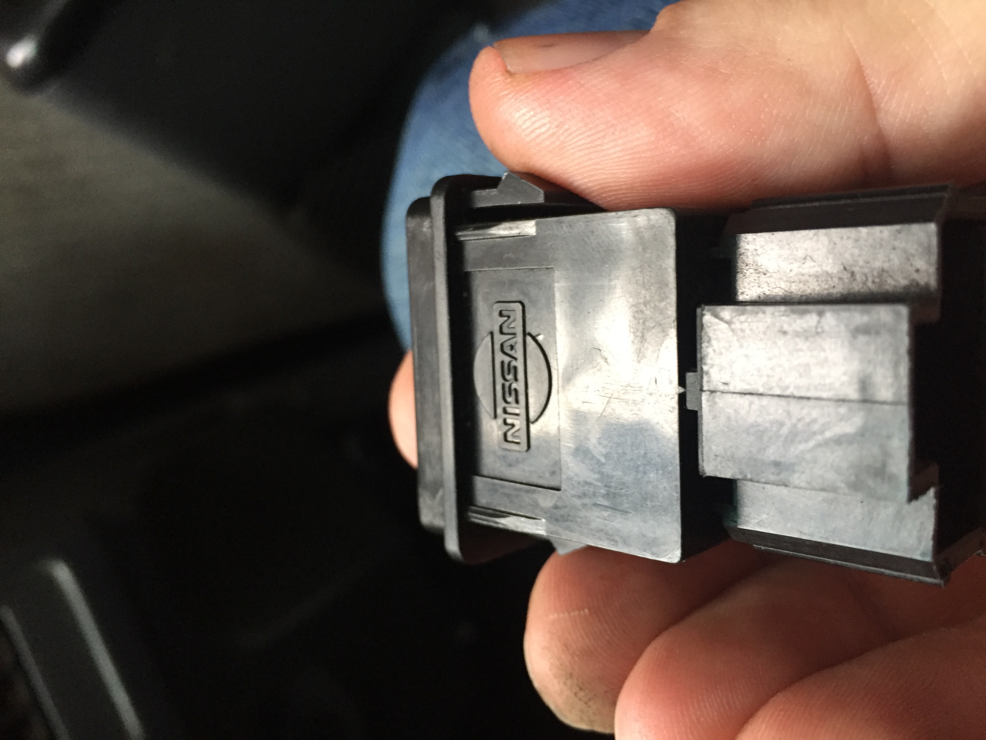

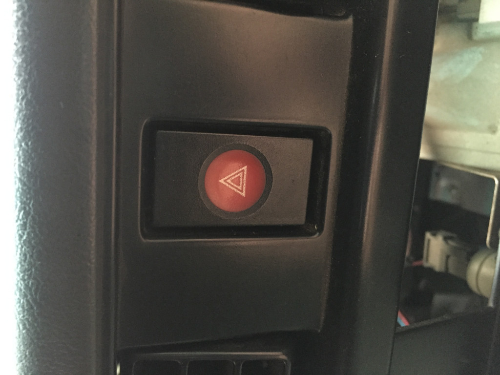

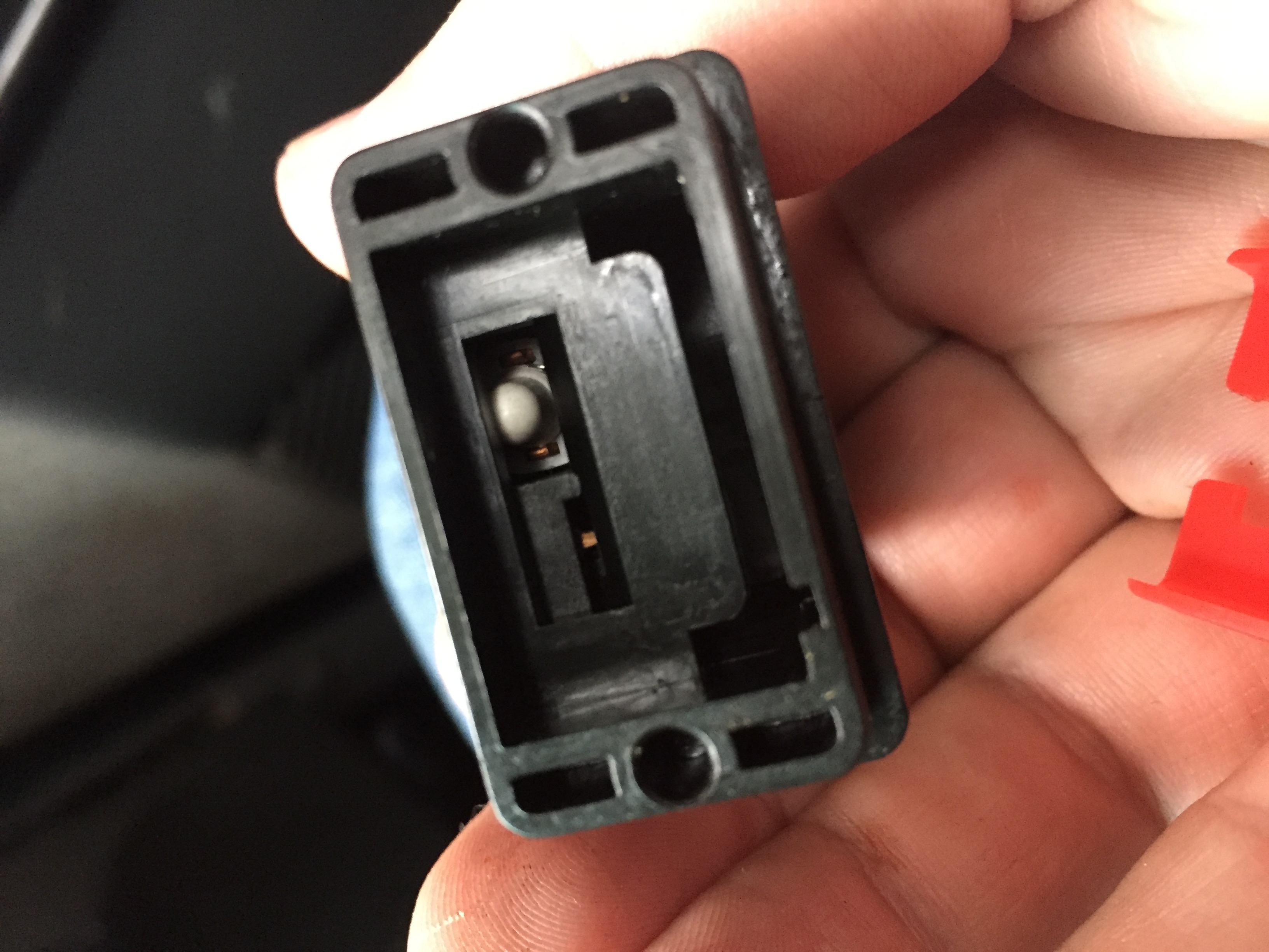

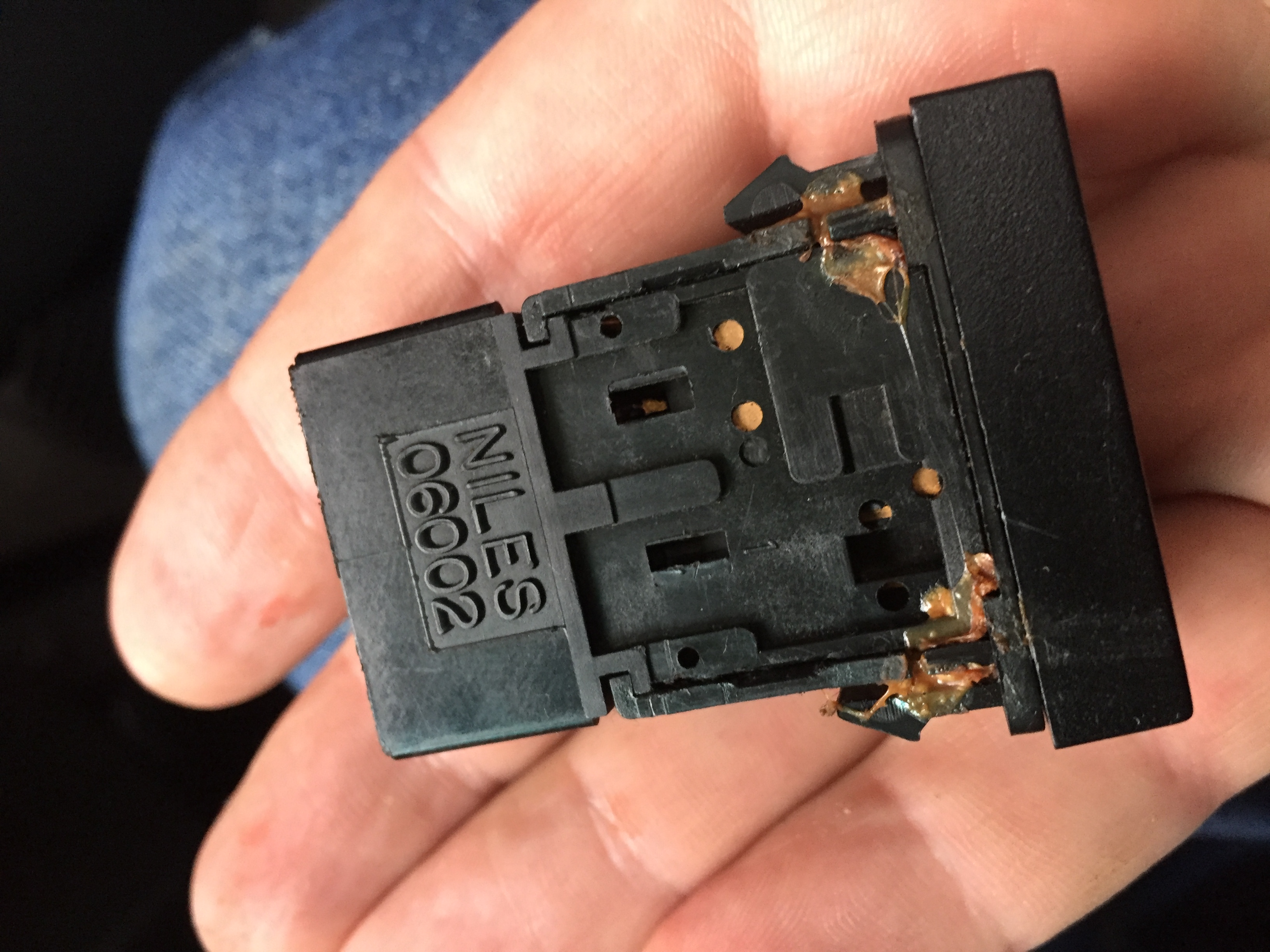

I got similar problem on my gq, although not fuse related.
Hazard switch never worked since i got the vehicle about a year ago. Indicators does work.

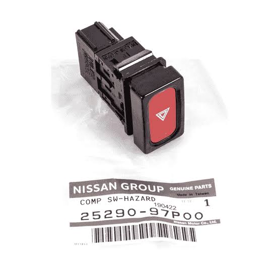

Removed the switch to have a look at it... Found this old invoice in “service file” that original owner kept: Now im wondering if there is not a generic switch available that would fit or must it be a nissan part?
