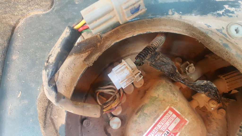

Re: Fuel Warning Light
Just an update on this matter....
To answer clarify things :

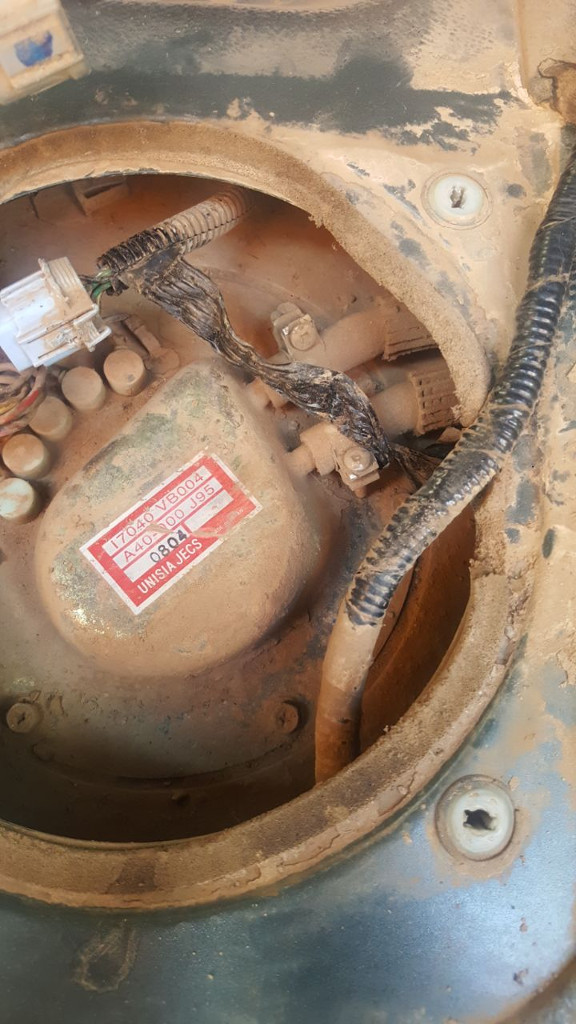

1: Cables are routed from the fuel sender unit on top of the tank (get access to it via the access panel under the carpet in the boot, along a chassis member to the left-hand side of the vehicle. There it joins the other main harness, running along the main chassis bit to the front of the vehicle.
2: In my case, the issue was cowboy electrical repairs by the previous owner. Once I'd opened the access panel, I noted a large chunk of insulation tape peeking out from underneath the split sleeving. Opening the sleeving and removing the tape showed that there was a short between two wires. I assume that when the harness was moved a little bit during the bumper fitment, this put a bit of strain on the previous repair. After driving the short dirt road to Piesangkloof, the shaking must have been the final straw.

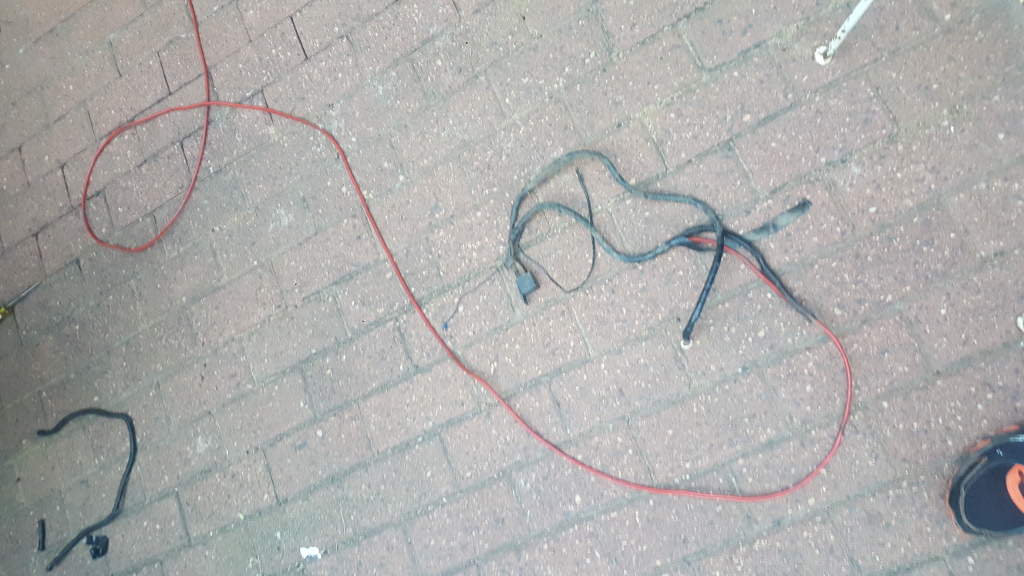

Whilst I was busy, I decided to remove another offensive piece of wiring I've known about for a while and been worried about - seriously, as it is a major fire risk. But I've not got around to turfing it yet.
The previous owner had a relatively thick cable running from an ignition live circuit to the back (presumably to power a trailer / something). I'd determined it to be there quite a while ago - properly insulated it and taped it to the chassis with the idea to trace the cable at some point. Upon opening the hatch for the fuel sender, I gathered that the cable was routed through the hatch, underneath the carpet, along the door frames and into the engine bay. I later traced the relay, and managed to get rid of everything. Very happy with that, as I've been super worried about it for months...

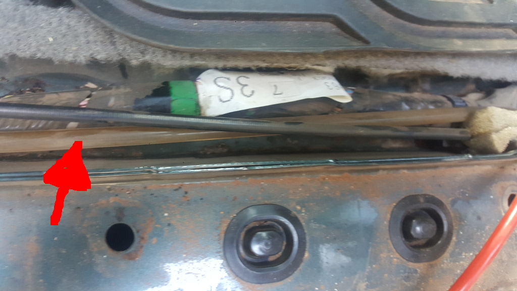

That is all gone now. On a side note, whilst tracing the wiring, I also noticed that the vacuum pipe for the diff-lock runs underneath the door beading on the driver's side (highlighted in red in this photo). Just thought I'd post it here in case someone was interested in the routing of that pipe one day...
Well spotted on the difflock hose/pipe !!! :thumbup: :thumbup:
