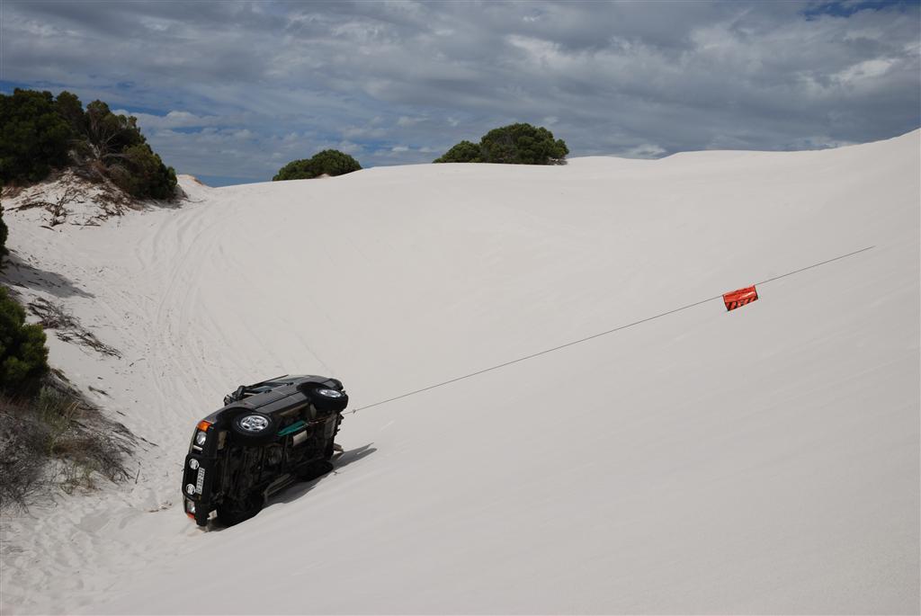

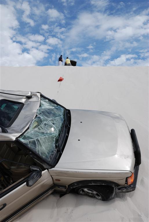

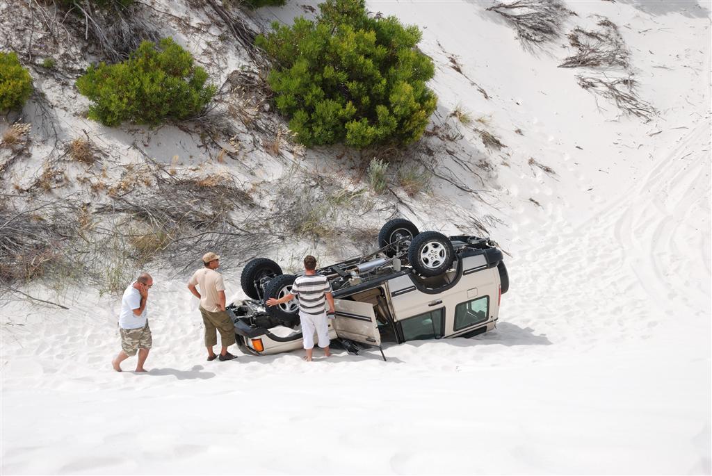

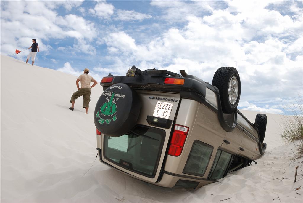

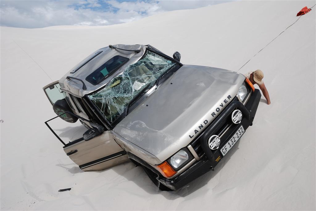

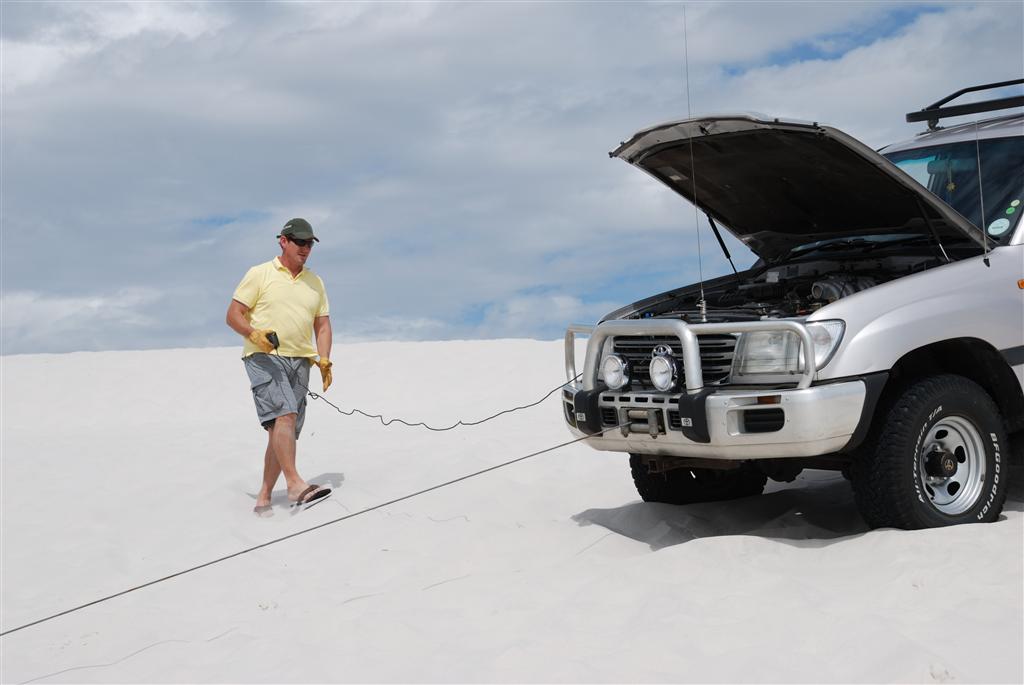

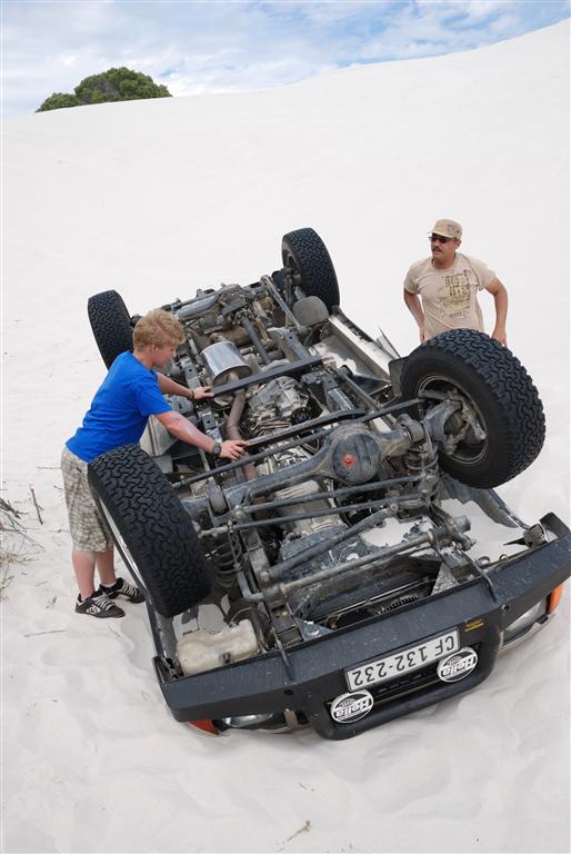

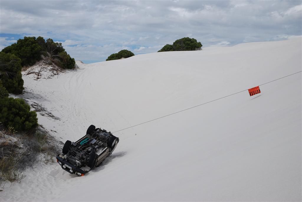

This is not the first time we've experienced this!
JD had a call on Sat. afternoon from one of his reps husband to assist in the dunes. He was there with a bunch of friends - they were having his bachelors party in the dunes. Apparently had nothing to drink yet.
I hopped in with JD (we're just about neighbours). We picked up the pilot at gate 1 and he took us on a few detours through the dunes - until we finally found the right spot.
What apparently happened was that the driver and three other friends went for a drive. Now this 'obstacle' can be done a number of ways, but more commonly, if you look at the third foto, you drive from top centre (steep), straight down to where the LR lies and then right around the bush and out.
BUT, these guys, as they were going down they turned left along the slip face (to the right of the photo), eventually lost the initial momentum and grip (very soft) and rolled.
There were fortunately no injuries.
Recovery: JD then parked to the right above the slope and using a chain through from front and back recovery points winched the vehicle back on its wheels. The LR was then winched from the front to level ground. We unfortunately had to leave then (Theuns and Johanita show) and apparently later another Cruiser, towed him to the gate where the tow-away service was waiting.
