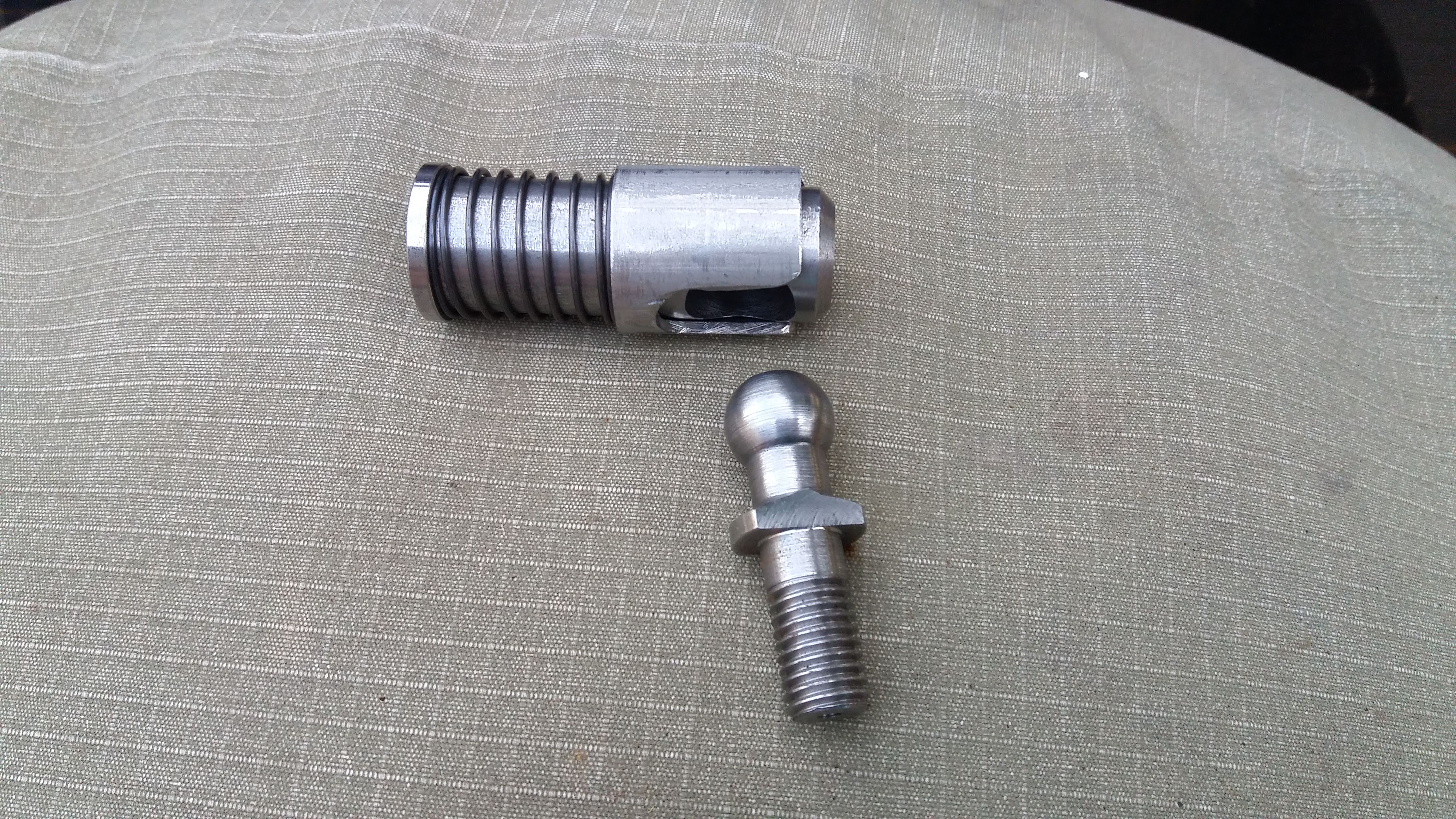

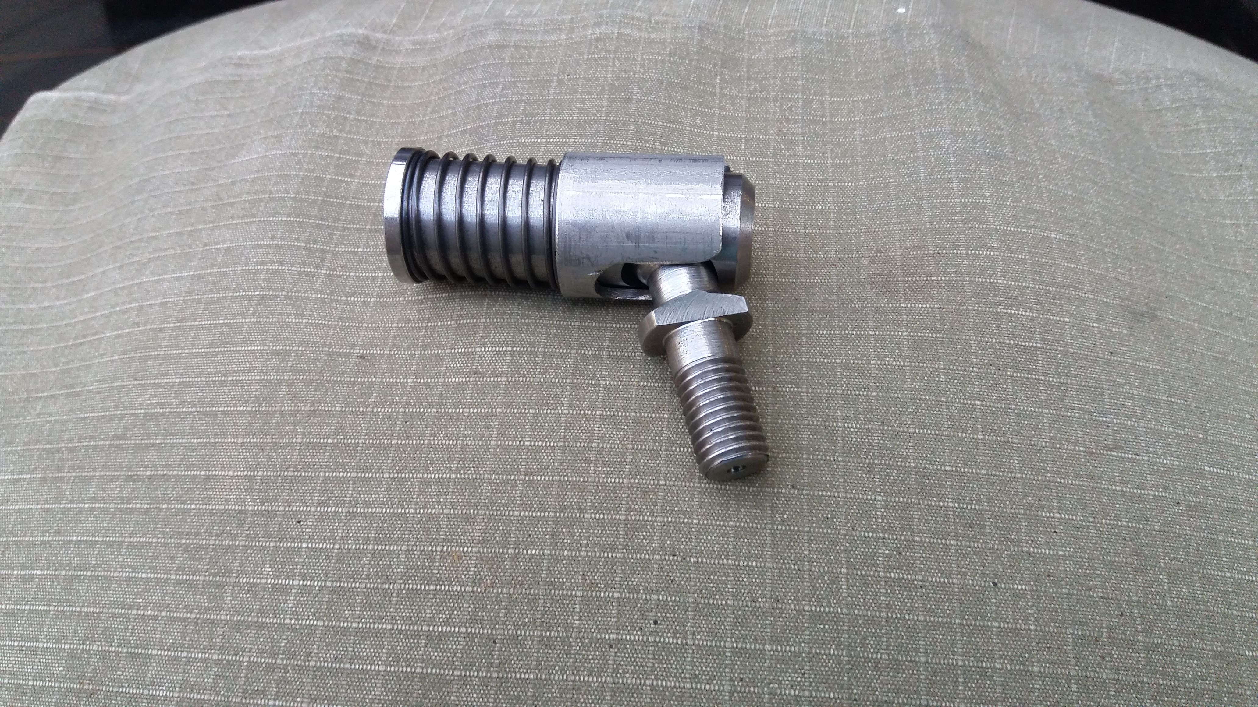

I have revised the design of the QD system by designing a quick-release ball joint:
To disconnect, slide the collar upwards and move the female joint away: Reconnecting is simply the reverse.
These can be used both front and rear, and come in M12 (for the GU) and M10 (for the GQ). The existing top bushes are retained and the QD joint is joined to the chassis by a threaded bar, so it is easy to taylor to any lift.
For the front, and assuming basically standard suspension concept is retained, I believe one can get away with just disconnecting one end. A kit consisting of one disconnect and one longer fixed link will cost R1900
If the suspension is not lifted, i could leave the one end standard and just replace the other side at R1500.
If the front suspension has Superflex arms, X-link or 5-link conversion, you would have to disconnect both sides, in which case the kit will cost R2400.
For the rear, I think one would need to disconnect both ends. For GQ's, a kit will be R2400, for GU's R2750.
I have a few joint available if anybody wants.
