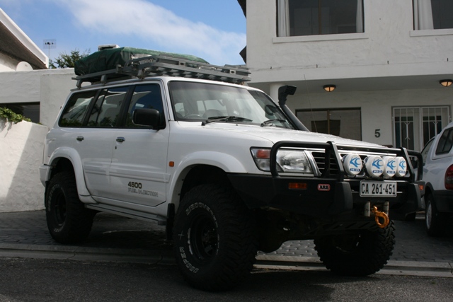

I have a stock standard 2001 4.5 GRX Patrol. I am thinking of raising the beast by approx 4 inches and add 285/75 tyres – should get total about 5 inches I recon. A mate of mine has the Iron Man 4 inch kit and it looks impressive.
I tow a really heavy boat to Ponta and back a few times a year and I feel that I need to add some support and height, especially at the back end.
I believe there should be a wealth of knowledge and experience out there onthese matters as I see many Patrols around that have similar mods. Can anyone therefore provide me with do’s, dont’s, pitfalls, advice etc. Some of te things I am concerned about is the change of the angle of the propshaft, there are additional stresses due this, and the fact that I tow heavy may exacerbate this. Are the 75 tyres good for the beast? How are the caster issues sorted? What are best shocks to use. I am also weary of inflatable inserts if used on the open road as it is sure to change the damping dynamics of the suspension (someone I know got into serious oscillation and nearly flipped his cruiser while he had his inflated. I recon they are OK at low speed ie on the sandy dirt roads to Ponta.
So guys, any comments welcome – and lets see what comes of this.
Pic attached.

I will go for the "standard" OME 2" suspension but put the heavy duty shock at the back. With that I will put the Firestone Airspring system - this does not replace the coils but is airbags that go inside the coils - it is only to help level the car out once you have loaded it. It is a tremendous advantage - I also tow a boat (although not as big as yours!!) as well as quads on a trailor and a off road trailor when we go overlanding. It is amazing how much those airsprings assist you in levelling out your vehcile again!!! And not only that - the road holding and stability even under normal driving conditions is amazing!!!
I have the 2" ome suspension and airsprings - and I really can't complain. See pic's attached.
The tyres (285/75/16) will not give you problems - not even on casters I think. I went up to 305/70/16 tyres now - and only now I had to have my caster corrections done. I however had the 265/75/16 (I assume this is what you have on now) on before - but you are merely going to go from (if it is 265/75/16) a 198.75 wall size and 803.9 diameter to 213.75 wall size and 833.9 diameter size (with a 285/75/16). I don't think with those kinds of figures you will have to do casters at all.
Here are some pics for reference for you:
This is my car with the 265/75/16 tyres and the OME 2" suspension lift on it - also still fairly new about 4months old. So what I am saying is that the suspension has settled in already. No airsprings yet.
Here is a photo of the airsprings in the coils:
Here is photos of the car with 265/75/16 tyres with the airsprings pumped at only 0.4 bar!!!
Remember the airsprings is only at the rear. The car does actually raise as well with the airsprings pumped - I have taken measurements already but can't remember now from the top of my head what it came to but it is quite significant. The ride is also a lot more stable and firmer. You can pump the airsprings up to 2.4 bar!!!
Believe me then he rides as hard as an oxwagon
Here is my car with the 305/70/16 on, airsprings also only at 0.4 bar!!!
Looks nice hey!!!
Hope this helps to make your decsicion making process a little bit easier!!
Looks nice hey!!!
