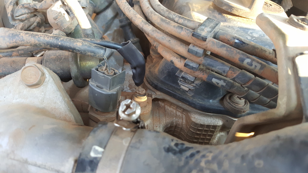

Step 3 : Removed engine cover, in order to find the temperature sensor (I recalled it being near the thermostat at the front of the motor from the manual). Upon removing the engine it was immediately obvious that the sensor wire had broken off from the connector.
Broken Connector
Broken Connector

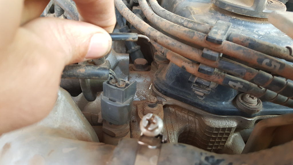

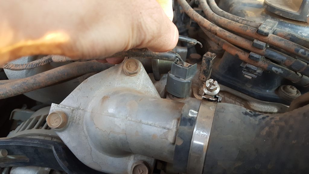

After removing the plug. I gathered it was a generic, single tab piece, and a generic crimp-type clamp would fit. I managed to get one from another guy who was on the trip (I normally have with me, but had recently lent all my connectors out to a friend whose vehicle died). The red one fit perfectly...
Connector on Sensor
Connector on Sensor

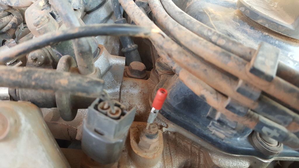

Red Clamp
Red Clamp
A quick strip of the cable, crimp of the clamp and a bit of heatshrink later, all was good and rocking. Quick and dirty bush repair. :rolling: :rolling:
