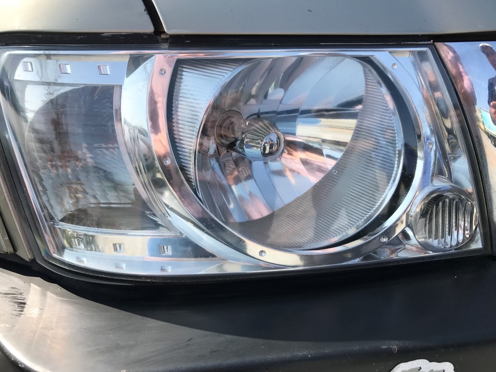

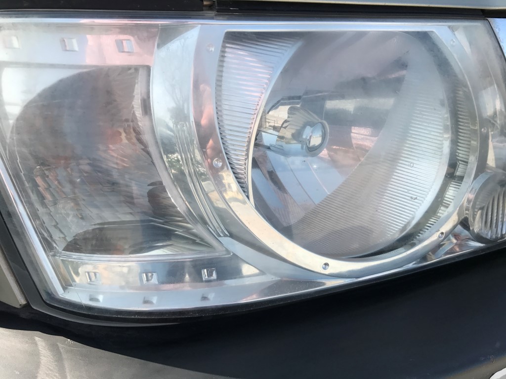

Wasn't quite sure where to post this, but reading the LED headlight posts with great interest, I had a close look at my headlight lenses and found they had a brownish tinge and were quite pitted, probably from gravel chips and sand. Later that day I googled replacement headlights and was shocked to see the prices of the 'genuine' replacements.
Then, you won't believe the next day after picking up my daughter from school I stopped at a takeaway pizza spot and out pops this guys who walks straight up to me with a big smile and I entertain him while my daughter orders. "Meneer Patrol", he says to me and starts his marketing pitch. His commitment is to make my lenses as good as new while I wait for my pizza and if I'm not happy, my money back R150/light :think: So was this a scam or not?

Looking at the before and after picture I would say it has worked.
I would say you can definitely improve the appearance / remove the dullness of the headlight, by means of 'sanding and polishing).,
I bought a headlight restoring set which consisted of some 2000 grid water paper , a small polishing disc and some polishing compound. this cost about 450 R which is quiet pricey. I would say if you buy the components separately you might get away with less then halve the price. Irrespective , I treated the headlights as prescribed i.e. sanding and thereafter polishing and I would say that the appearance improved significantly similarly to what you show in your before and after pictures. :salute:

Worth the R150 John! I have used toothpaste, brasso, polishing compound etc over the years, and although they all work, my elbows and fingers did not like the abuse :lol:

That looks pretty damn good JohnBoy !!

Glad you agree I didn't waste my money :think: :thumbup: Now to get the LEDs...
