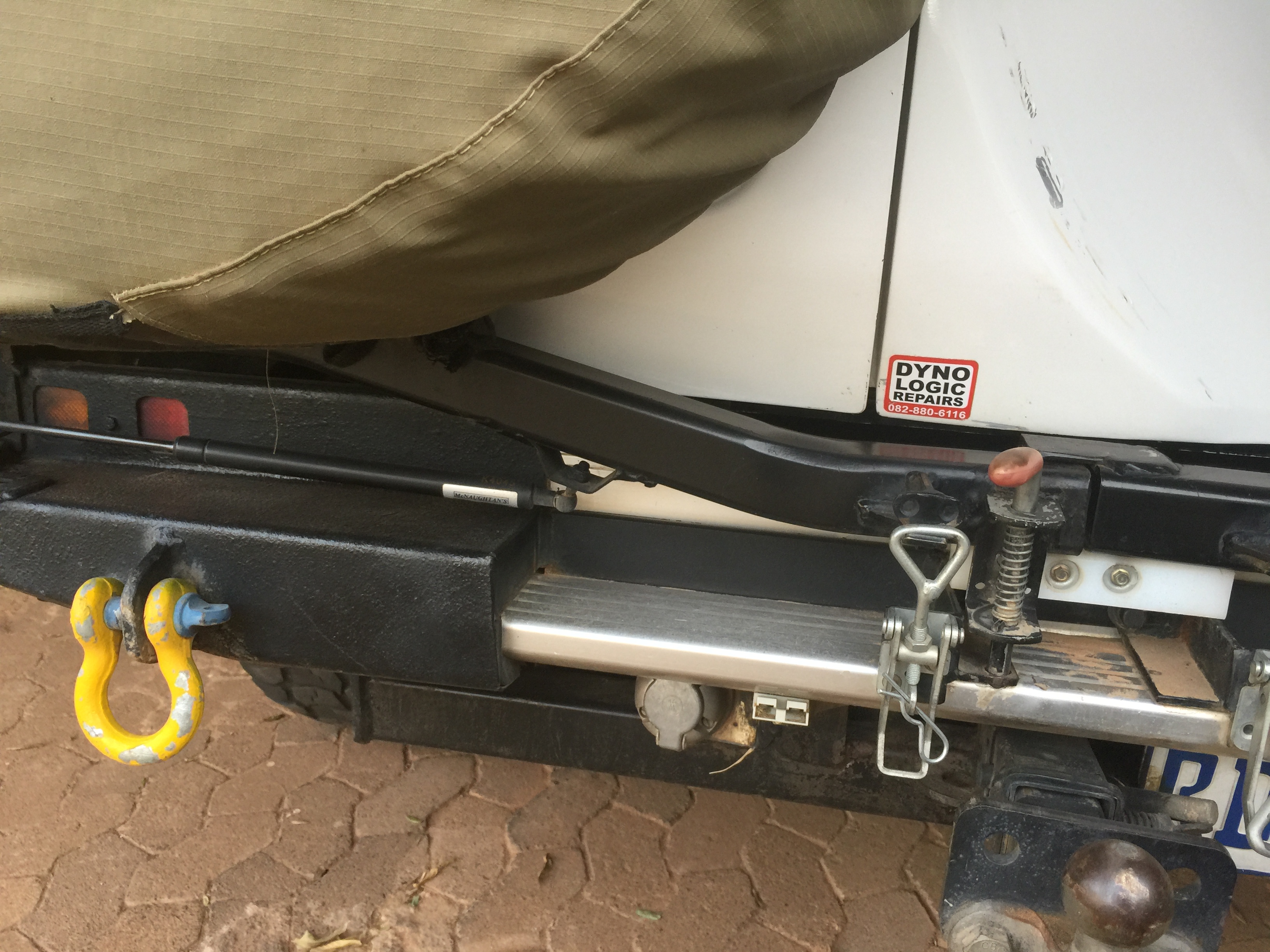

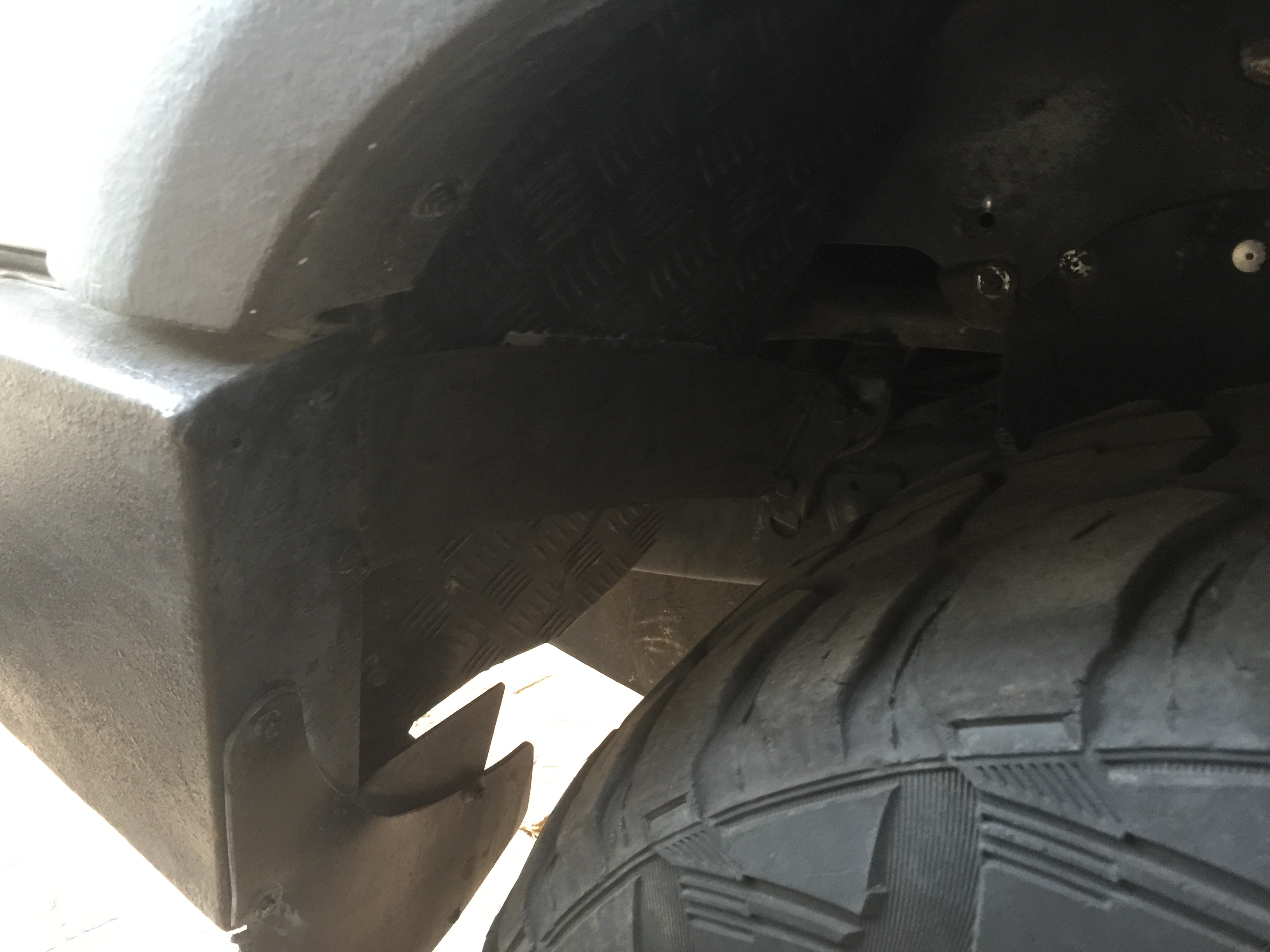

Carel
Mine was not strong enough
So I ended up having the corners connected with a piece of steel that runs just above the aluminium section in the centre rear (see first picture), and then also had it strengthened with a thick piece of steel running inside the wheel arch and welded to the chassis (second picture).
This is now strong enough to my satisfaction to carry spare wheel on a swing arm etc.
But in hindsight not worth the trouble. If I was to donit again, I would just replace with a bona fide rear bumber and get it over with.

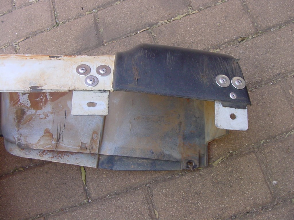

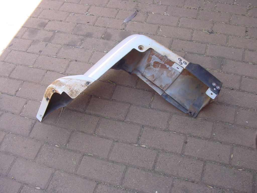

Baie dankie aan almal. My idee was om net die plastiese deel te vervang met so dun as moontlik staal, maar daar sal lang sweislasse nodig wees wat die dunner staal sal laat skeef trek.
Ek wou die bestaande bracket hou
en ook die rubber vashegting
Ek het nou stainless steel brackets in die plek van flimsy plastic brackets vasgesit en sal so ry tot ek besluit om agterbuffer geheel te vervang
