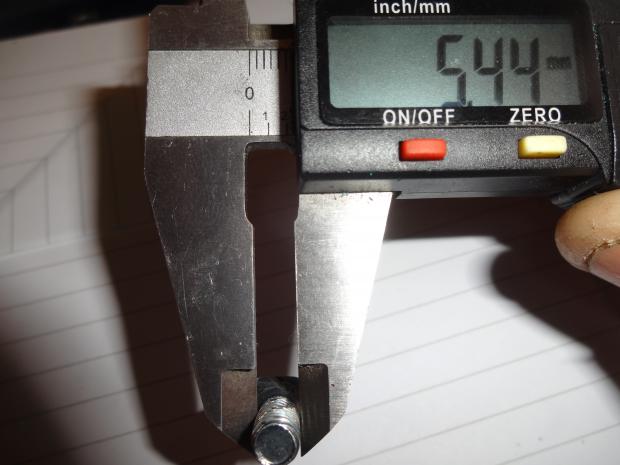

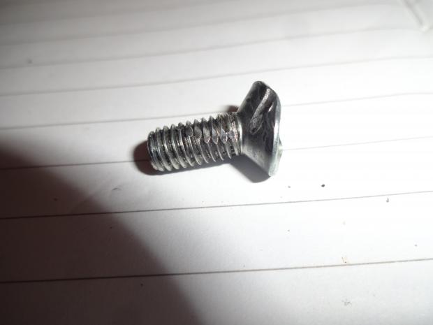

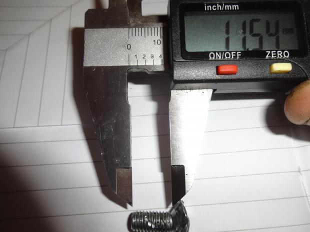

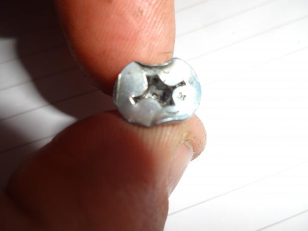

So, my dramas started recently,i went to do my routine service and as i was doing it i sheered my lower sump pan stud (no problem right?) we just take down the lower sump and get the thing rethreaded and this is what i done,but as i had it off i found a phillips head small screw sitting in the lower sump :doh:
Ok, so after a lot of research on the other Patrol forum and asking around who i thought may know i narrowed it down to it been from my Oil pump,as far as i know there are over a dozen of these small scrwes holding it in place, Not only that,my oil pick up pipe had broke it's bracket too in the uppersump.

I don't know these engines at all. Does the pickup only have the one bracket?
Having said that, as part of my job I probably have more experience with o-rings than most, and I guess it would probably be fine as the pickup is not a heavy part, and it's not really subjected to any forces other than vibration
But, like you, I would be nervous about it. And therefore, I would recommend taking the lower sump off again, cleaning the pickup tube and bracket, and then applying a liberal dose of Pratley's steel putty.
While this stuff doesn't last well in petrol, it does seem to be surprisingly resistant to oil. I have repaired a stone-bashed aluminium sump with it, and a friend repaireed a cracked engine-block with it a long time ago. That particular crack was on one of the primary oil passages directly after the pump on a golf engine (thus subject to high oil pressure) and the repair lasted a couple of years.

My ZD30 lost 2 of those screws - one ended up in the timing chain, which caused it to snap and ended up rebuilding the motor...
Be careful...

My thoughts...pull that motor and fix it by dropping sump and timing cover ..its not so costly maybe a weekend and a box of ale's than waiting for the big bang :mytwocents: :mytwocents:
