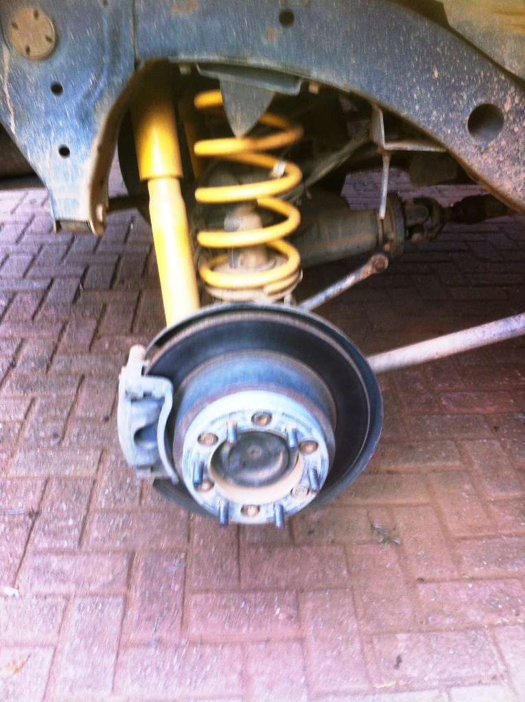

So, while my car was lifted on all fours over the weekend, I noticed that my rear suspension "drops" more on the right side (by more than a little bit). After a (quick) investigation, I found the reason being the right side stabilizer rod being uncoupled.
Now my first thought was to have it fixed, but then.. it has probably been that way for a little over 200 km and I haven't noticed any issues while driving. So the next thought... why not remove it entirely on both sides? (It gives me just that extra little flex.
Has anyone else tried this? What is your experience?

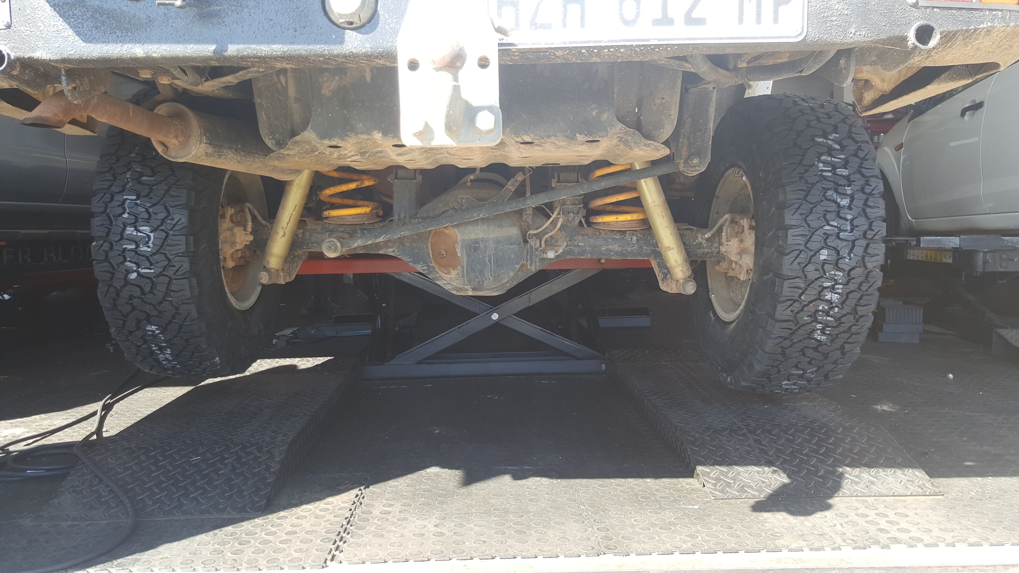

Mine snapped on the right side, I then disconnected the left hand side.
Been driving without it for a while now. (also removed the front sway bar)...

Thanks gentlemen. This is what I needed to hear.
My wife tells me I drive like a grandpa on tar, but a hooligan on gravel, so I suggest this is the way to go.
