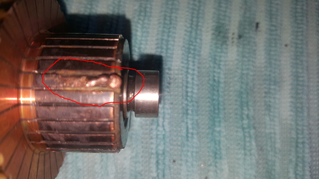

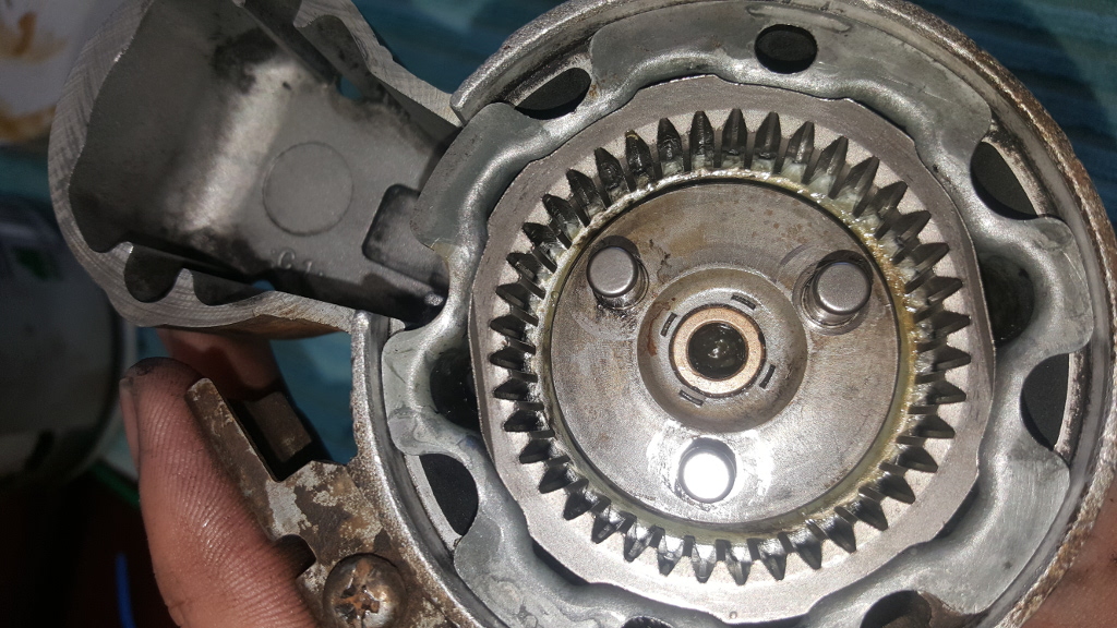

After stripping the starter, the reasons for issues became apparent. It would appear that the starter had been (very poorly) reconned in the past, and the previous moron had greased the armature. This resulted in a thick, conductive paste being present throughout the area around the brushes - where the grease had combined with carbon from the brushes. Also, the grease in the planetary gears was incredibly old and horrible. A further burn was present on one of the commutators, which was probably where the starter was shorting on every attempted start. My assumption is that the dead short when attempting to start was what was eating the batteries.
I've got the truck running reliably now whilst I wait for my new starter motor (a Mitsubishi one - which is a 9th of the price of a Nissan one). This is a quick overview of what I did, and how things fit together.

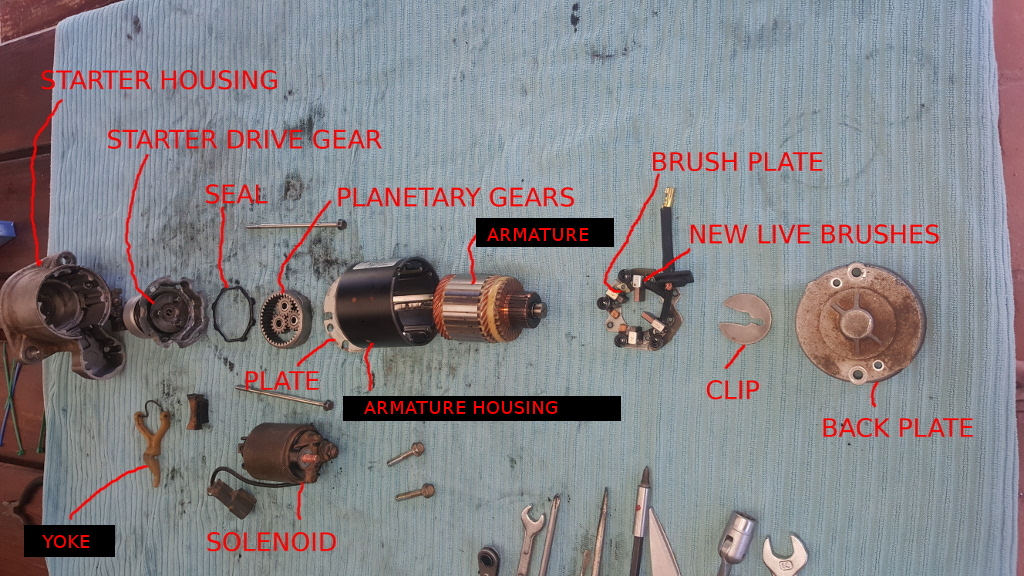

Disassembly
NB: When removing the starter from the vehicle, please remember to disconnect the battery...
1: Disconnect the battery, remove the starter (spanners required: 10 for battery terminals. 12 for battery to solenoid connection. 14 for the two bolts attaching the starter to the motor).
2: Disconnect solenoid -> starter connector (12 spanner). Unclip the solenoid connection on the outside of the starter. Remove the solenoid from the starter (10 spanner).
3: Remove the back plate of the starter. (8 spanner).
4: Remove the two screws holding the brush-plate to the starter (phillips screw driver).
5: Remove the back cover.
6: Use a screwdriver to remove the clip on the end of the armature shaft, then remove the brush plate.
7: Remove the armature housing (the armature will come out with it). And then pull the armature out of the housing
8: Remove the plate covering the planetary gears, and lever out the planetary hears. Make sure the small black seal is remove without damage.
9: Remove the yoke from the top of the starter drive.
10: Remove the starter driver assembly.

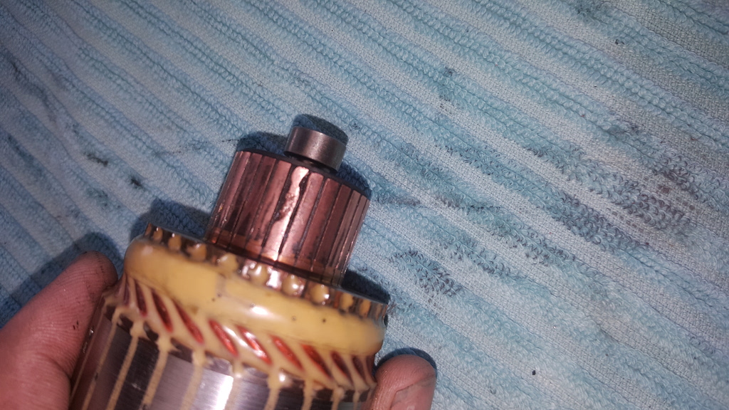

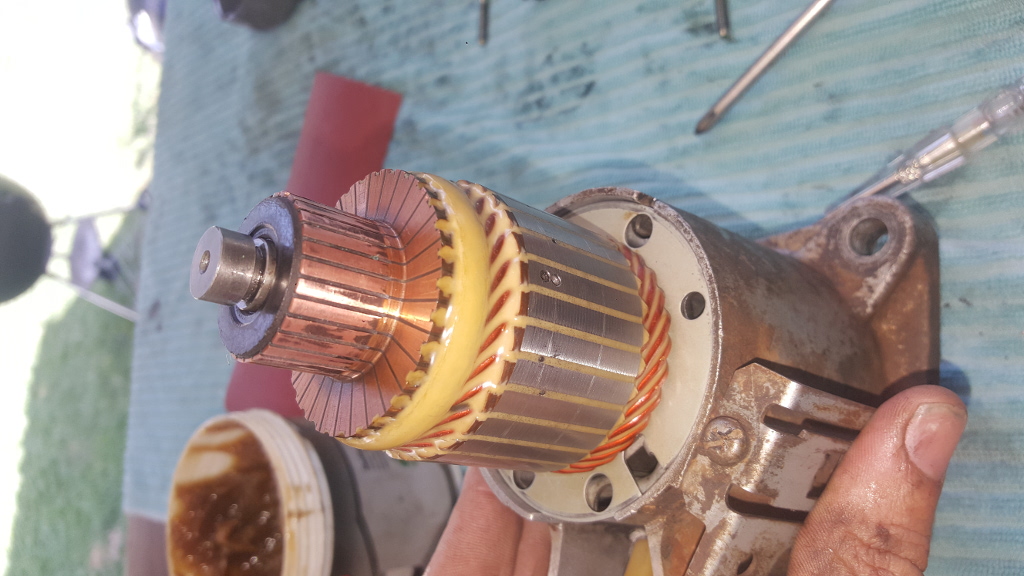

Check all items in the starter. What I noticed was that one commutator was pretty badly burned.
I used my Lansky knife sharpening files to remove the "ball" of copper on the commutator, and clean the rest of the commutators...
I also cleaned the gunk from between the various commutators.

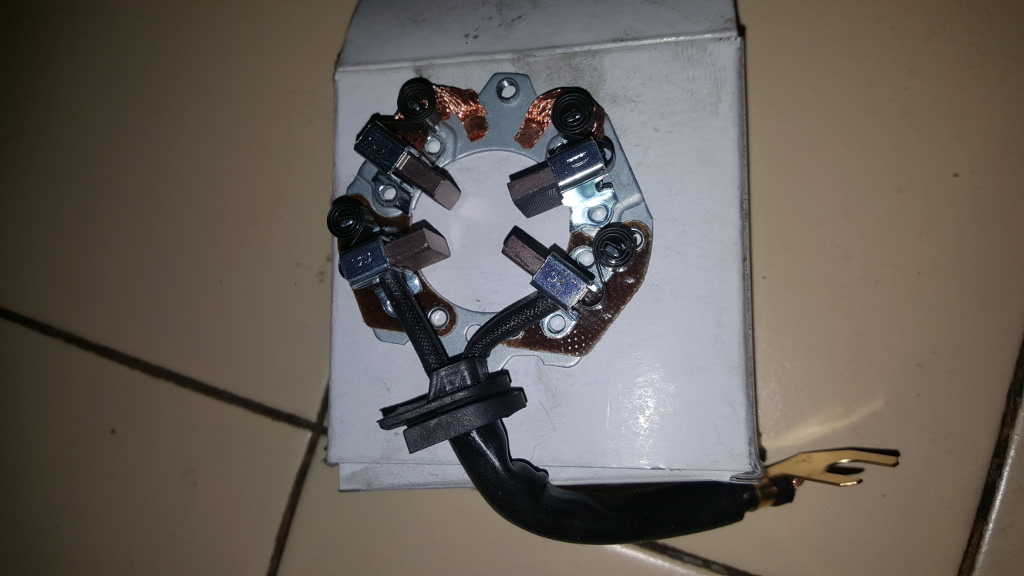

Further inspection showed that the brushes (especially the positive brushes) were very badly worn. I tracked down a set of brushes at a local spares place. Since it was a long weekend, and no auto electricians were open, I could only replace the positive brushes as I do not trust my soldering for such a high-current application. I assumed it would work, as the earth brushes were still relatively long... (side note: it works...)

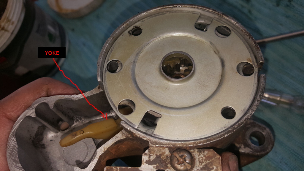

2: Place starter yoke into the solenoid opening, and make sure the wire ring engages onto the "circle" on the starter driver shaft. The "bump" of the yoke should point forwards.
3: Insert drive shaft into bush at the end. Make sure the yoke is properly engaged (pushing the yoke forward should move the starter pinion backward. Pulling it back should move it forwards).

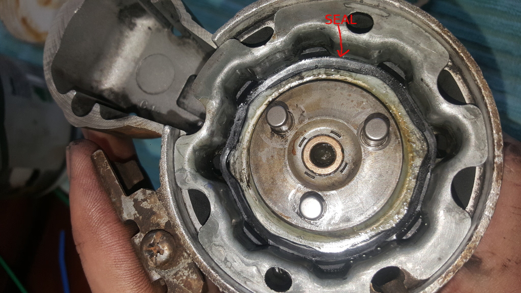

4: Insert the seal between the planetary gears and the starter driver. The round bit should face forward. Take care to align it properly with the little cut-outs on the sides.

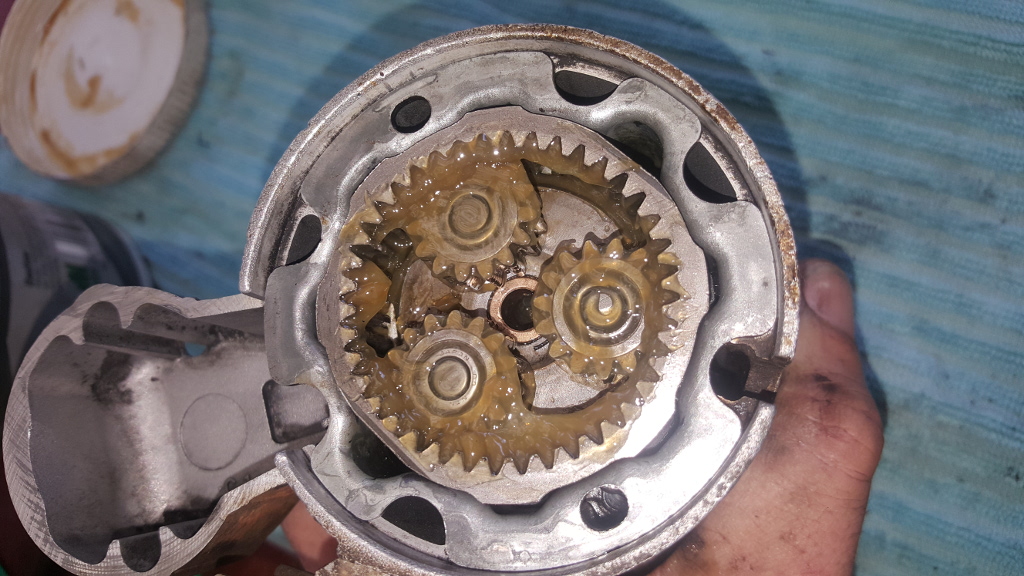

5: Insert the ring gear for the planetary gear (round side in front). Once again, check the alignment. The little nubbles on the ring should fit into the recesses.
6: Add the rest of the planetaries, and grease.
If you'd been paying attention, you would have noticed that I forgot to put the yoke in first when I took these photographs... This is corrected in the next step. :rolling: :rolling: :rolling:
7: Put the plate on top of the planetary gears. The large protruding centre ring should interface with the ring gear. The small protruding centre ring should face backwards (towards the armature). The smaller holes on the sides are where the bolts go through.
8: Insert the armature.

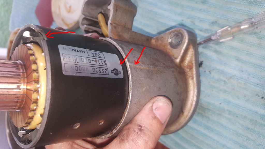

9: Put on the armature housing. There are alignment marks on the housing which will allow you to put it on with the correct orientation.

A final update on this.
Having some time on the weekend, I stopped by an autoelectrician here in Brits to see whether they could solder on the new negative brushes on the brush plate. They said they don't, as they generally just replace the entire brush plate.
The brush plate part number is 2114-73105. And you will find similar brush plates in a very wide range of Nissans, Opel Corsas, Mitsubishis etc.
It also costs the princely sum of R137 including VAT... :rolling: :rolling:

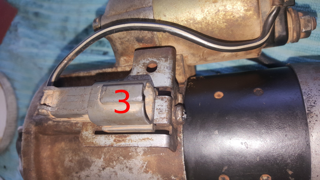

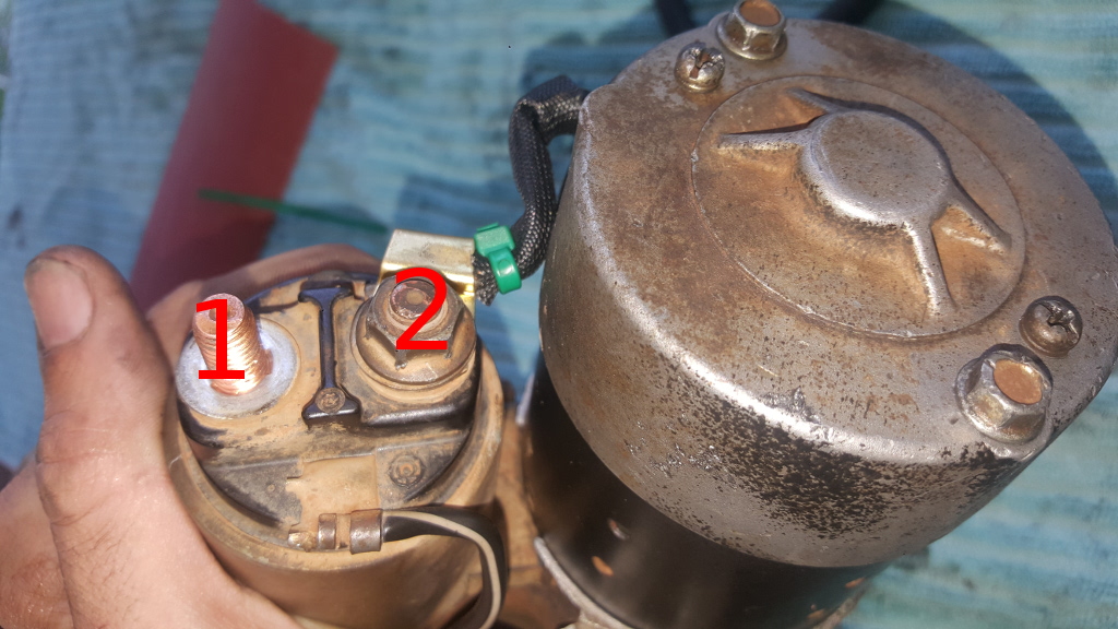

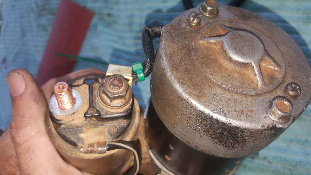

Sorry to hear this Fanus. There could be several reasons for this.
1: Loose wire on starter (I've had this before).
2: Bad brushes in starter (as per this thread).
3: Bad solenoid (the solenoid bridges the two connectors at it's one end, which in turn provide power to the starter motor).
Relatively easy to test everything. Start by disconnecting the battery and removing the starter.
To test the starter motor.
1: Attach a jumper cable to negative on the battery, and earth on the starter motor (ie: the body).
2: Attach a jumper cable to positive on the battery, and the terminal labelled "2" in the attached image.
3: The motor should spin. If not, there are bad brushes, or bad armature.
To test the solenoid.
2: Attach a jumper cable to positive on the battery, and the terminal labelled "1" in the attached image.
3: Use a smaller cable. Attach one end to positive on the battery. Touch the other end to the center pin of the connector labelled "3" in the attached image.
4: The solenoid should engage. At this point, the yoke should force the starting pinion forward, and the starter motor should turn. If not, the issue is the solenoid.
Hope it helps. Let us know what the end result is.
