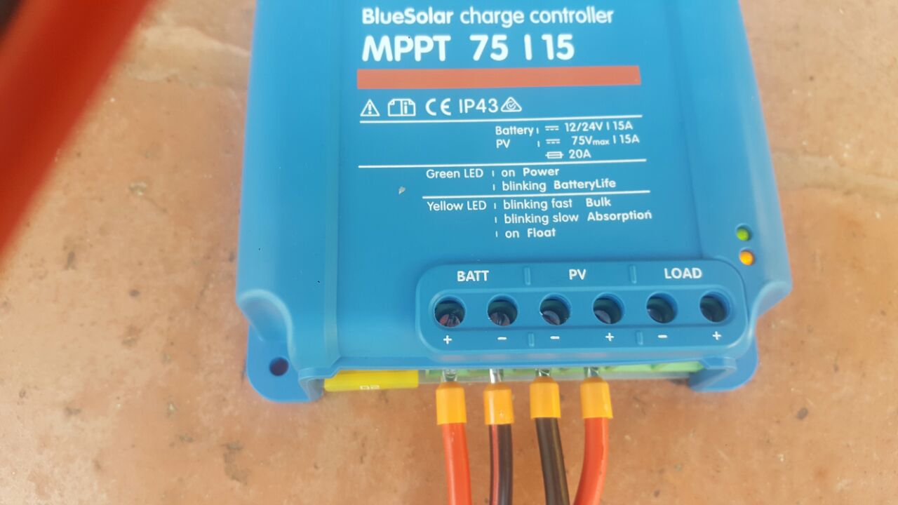

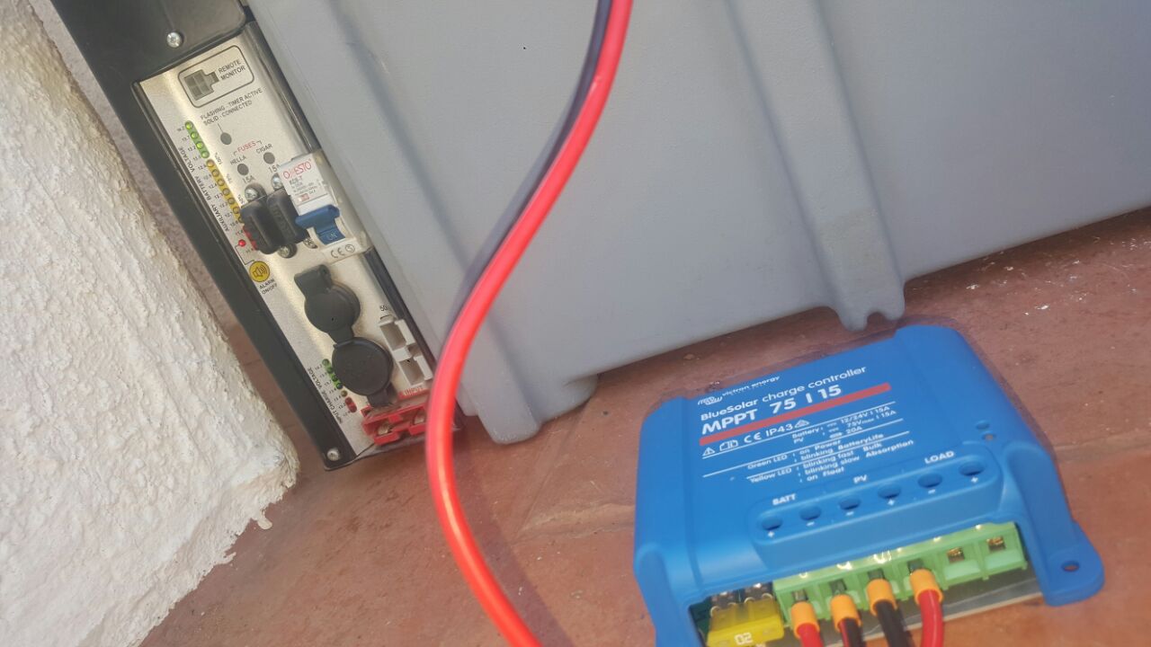

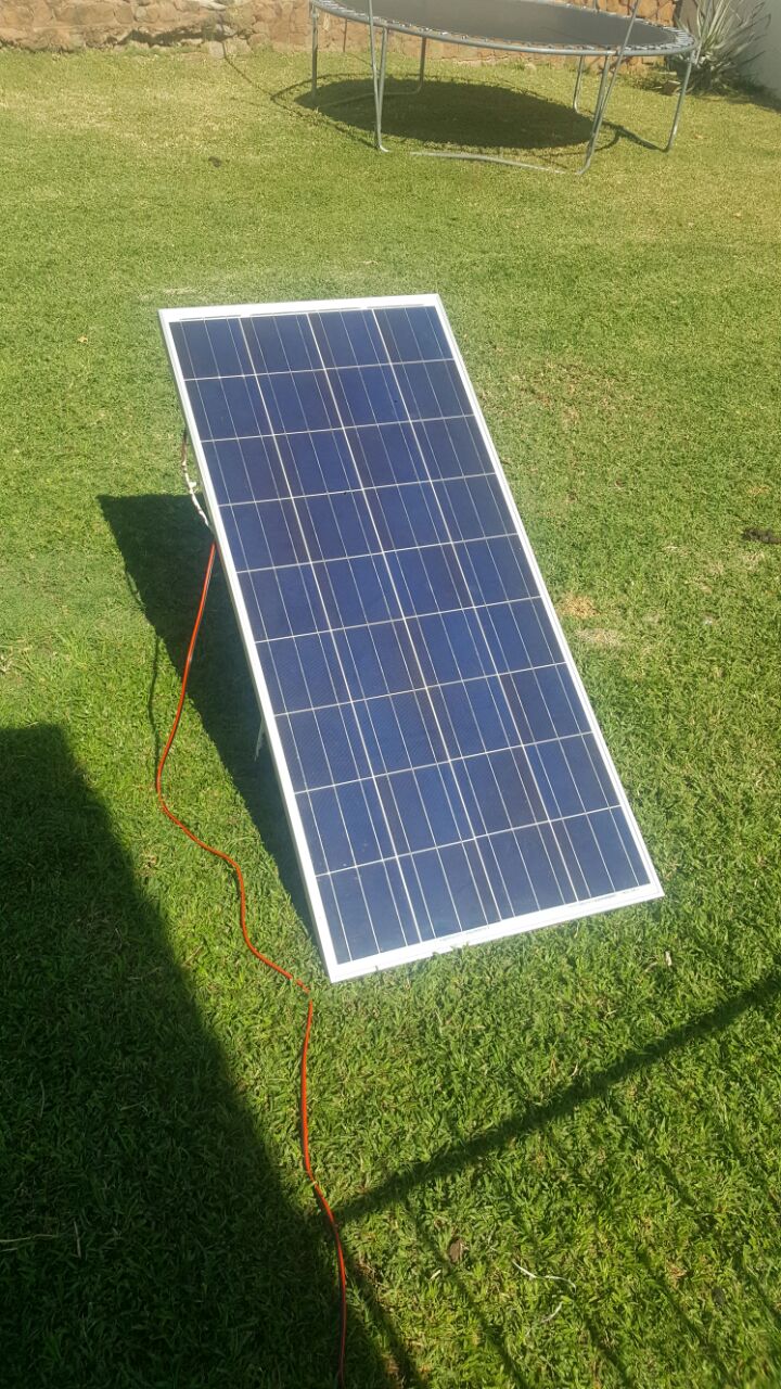

Well, connected all the stuff (temporarily) over the weekend. Wanted to finish the build, but our local shop had no stock of Brad Harrison connectors, and so I just thought I'd do a test run.
Very impressed, actually... My first (serious) experiment with solar, and it works a treat. Amazing concept - generating electricity from nothing...
To test, I connected solar panel to controller "PV". Controller "Battery" directly to battery. I did not connect anything on the controller "Load" yet, as I need moar Brad Harrison plugs....

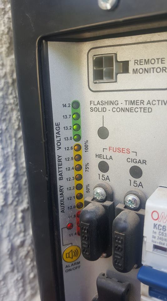

Not measured amp and voltage output, but with the 140W panel in full sunlight, I was getting a very healthy voltage 14.2V onto the battery.
Even with the panel in full shade, there was enough ambient for it to push a voltage of 13.7 to the battery. As mentioned, I didn't test output Amps, but this voltage is theoretically more than the minimum require 13.6V required to charge a 12V battery. In short, it probably will not be able to carry any load, but it would theoretically allow one to recharge a battery (although that may take very long - depending on A).
Still work in progress, will post more once I get Brad Harrisons and have some time to finish building this stuff.
