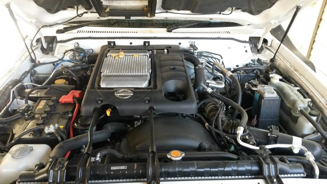

If it is a 2013 model, that is the year in which the Direct injection engines were replaced with the CRD in the SA market. In Australia it was in 2007.
So yours is either the one, or the other! That helps!
Attached is a picture of the CRD engine.
If this what yours look like, you have the right one.
In either event, get a sensor system like madman installed.
The diesel heads on this forum, as confident as thy are about their engines, still likes to monitor numbers for peace of mind.
