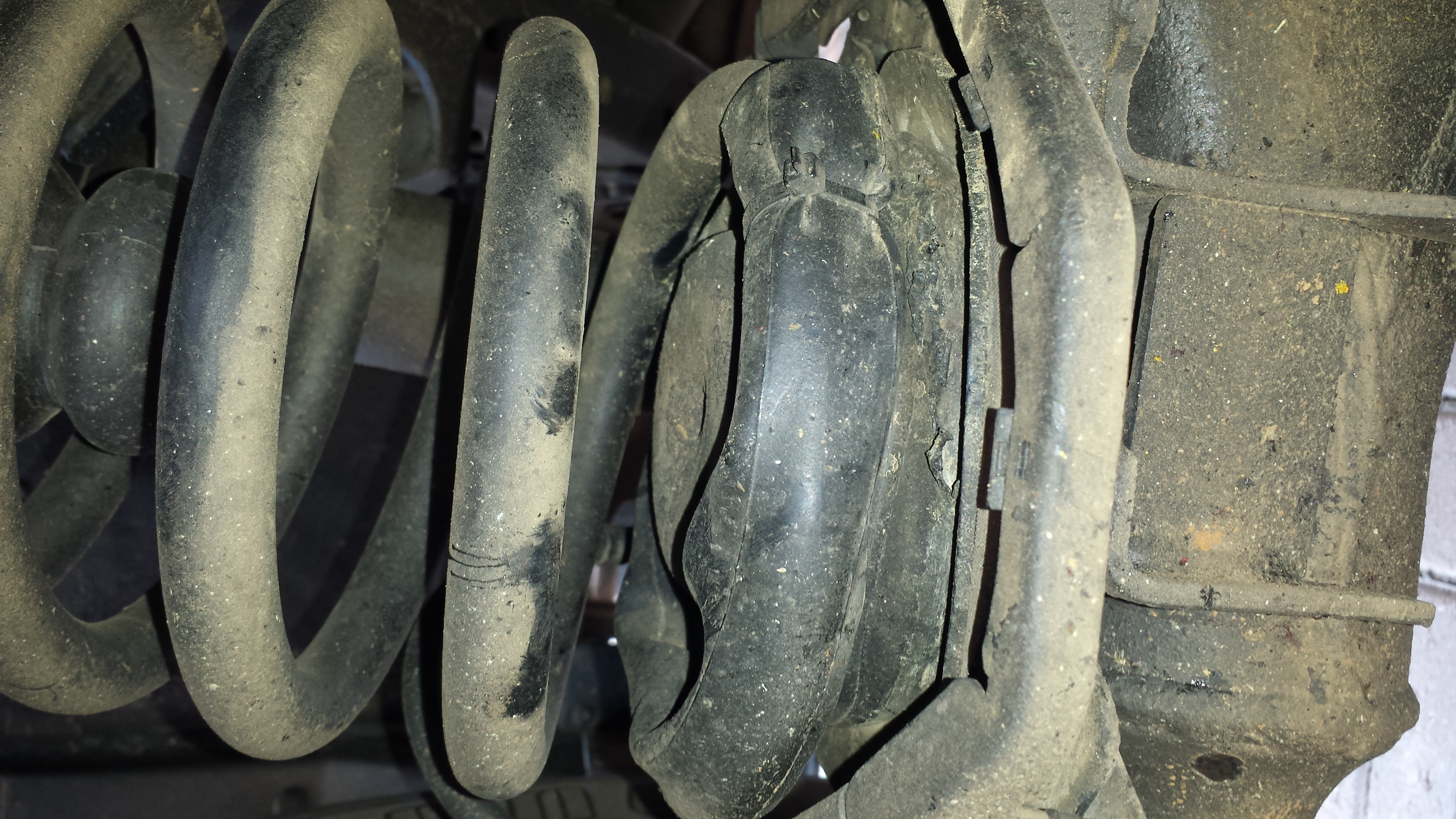

Ever since I bought the Patrol, it had a 'crunch' sound at the left front suspension when I cross i e a speed bump. I had the shocks checked at two different places and both confirmed that the shocks were fine. The lower part of both front coils are wrapped in what looks like a bicycle tube and the left one was loose, so I tied it again with cable ties. However, the sound is still there when you cross a bump. It sounds like a dry joint, but where?

DanieG wrote:Ever since I bought the Patrol, it had a 'crunch' sound at the left front suspension when I cross i e a speed bump. I had the shocks checked at two different places and both confirmed that the shocks were fine. The lower part of both front coils are wrapped in what looks like a bicycle tube and the left one was loose, so I tied it again with cable ties. However, the sound is still there when you cross a bump. It sounds like a dry joint, but where?
That bicycle hose cable tie story does not sound right. Any chance of a picture?
Tube om regter voorveer.jpg (3.99 MiB) Viewed 6466 times

Hi Danie
That set up is not stock Nissan with that rubber tubing on the lower section of the coil spring and it also looks like you have a rubber trim packer resting on this coil at the bottom.
Is the picture of the drivers side coil?
On a stock 4.8 patrol the bottom of the coil sits directly in the metal coil seat of the axle, there is no rubber trim packer.
On the top of the coil there is a thin +- 5 mm stock rubber trim that is inserted on top of the coil and between the chassis coil recess which must be lined up correctly to seat without any metal to metal contact of the coil/chassis.
Nissan stock front coil is 16 mm diameter, use a veneer to measure to make sure you have the standard coils in place as it looks like you may have OME coils which would them measure 20 mm diameter.
If you have OME coils then you should also have OME shocks due to the extra lift height which would damage the Nissan stock shocks over time
Looks like you have stock nissan suspension.
