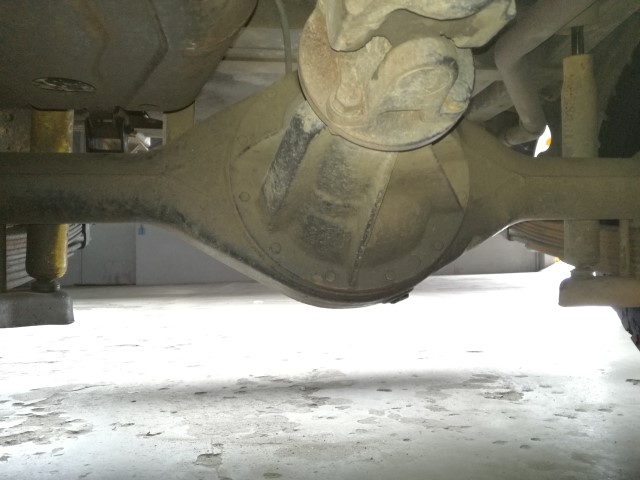

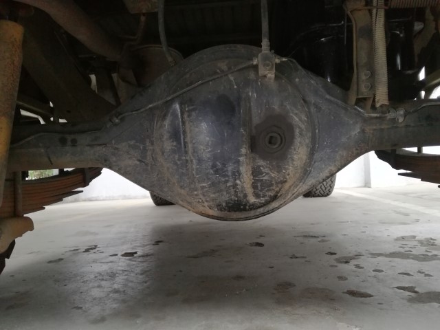

Hi Guys
Can anyone help me with identifying the axle? I am attaching some pics here. It has 12 bolts on the housing.

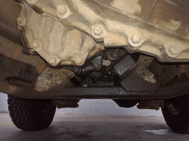

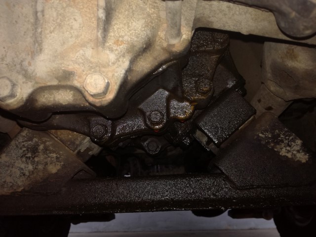

Also attached is a pic of the leak from the transmission that has developed. I read that the vibration from the prop shaft has caused the seal to fail. Can anyone confirm what issues will have to be resolved here?
Just to confirm, the vehicle is a TD42GQ Y60 pickup with leaf springs rear and front.
Thanks for the help!
