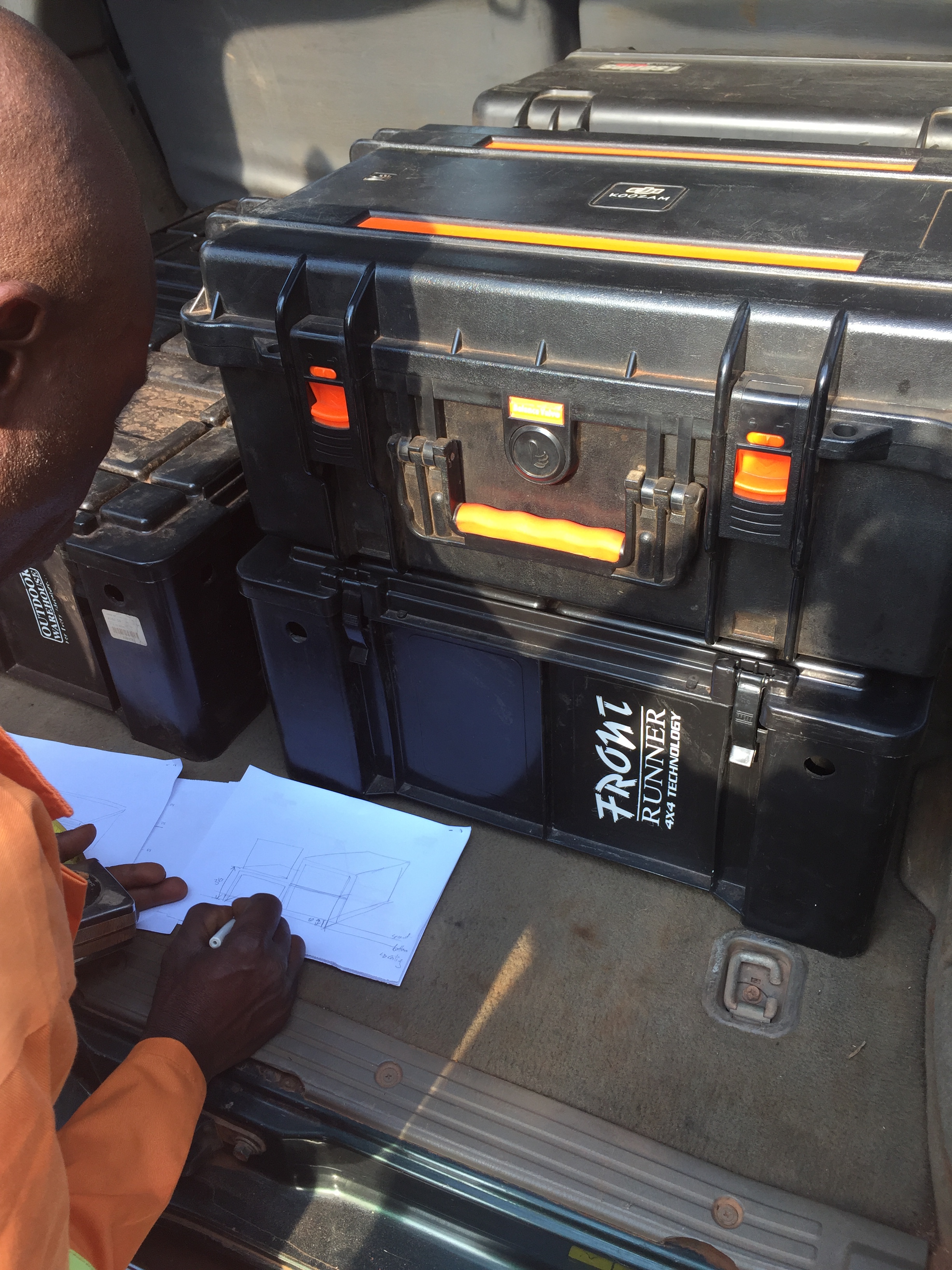

Thanks Oetie, battled with the image process! hopefully it is showing now. Fabricating some square tubing for a lighter frame at the moment. Should be back from the boilermaker tomorrow (hopefully).

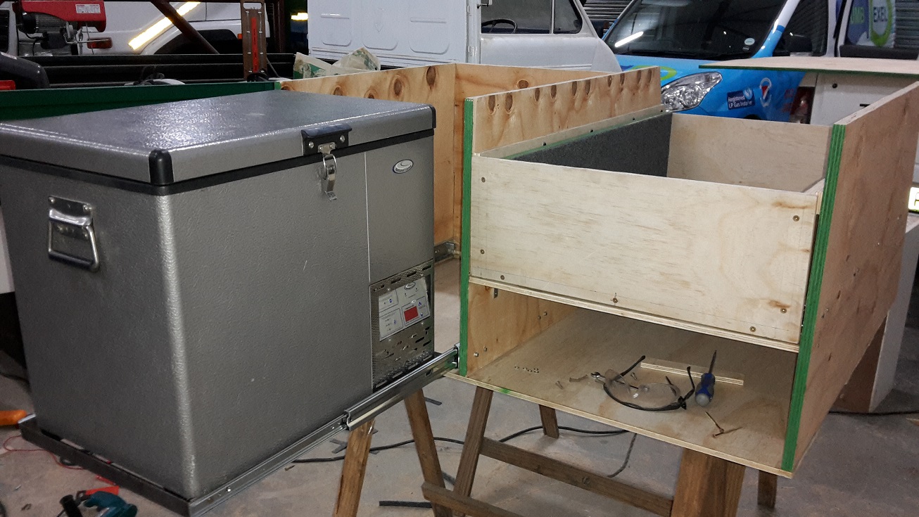

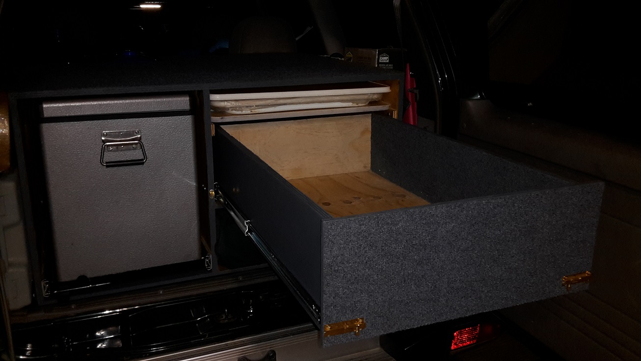

Other option when Alu and steel is not available, is to use plywood!
In progress
Halfway there.jpg (342.14 KiB) Viewed 6394 times
Finished
Packing 3.jpg (246.84 KiB) Viewed 6394 times

Wood is actually a very under-rated material, as long as you can keep it dry. This should be fairly easy in a packing system for an SUV.
My only issue wit it is that you have to use fairly thick sections, which uses up space, but whether or not this is a problem depends on just how much you are trying to squeeze in there.
Glass fibre, while a real bastard to work with, is also relatively strong for it's weight.

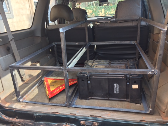

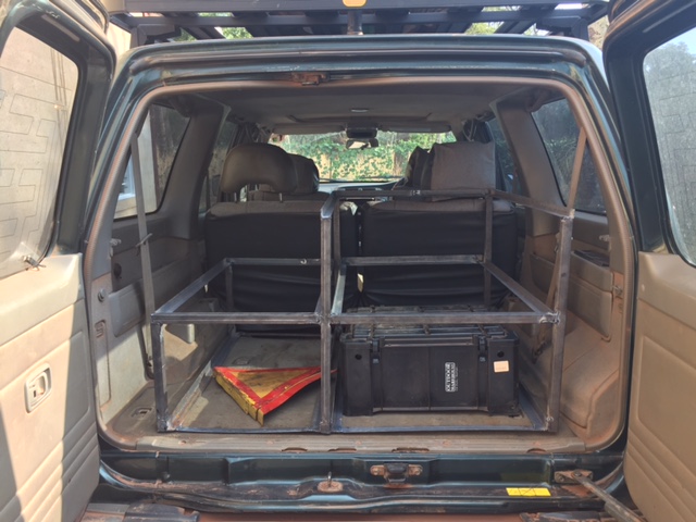

A few days in (been a hassle trying to resource just a few pieces of square tubing and angle iron) and here is the frame work. Things continue today, and hopefully all finished by the end of the day. Surprisingly, the frame is very light so far and robust.
