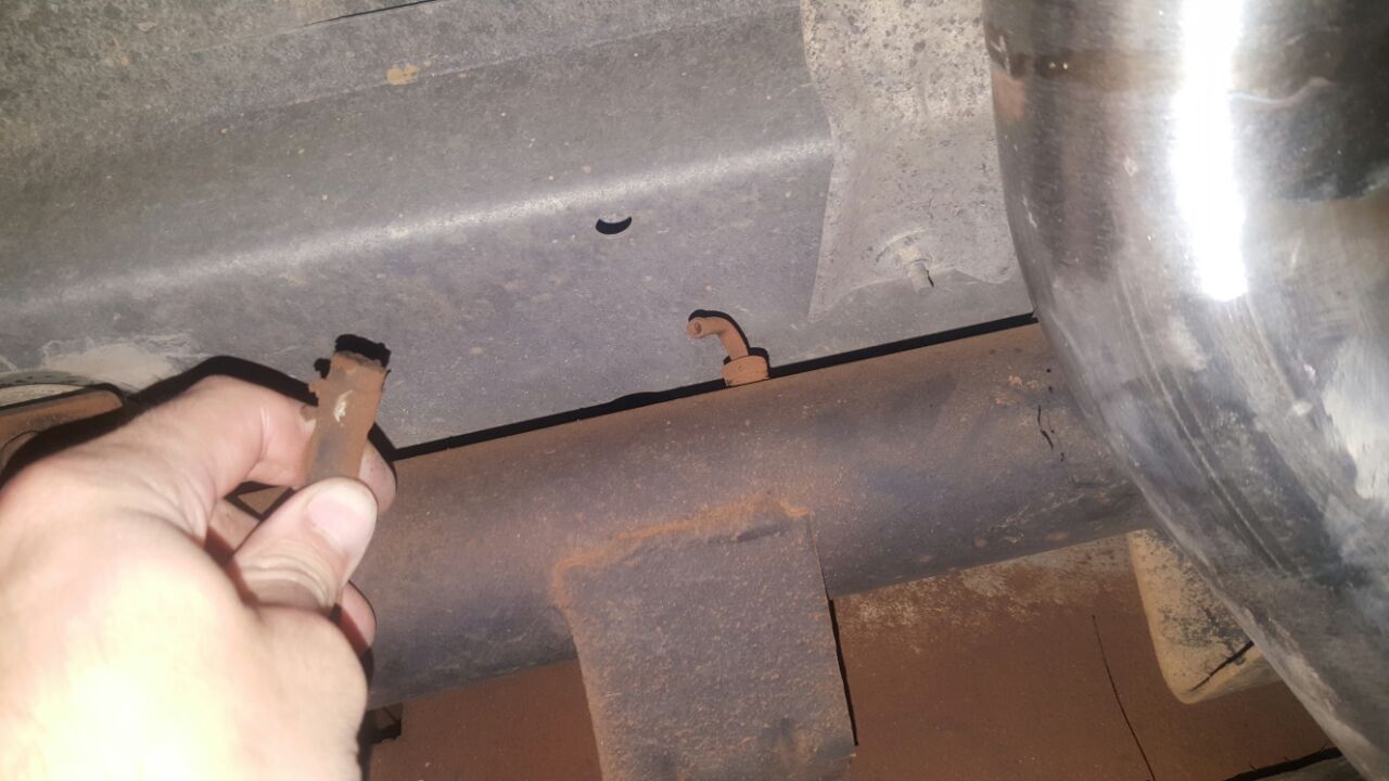

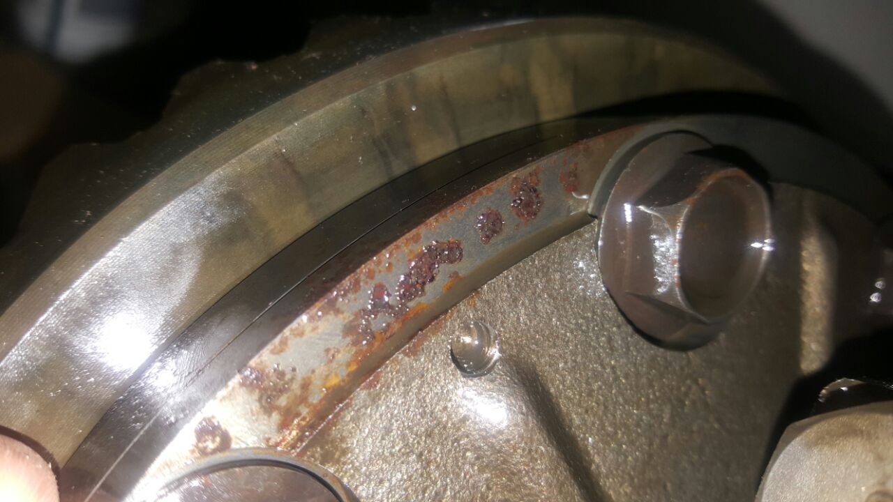

So I just wanted to share one of my findings on a Patrol rear diff. The diff was whining quite a bit and I decided to remove it for inspection.
Firatly the oil was in very bad shape, looked like old diesel oil.

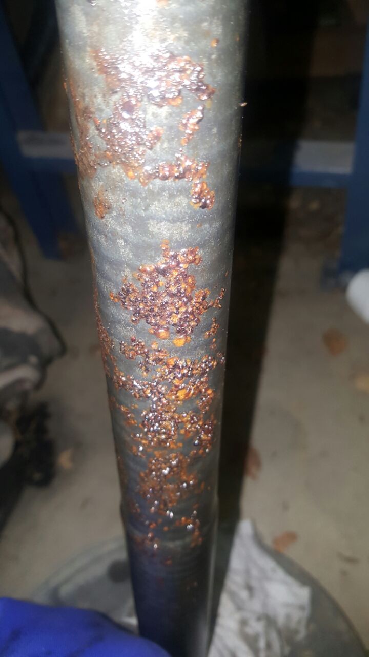

When I removed the sedeshafts I saw areas of rust which already gave me a hint that water must have been in the diff.

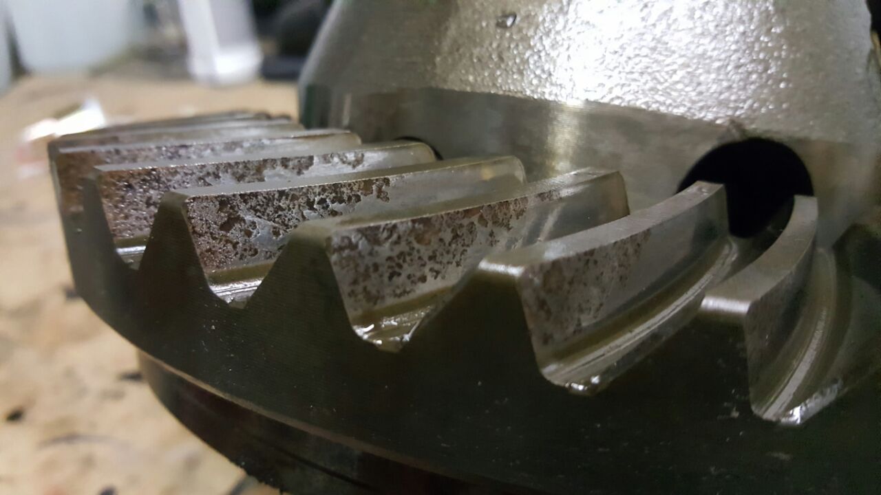

The crownwheel told the reat of the story.
All of this was due to the breather pipe that got disconnected from the breather line just above the diff which allowed water to ebter the diff.
So one tip of advice, make sure your breather lines are in working order......it might save you a diff

- Disconnected diff breather
- IMG-20161102-WA0003.jpg (104.24 KiB) Viewed 9181 times
- Sudeshaft
- IMG-20161102-WA0001.jpg (89.9 KiB) Viewed 9181 times
- Diff
- IMG-20161102-WA0000.jpg (114.7 KiB) Viewed 9181 times
- Crownwheel pits
- IMG-20161102-WA0004.jpg (89.46 KiB) Viewed 9181 times

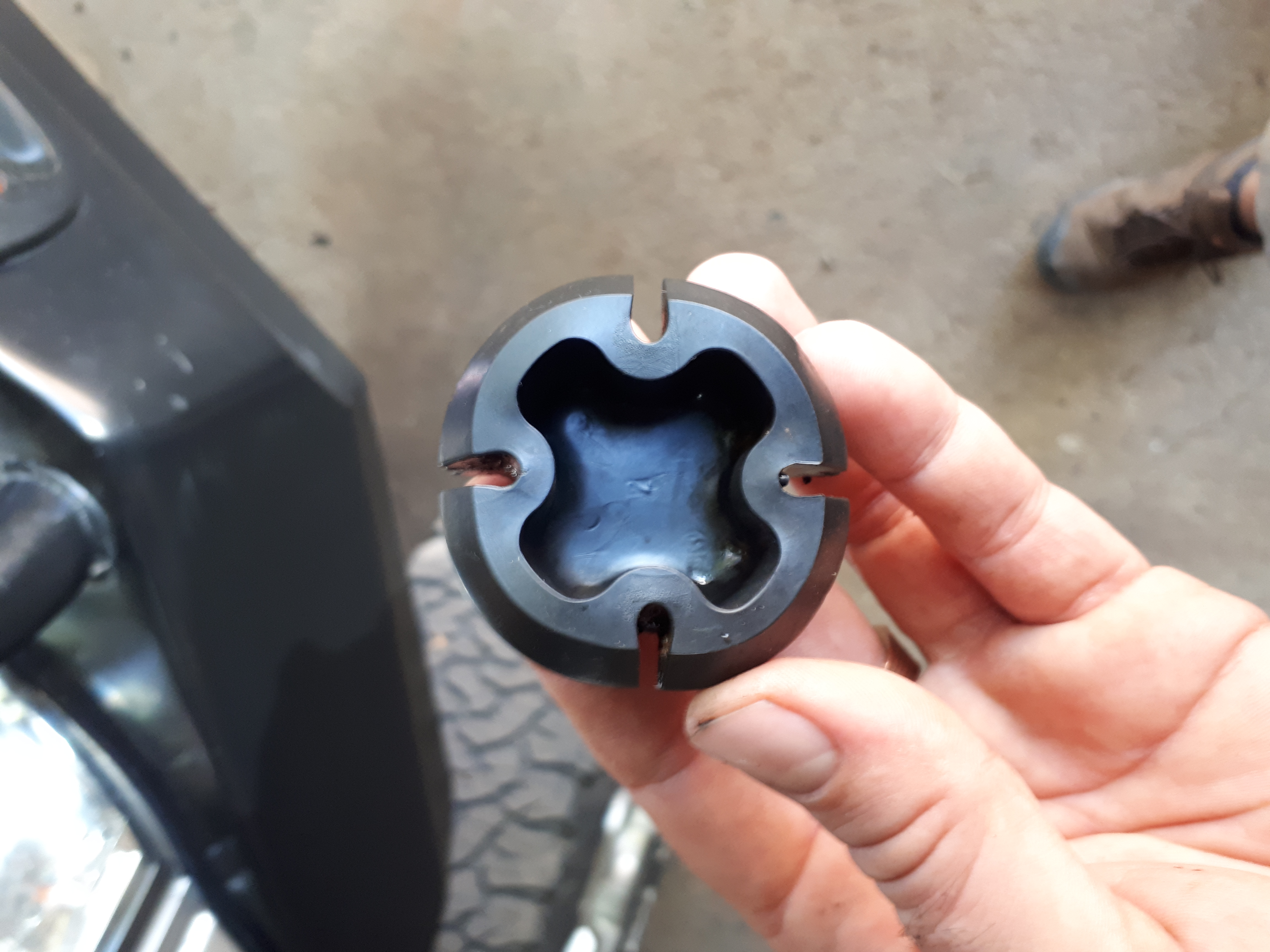

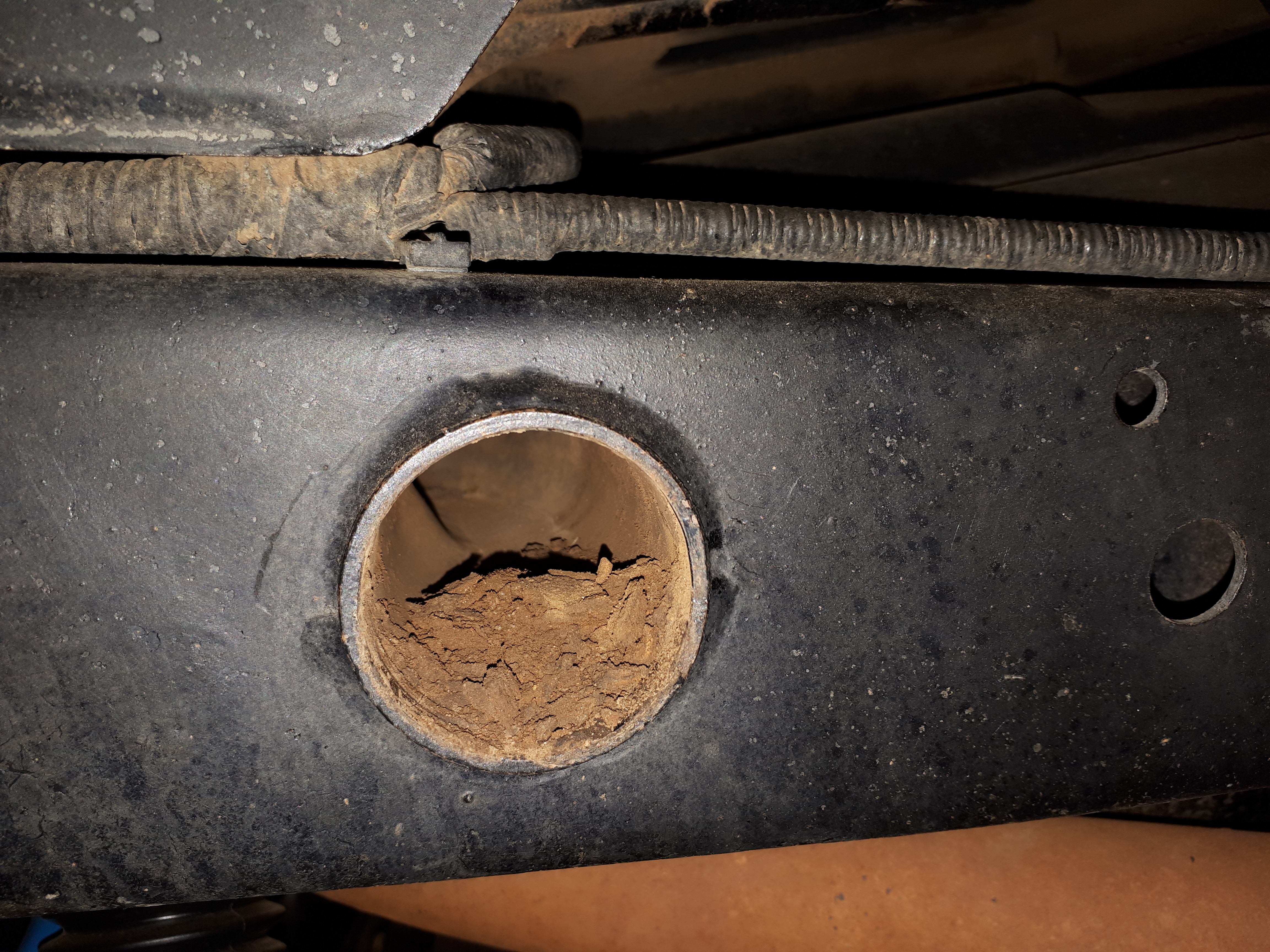

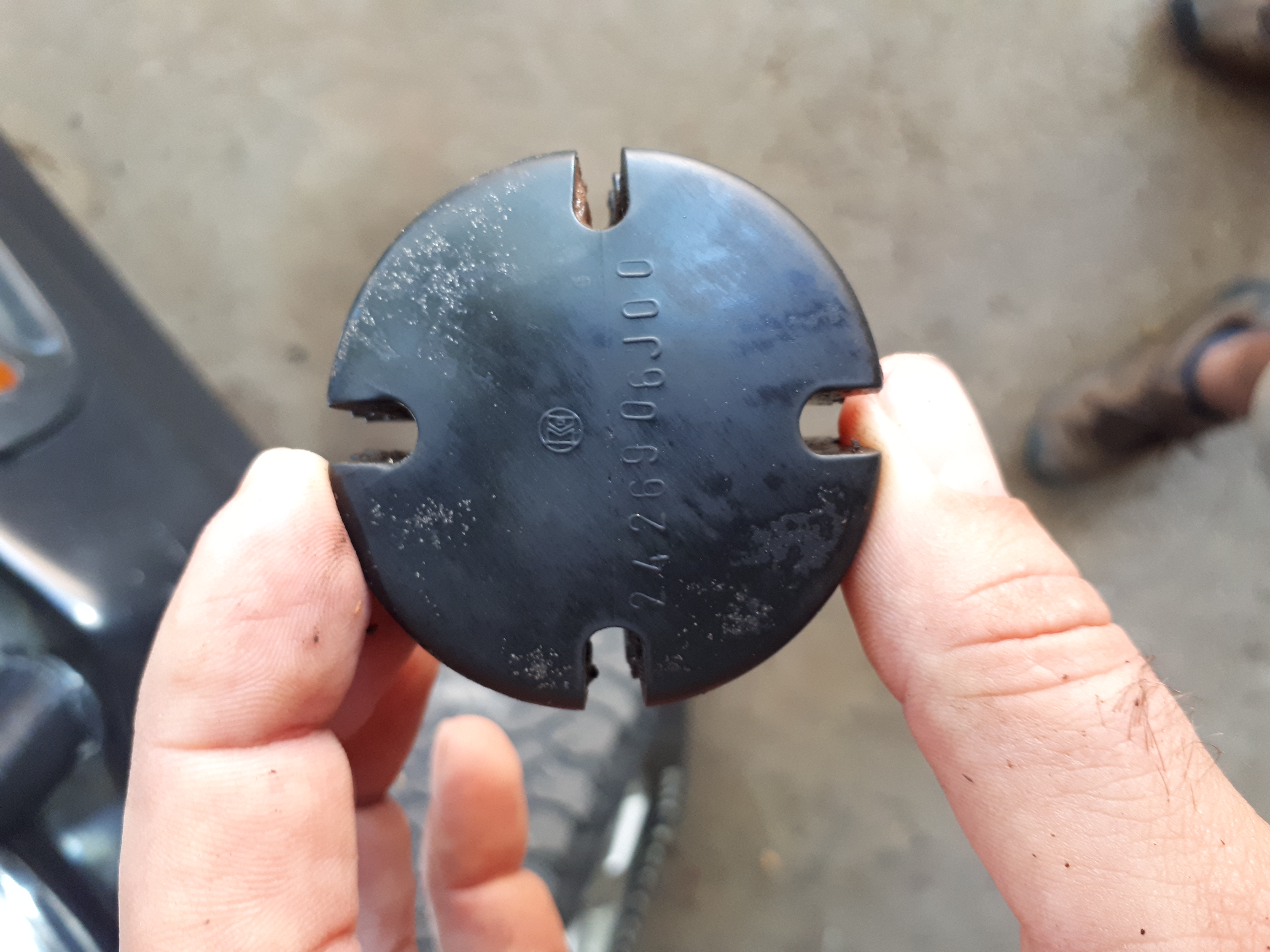

Just a side note, those rubber plugs on the chassis crossmember that accommodates the rear diff breather are not completely sealed. I'm sure they are fine for a quick dip in and out but complete submersion would flood the crossmember with water. On the y61 at least. Not sure about the GQs
Also I pulled mine out and found alot of dirt in the crossmember. I disconnected the breather pipe and blew it out with compressed air. Might be wise to check yours also :mytwocents
The rear diff is a bit more vulnerable, ending in the one of the chassis cross-members, which has rubber plugs in the ends. Lose one of these and you could have issues.
[/quote]
