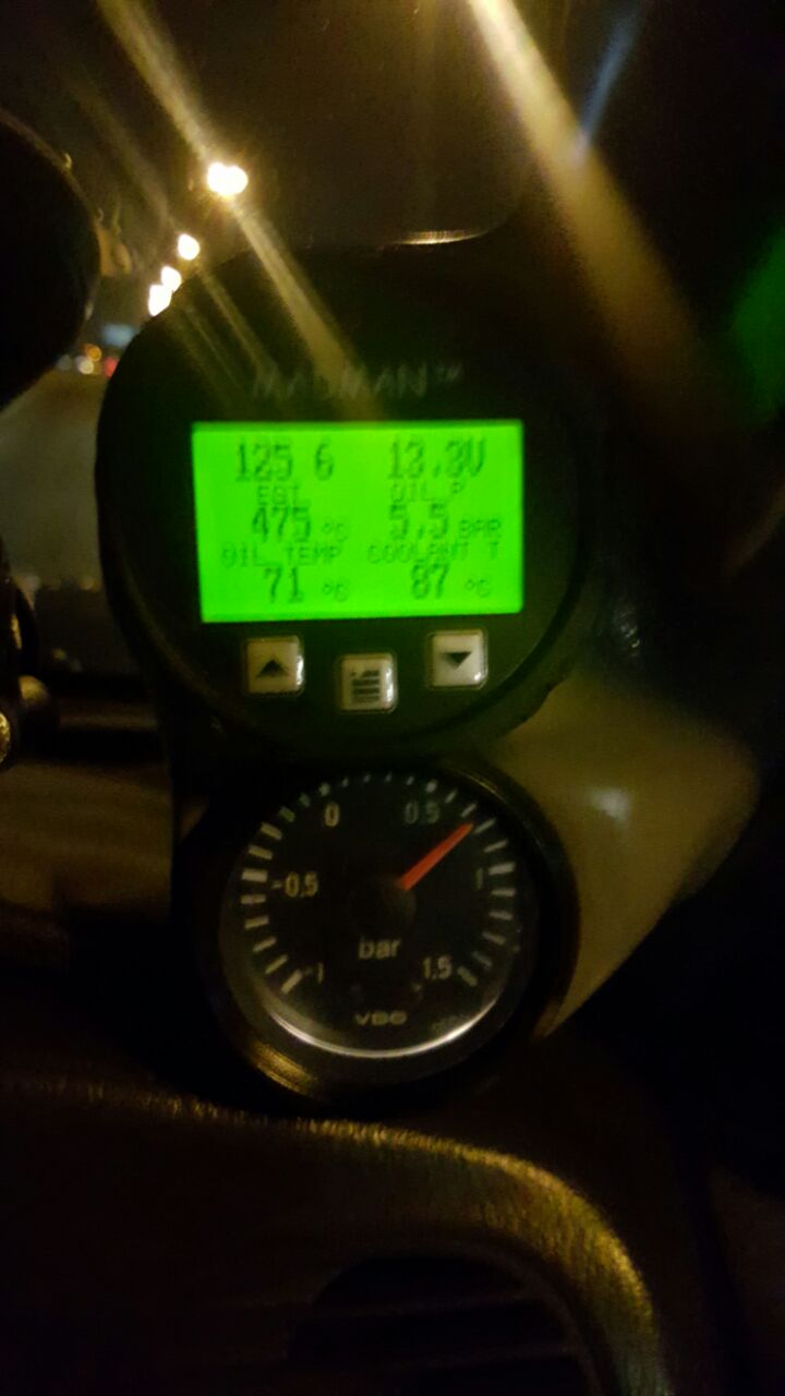

Cedric, so far it seems like there is about a 10 deg average lower temperature between the 3 core copper and 2 core aluminium.
I have driven on the N1 about two weeks ago and had the aircon on. We were 4 adults in the car and I was driving at about 130km/h and keeping it at about 500 - 520 EGT’s.
I was trying to keep the EGT’s high to really see if the radiator cools better or worse.
As I hit the top of the hill right there by the N1/R21 crossing the water temp exiting the engine was at its highest throughout the whole test and was 93 deg’s.
I kept the speed at 130km/h and the EGT’s went down to around 470 where I wanted to keep it for the remaining piece of road. I drove this way until I reached Old JHB offramp on the N1 where the water temp was 87 deg.
The test was done on the 14th of October just after sunset, it was quite warm that day and the aircon was also on.

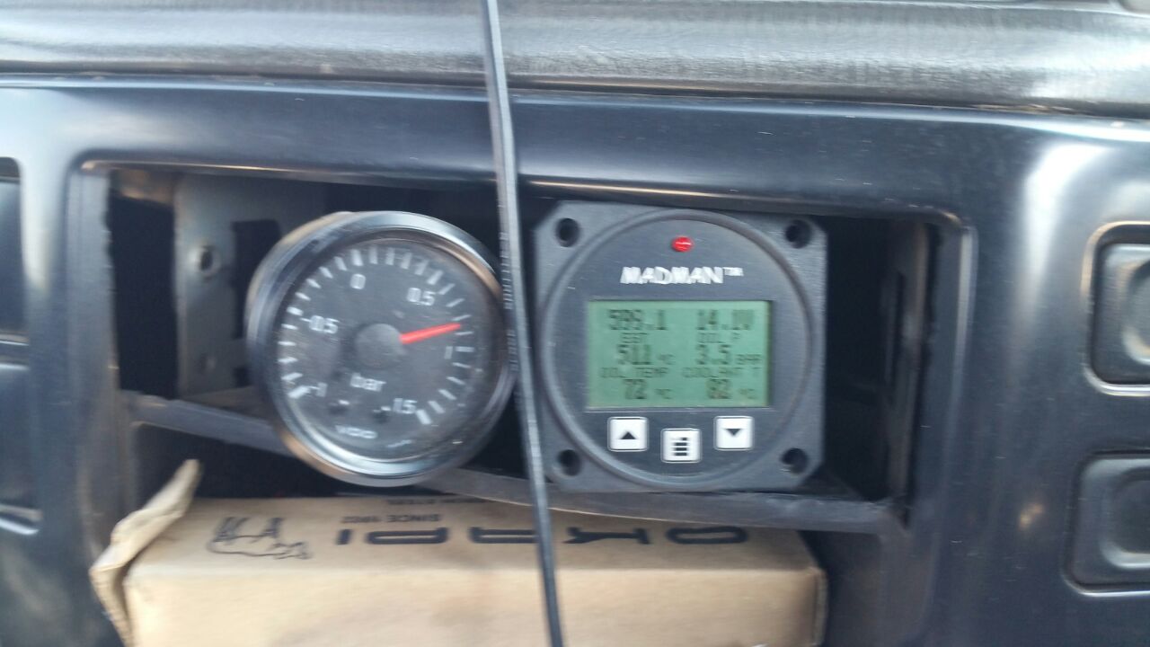

- Tinus's tems this morning at Hennops area
- IMG-20161024-WA0008.jpg (92.39 KiB) Viewed 2185 times
- My temps at Old JHB offramp
- IMG-20161024-WA0007.jpg (64.89 KiB) Viewed 2185 times

Jip allu is the way forward on the hill where i used to get watertemp up to 108 is at 82 ....what is more interesting is when my egts are at 450 my watertemp is dropping
The hole system cools much faster and reaction time is much faster .
Iam a very happy camper
