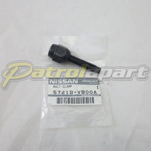

Ian, dd you get a standard one yet? Think they will be quite expensive to get from Nissan. (http://patrolapart.com.au/product/genui ... ith-thread).
Wonder if there is not another company that can supply them.. ( I mailed a-line to find out if they cant supply them, will see what they say).
What is the specs for the bolt: m10x1.25?

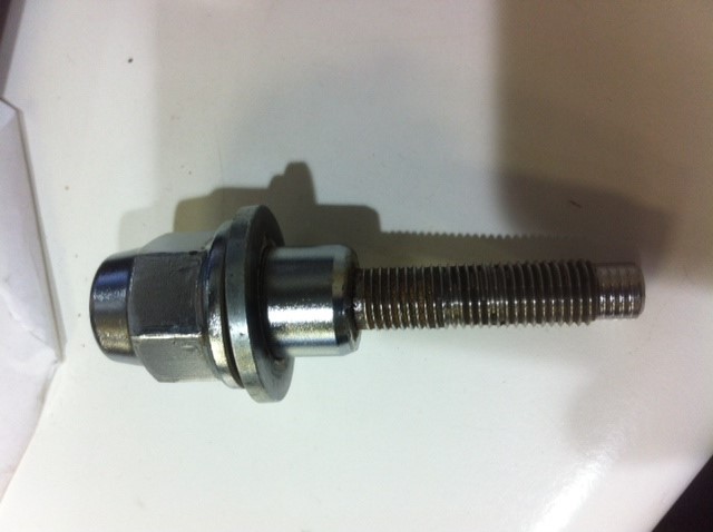

Fanus - The photo above is for mags. Ask Michael to post a photo of the one's I gave him which are for steelies but also work on the mags. Much simpler and easy to make up as Errol says.

Yes I know.Mini Patrol wrote:Fanus - The photo above is for mags..
Just posted the photo to show what the ones for the mags look like.
The steelies ones are these: I will try to make my own ones.

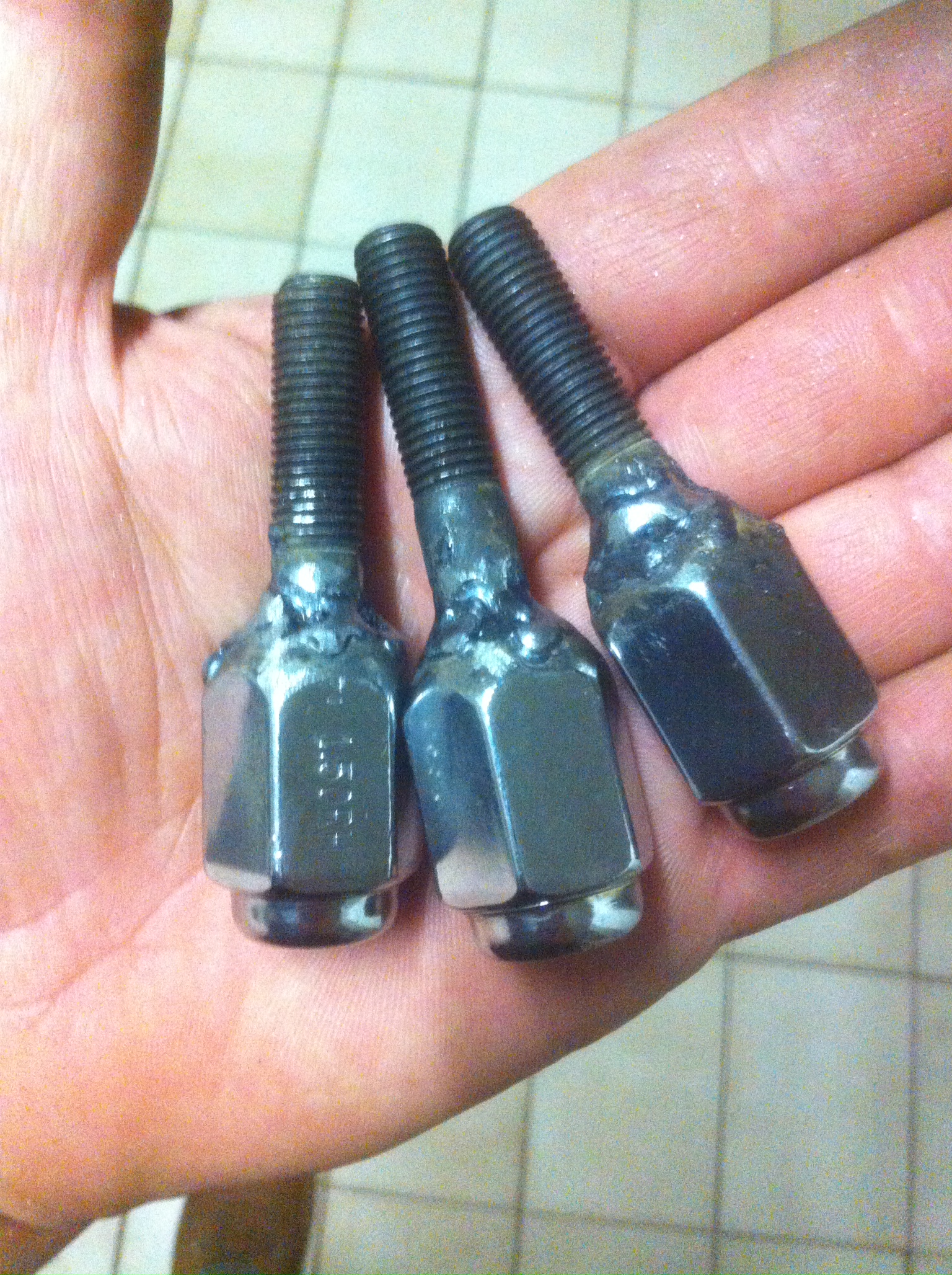

I'm not much of a welder, but this seems to have worked...

I think you can start taking orders. Not bad at all.SJC wrote:I'm not much of a welder, but this seems to have worked...

Baie mooi Fanus, daai sal werk
As jy wil he hulle moet mooi in die centre sit moet jy langer boute koop en hulle deur draai. Sny daai doppies agter op die nuts af en draai die stud/bout so entjie deur. Weld hom dan aan die agter kant
