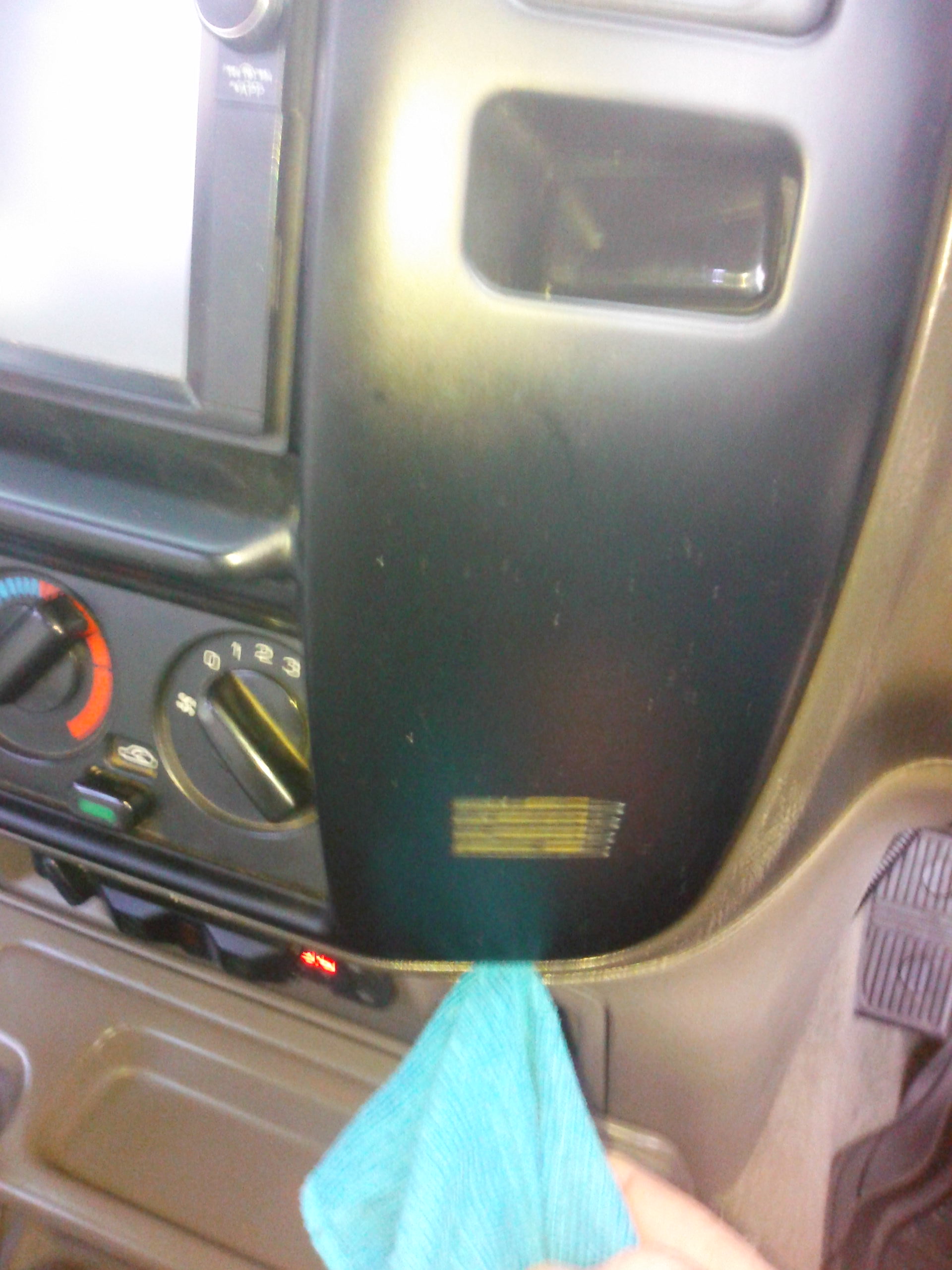

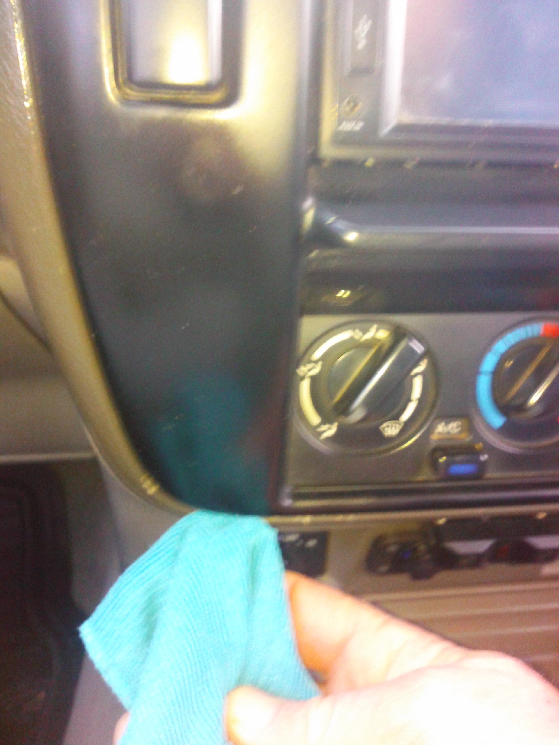

IF IT IS THE SAME AS MY OLD 4.5 . Look at the 2 bottom corners of the cover. Should be a tiny cutout near each corner that a medium flat screw driver fits into. Cover the blade of the screwdriver with a decent cloth, insert screwdriver and lift and lever out. Do both sides and the you should then be able to manouvre the other clips out as you will see them.
When re installing fit top first and work your way down.

Check from the bottom if those 2 little slots are there. I was told by Nissan that the new cover for the double din fitted my old '98 but when I heard the price I modified my old one for the double din I fitted.NISMOnator wrote:2007 4.8 GRX
This would mean your 2007 should be the same. Will take a photo of where the slots are just now and post.

Where the cloth covering the screwdriver is at the bottom of each pic

Try to loosen it from the bottom as per Davids pictures, You can also try to loosen it from the side. Start with the LH side . (The center console panel includes the vertical wood-trim ... its one part )
