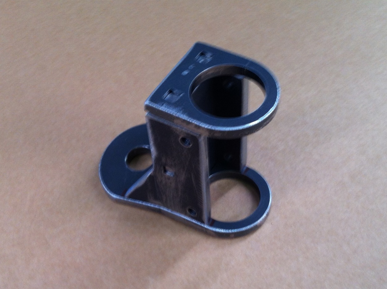

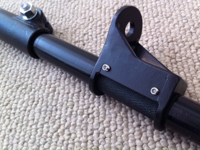

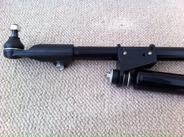

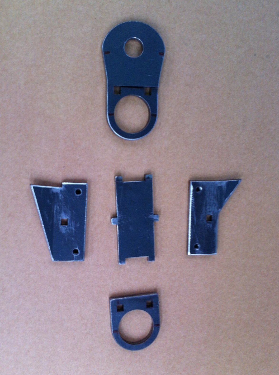

Re: Y61 GU adjustable drag link wanted
I had the same quality concerns using pirate tie rod ends.
What I did was purchase an original Nissan tie rod complete with tie Rod ends and had the rod shortened and a new thread mavhined to match thr drag link length. The damper mounting bracket cannot be welded to the new rod as it is now adjustable so I had a swivel mounting bracket made. Thr Rod was knurled in the correct position and the mounting assembly is then located after steering adjustments in the correct position by four grub screws.....hope I have explained this correctly!! Total cost was less than 3k
Will attach a few photos.
- Welded op
- image.jpeg (241.04 KiB) Viewed 9359 times
- Damper bracket
- image.jpeg (387.8 KiB) Viewed 9359 times
- Drag link
- image.jpeg (165.69 KiB) Viewed 9359 times
- image.jpeg (185.81 KiB) Viewed 9359 times
That looks beeeeeeeeeeautiful !!!
