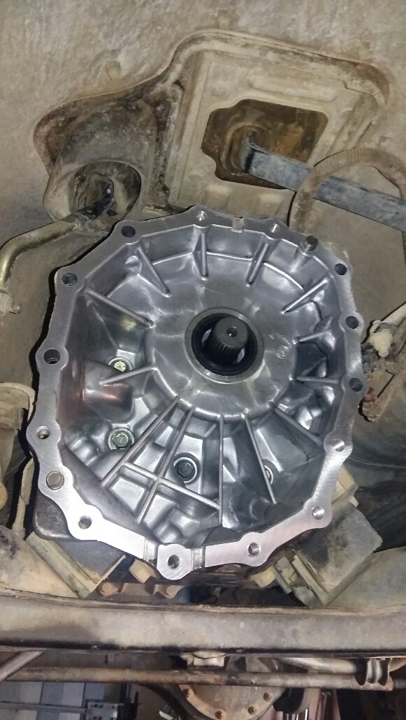

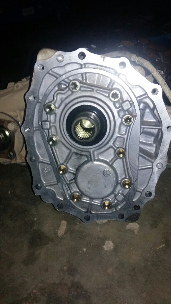

My Patrol leaked oil between the gearbox and transfer case.
I removed the transfer case on Saturday and will replace both the gearbox seal and the t/case seal.
My question is: Should I use original Nissan seals or can I use aftermarket seals? I can get seals from Seal Centre in Pretoria.
Is Castrol ATF Dex III the correct oil to use in the t/case?

Dex3 atf is correct. Some use same oil as in gearbox, gl4 75w90 i think.
Apparently dex3 atf is better for vehicles fitted with auto locking hubs, according to aussie patrol forum guys.

Re: Gearbox and Transfer case seals
GOOD DAY GENTS .
After market seals will work well , but will only last for about 2 years . Rather spend the extra money to buy genuine seals if possible .
Why is the seal leaking ? Has the seal gone hard , or have the lips worn ?
A hard seal would indicate high gearbox temperatures . Worn lips would be from high mileage . If the lips are not worn , then you have a shaft with excess runout or wobble . It's nice to see you guys working on your own vehicles ! When all goes wrong in the bush , at least you have some idea of the workings of your vehicles .
Enjoy guys , we'll see you out there somewhere !

I use 75w 90 GL4, but have heard people use ATF as well.
Phone Nissan and just get a price, usually they are not too expensive with seals
The seals are in and the t/case is back in the car.
You have to do a bit of underthecar yoga to get to all the nuts and bolts but myself and Jack (that is trolley jack) managed to get it out and back in.
I also weighed the t/case and it is +-50kg wihout oil.
