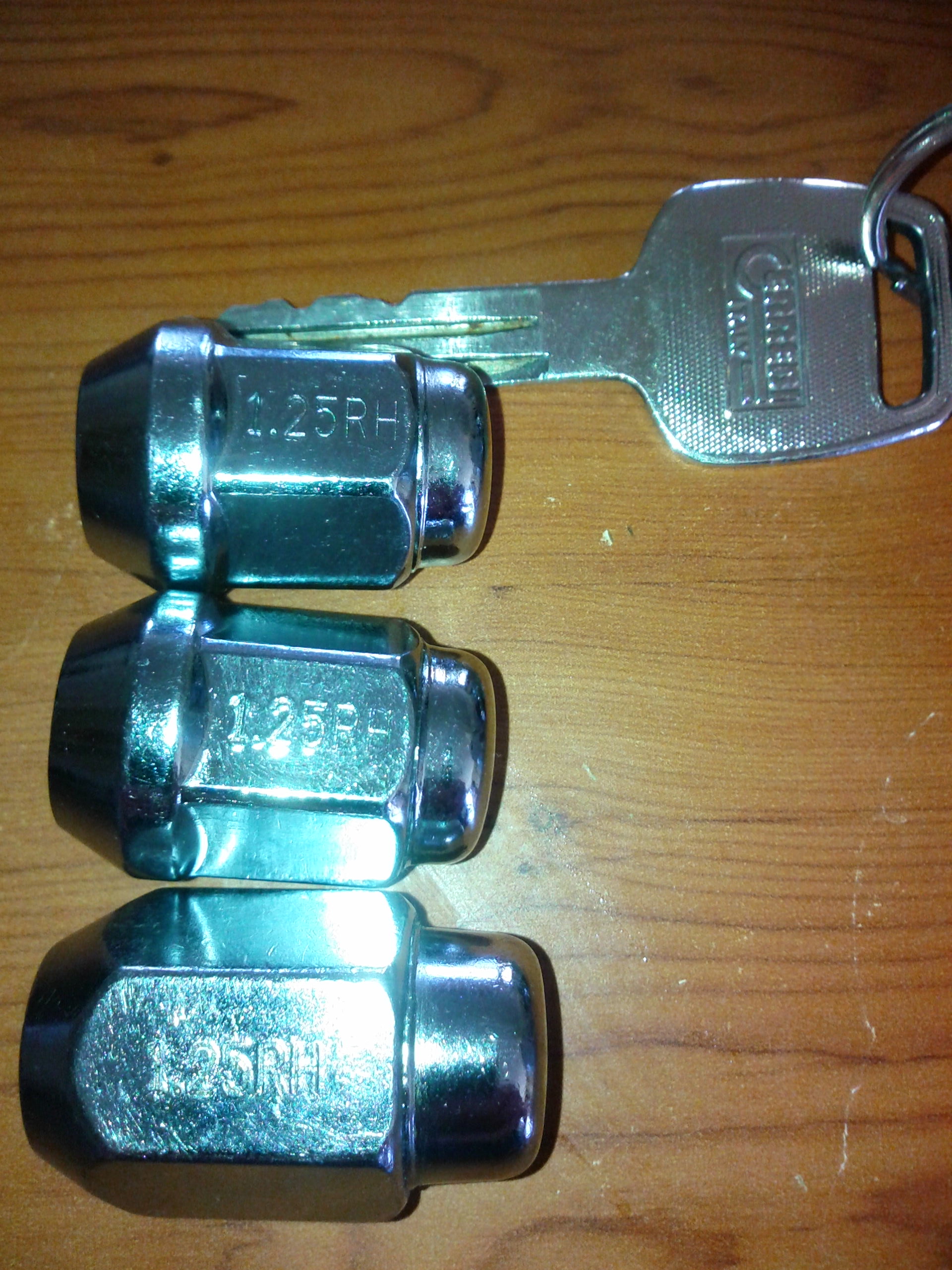

Re: Wanted: Patrol Wheel Nuts
Post by David M »
Fanus - I found 3 X 1,25 mm RH thread in my box of goodies - Are definetly not original Nissan.
2 are shorter (I think for mags) and 1 longer (I think for steelie but will also fit mag).
Measure the inside length of your existing nut/s and let me know so I can check what will fit before sending.
I can probably also get you extra's in the morning if you want.

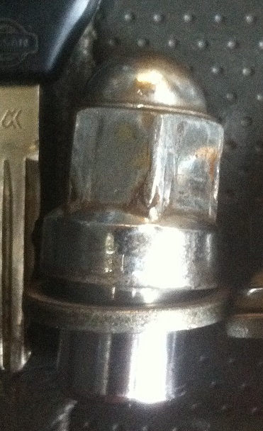

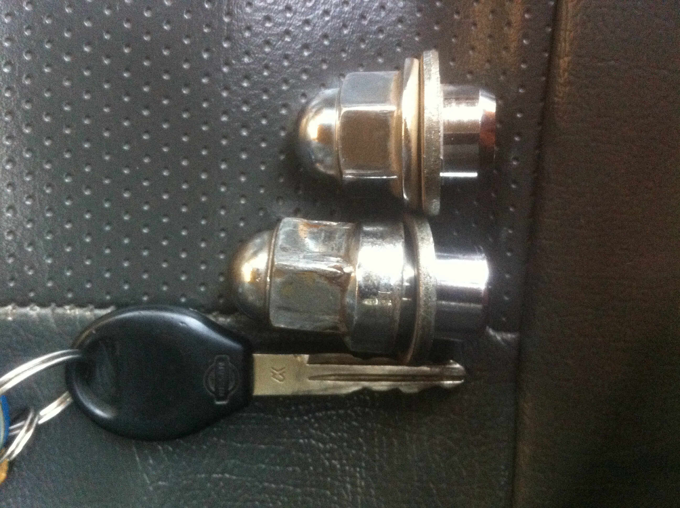

Posts: 3328
Full Name: SJC
Has thanked: 237 times
Been thanked: 203 times
Will measure them when I get home tonight. At the moment there is two types on my Patrol. not sure which is Nissan's. (Will know when I collect the other 3 from nissan tomorrow).
Thanks David. :salute:
Posts: 3328
Full Name: SJC
Mini Patrol wrote:The other thing you can do is go to your local Midas and get a set of anti-theft nuts. They will have as they also fit Honda and Nissan cars. I nut per wheel and problem sorted and they can't steal your mags.
But do not tighten the anti-theft nuts to 120 Nm like the other nuts.
Thats an idea. (anti theft nuts.)
At the moment I got 4 open nuts on the one wheel. (same as patrol pickup steelies nuts).
But there is definitely less thread between the nuts&studs with these compared to when they are fitted on steelies, or when compared to the wheel nuts with the shaft.
The full length of the open nut's thread is not being utilized, wich is a concern. The anti theft nuts might have the same problem.
