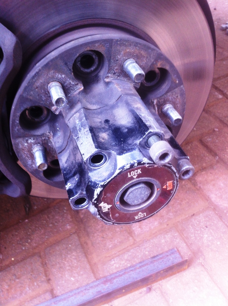

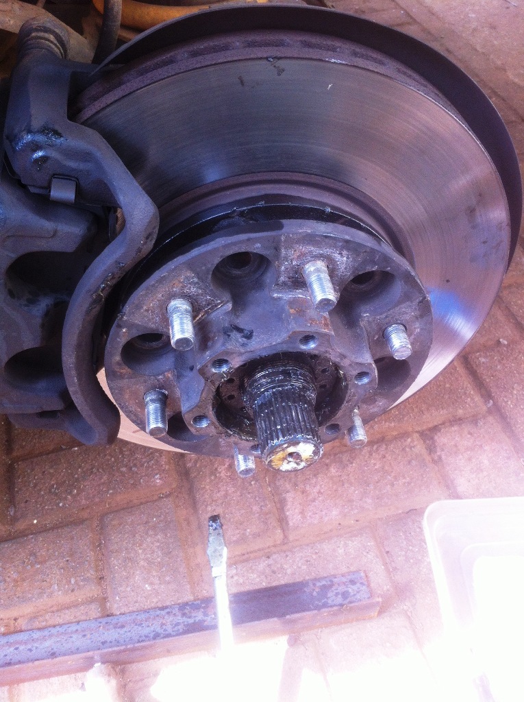

Ok, I have come this far. But now I am stuck.
How do I remove the front part of the wheel that hosts the studs (hub? not sure of correct terminology).
Do I have to take the whole wheel of ? after removing caliper/bracket etc. Is this neccesary?
Should the front part be able to come off now, after all the bolts have been removed. It still feels pretty stuck though.
Or must I give it some hammer to loosen it up?
There is not enough space for the studs to come out the way it is now, did try.
Scared I am going to break something....

What do you guys think of this method to create some space to remove/replace the studs?
1:30 minutes - 5:00 minutes. Wonder if it would be necessary to remove the brake/calipers for this to work. referring here to hitting the rotor/disc with a plankie to seperate it from the hub...

Nie die video gekyk nie (goedkoop data is op), maar jy behoort die disk so 5-10mm agtertoe te kan skuif as jy die caliper afgehaal het.
Weet nie hoeveel jy nodig het nie.
