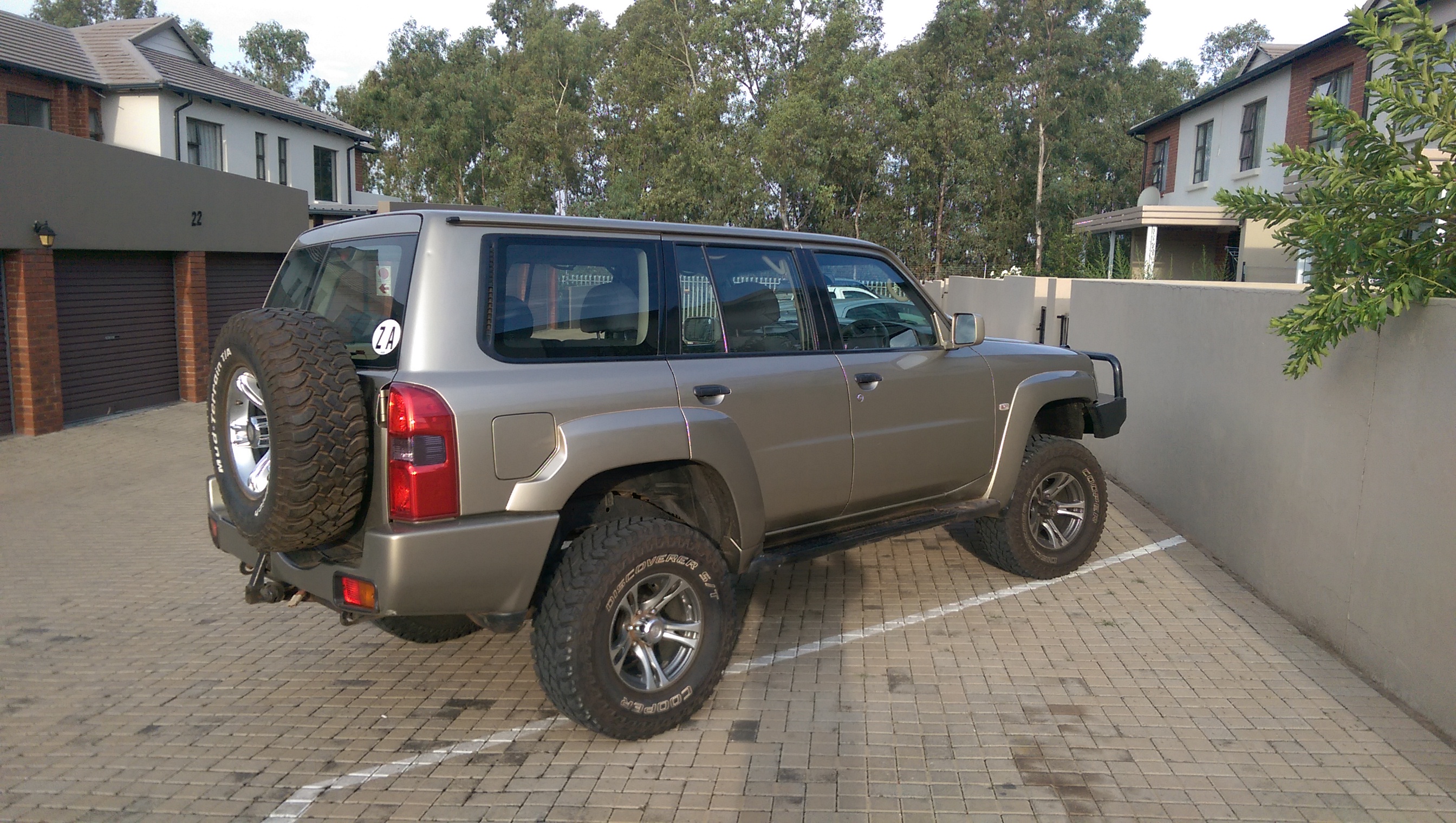

Hi Guys,
I've got a 4" TJM lift in my 2005 Patrol that I would like to swop for a 2" lift OME. Springs only.
The reason is that I use the Patrol as a daily driver and do not need that big of a lift. I also run 285/75/16's and not planning to go any bigger than that.
If you are running anything larger than 33's, need more ground clearance or if you use your Patrol as a weekend and trip car, then this kit would be great.
Pics below shows the lift height.
Cheers,
Philip 082 768 3984
Cheers,
Philip 082 768 3984

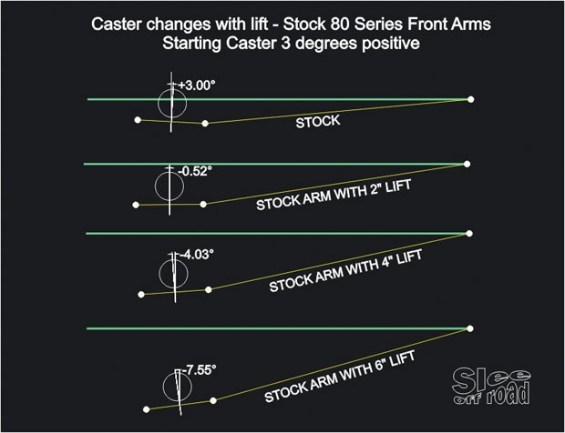

As far as I know you can only get a 2 inch correction bush as that's the most the inner metal sleeve can be offset in the bush. The OME bushes are offset and the Nissan Patrol rubber bushes are perfectly in the centre for the best possible flex and comfort.
Here is a pic for the land cruiser showing what happens to the caster with the different lifts. The stock patrol castor is 3.30 degrees =- .30.
When you go over a 2 inch lift the fun starts
What's interesting here is that if you get a 2 inch lift and the 2 degree correction bushes your caster will be 1.5 degrees which is still out of spec for the cruiser?
On my patrol with the OME 2 inch lift and OME 2 degree correction bushes my actual caster was around 2.4 degrees as per the wheel alignment printout
- 4-Land-Cruiser-OME-Caster-Correction-12-5-11.jpg (36.33 KiB) Viewed 3922 times

Re: 4" TJM lift to swop for 2" OME preferred
What would be the symptoms if the castor was not corrected with a lift?
AFAIK I got a 3" lift in my 4.5. The rear sway bar brackets was never extended, how would I know if castor correction was implemented or not?
What impact would it have on the vehicles driveability/handling or any other factors to consider?
- Posts: 6138
- Has thanked: 1125 times
- Been thanked: 1038 times
Fanus, the easiest way to determine if castor correction was done is to take a look at the bushes. If they are black, they are standard rubber. If they are some other colour (yellow normally) they are Polyurethane and thus probably correction.
Castor is what is responsible for "self centering". In other words, a car with a reasonable amount of castor tends to go straight down the road, whereas a car with less castor will require more steering input to keep it going straight.
Of course, as with all things castor also has a drawback. More castor means more steering effort.
On light track cars it is common to use much more camber. On this car: http://patrol4x4.co.za/viewtopic.php?f= ... kin#p59102 I used 7 degrees of caster.
The result was that in a spin, one could just let go of the wheel and the car would sort itself out. The other result was that a 7-lap track session left me with sore hands and forearms...
