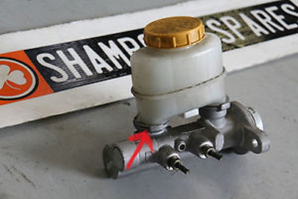

Ok... so I had to nip out the office for a few minutes and stopped at the spares shop to get another bottle of brake fluid as the light was on again. While pouring in more fluid I noticed fluid leaking out from the rubber shown by the arrow. ( photo nicked off the internet )
booster 1.jpg (54.51 KiB) Viewed 5574 times
So now I'm confused and know VERY little about these parts of my Patrol. I tried to push the reservoir back, thinking that it had popped out, but it wasn't going back in. The leak seemed to stop/slow down though.
I assume that a brake master cylinder kit will have a new rubber seal specifically for that.... or am I smoking my socks?
How easy is it to do the repair, and how long would it take roughly? Any pics on how this thing comes apart etc??

If it is that seal it should be fairly easy, pop off the reservoir, pop seal out and put new one in. That is if they are available. It should be part of the master cylinder kit.
You should not need to bleed your brakes either
