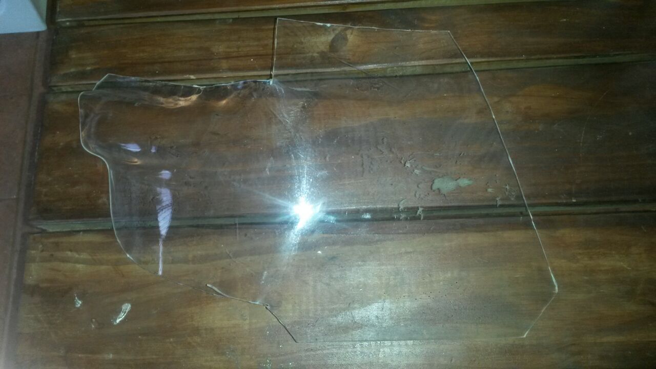

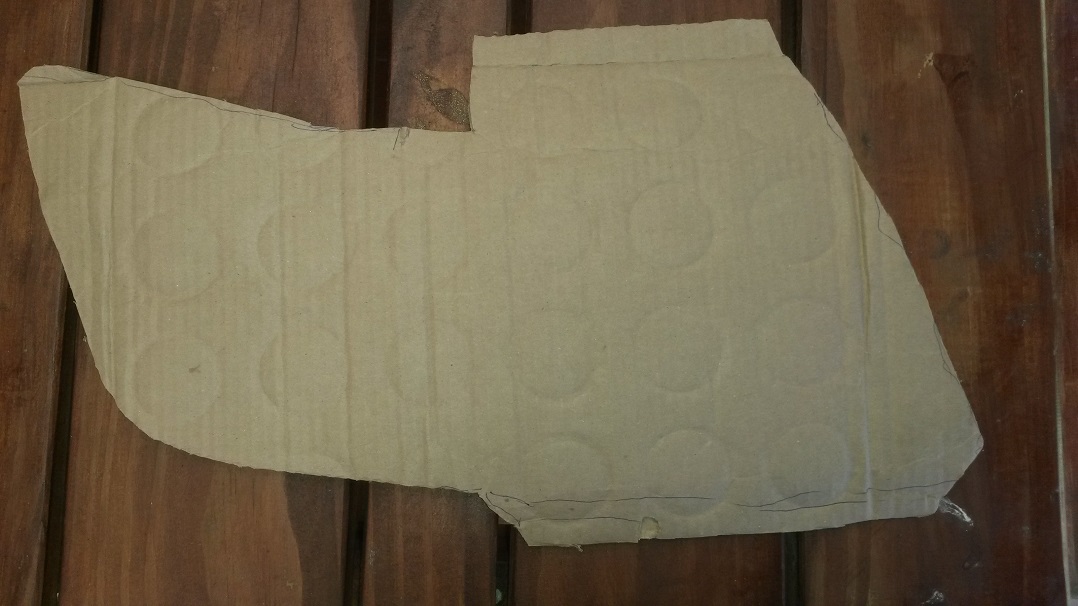

1: I used a cardboard template to cut the perspex.

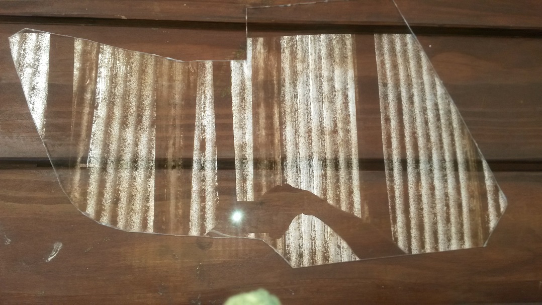

2: I cut the perspex with a dremel cutting blade. Not the best, but my point being that if people are interested, I can get perspex cut to size professionally. (PS: The reflection is the skylight on our patio - with the rain we have had, it is dirty).

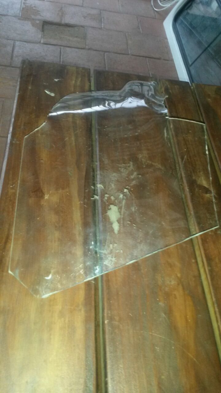

3: I used a heat gun to start shaping the stuff. It is painful. But ultimately, this build will be used to create a positive and negative mould. As such, it can look a little bad as shortcomings will be sanded out. At this point, I have to have proper samples right and left.
As mentioned, it is work in progress, but I am relatively happy with the way the corner light fits (even though it still looks super amateurish at this point). Will post when I get to the next step,
