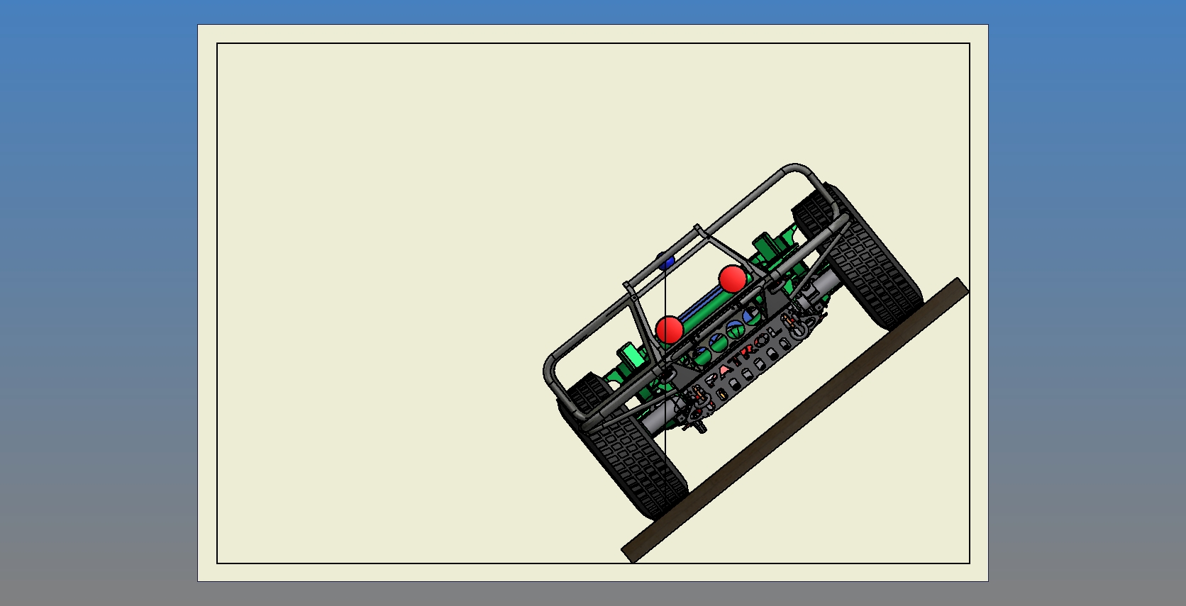

In order to accurately determine the true effect, one would have to accurately determine the centre of gravity. This is an almost impossible task, so I compromised as follows:
Nissan advertise a rollover angle of 48 degrees. Nowhere do they say whether this is measured on the ground or on the body though. So I took my chassis and suspension model and tilted it to 48 degrees, with suspension level. I then drew a vertical line from about 1/3rd the tire contact patch. Where this crosses the vehicle centre line should be close to the centre of gravity. I then added a ball to my model in this spot.
With the ground at 48 degrees, it looks like this:

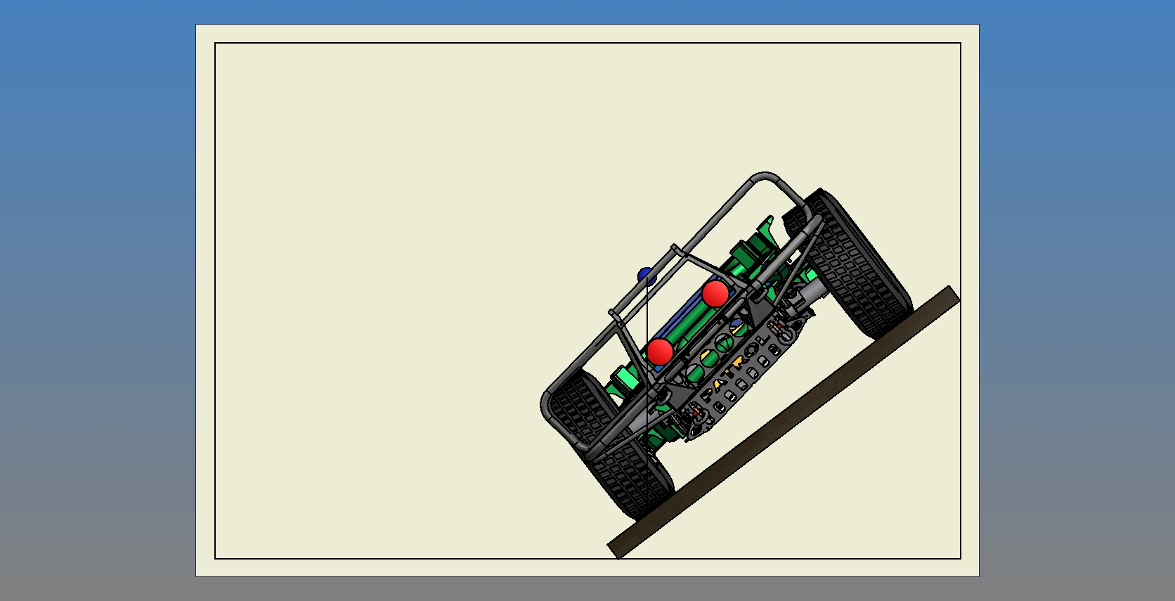

Next I tilted the suspension by 9 degrees. This is approximately the maximum a standard front suspension would allow.
I then drew a line from my contact patch to the centre of gravity, and rotated the whole lot until this line was vertical.
The result looks like this:
The exact angle of the ground is less than 0.5 degrees less, although the body angle is now 57 degrees.

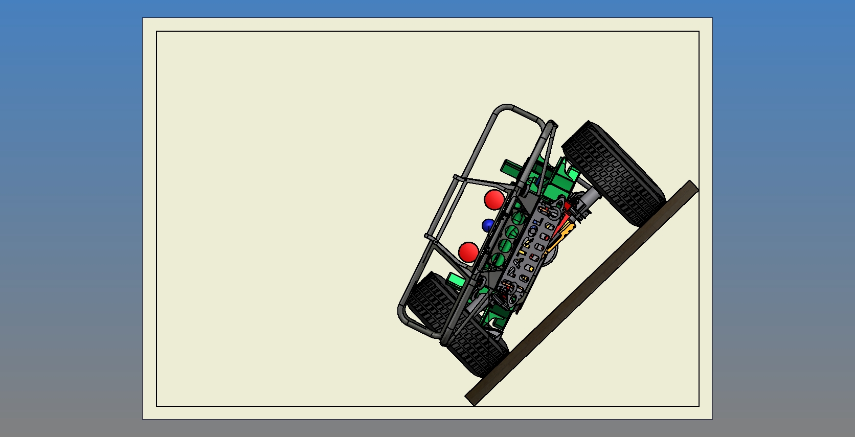

To take this a step further, let's see what adding a load to the roof will do. I added 500kg at a height of 2150mm (ie approximately 150mm above my roofrack), and calculated the change in the position of the centre of gravity. The calculation assumes a vehicle weight of 2000kg. The higher the vehicle weight, the less the CG would change.
With the suspension level, that gives me a rollover angle of 39 degrees:

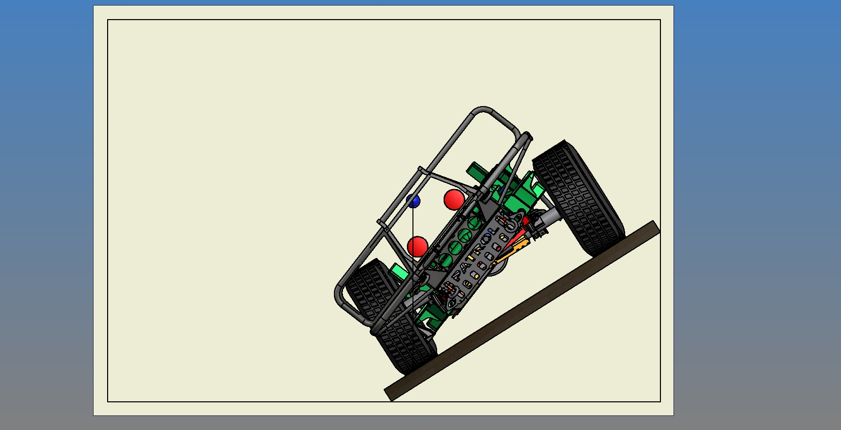

And with the suspension again tilted by 9 degrees, I get 37.2 degrees on the ground or 46.2 degrees of body angle:

The above in my opinion proves that the sway bars have very little effect on when your car will roll, either due to side-slopes or due to evasive manuevres on the road. Obviously the calculations are not 100% accurate, and vehicle mods (lift kits and added weight) will play a role.
However, the worst-case change recorded here is 1.8 degrees between a vehicle that is totally resistant to roll (obviously not true) and a vehicle that is rolled as far as the suspension will go (also fairly unlikely).
Obviously, it will feel different, but that is just perception.

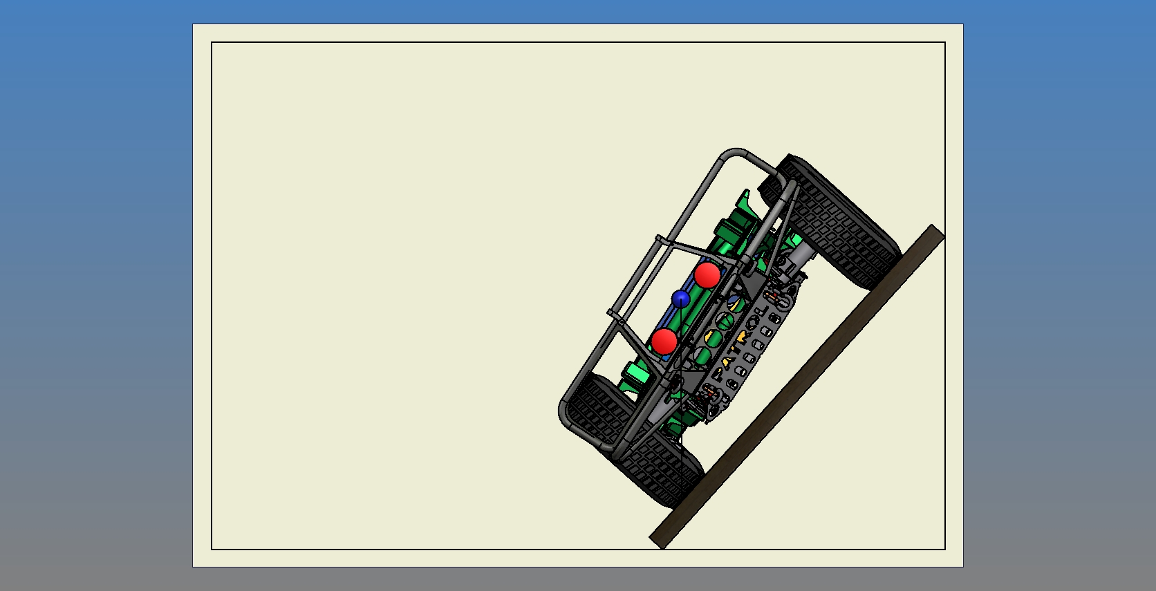

Just to pull the dam from under the duck, I did a similar set of calculations as if the car were fitted with an un-locked X-link and the longest shocks that setup can use, IE 20 degrees of body roll.
Without load, that gives a ground angle of 43.9 degrees and a pants-wetting body angle of 63.9 degrees:

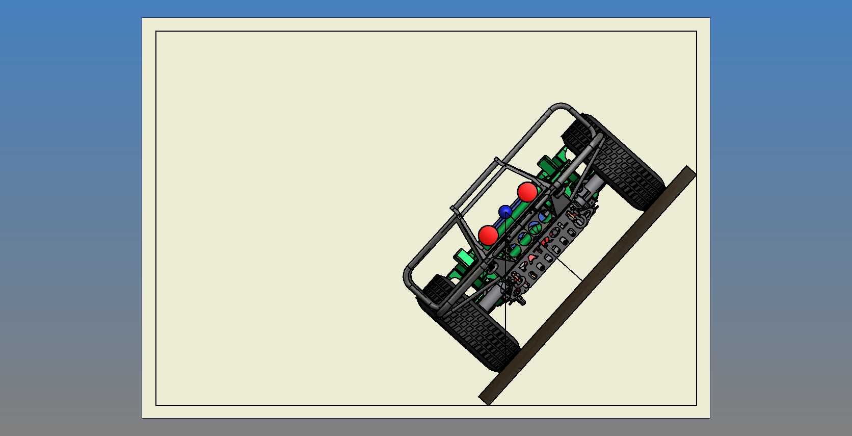

With loaded roof rack, I get a ground angle of 32.2 degrees and a body angle of 52.2 degrees:
So even with this extreme suspension movement, it still only reduced stability by 4-5 degrees.
