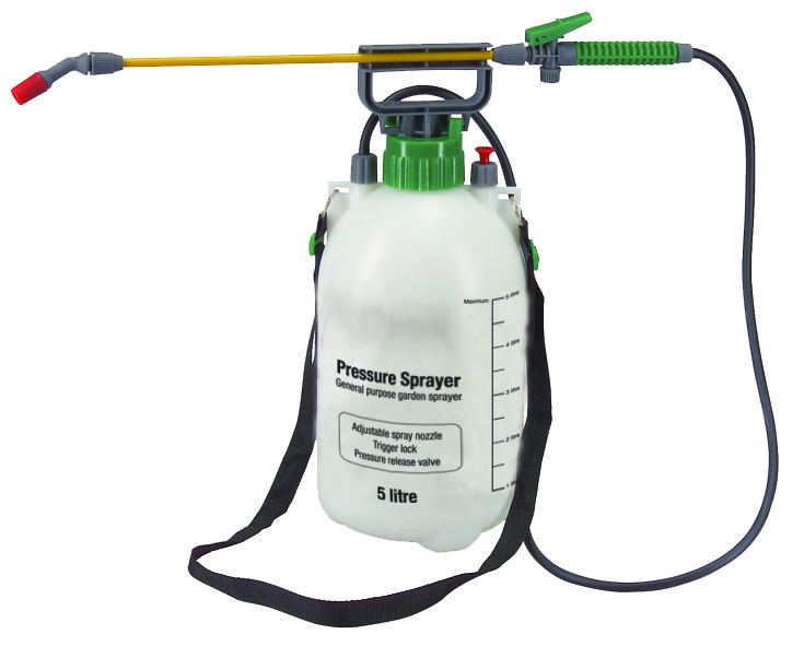

I use one of those Gardena 5L pumps that you use around the house to keep the pests at bay. I just took off the sprey thing in front and now use it to fill gearboxes and diffs......works very nice!
Been thanked: 430 times
Re: Interesting Backyard Mechanic Videos for Partol
One of these, just disconnect the pipe at the trigger on the handle and Bobs your antie

Michael wrote:I use one of those Gardena 5L pumps that you use around the house to keep the pests at bay. I just took off the sprey thing in front and now use it to fill gearboxes and diffs......works very nice!
Dis awesome Michael :salute:
Moes lankal daaraan gedink het :doh:. Het in elk geval moed opgegee om te probeer onkruid spuit :lol:
