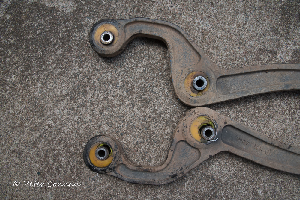

Re: klonk noise on a 4.2 pickup
These bushes gave me various klonks just like you describe:
The klonk comes from the arm bashing into the axle tube.
