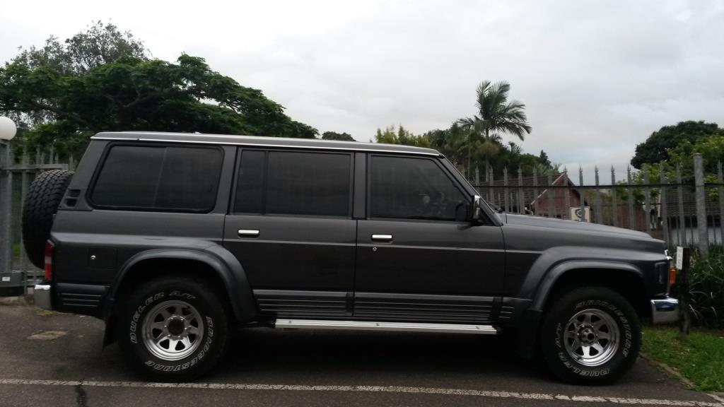

Hi guys,
After seeing all the awesome modified cars in the GQ thread, Ive decided that my initial idea of keeping mine stock standard isn't gonna work for me, I want to mod mine too!
So, can you guys help me with putting a list together of what I should do, and in what order? Baring in mind that the budget is very very limited, so each mod will need to be carefully thought out, and then probably saved up for a bit each time.
My plan is to use the vehicle as an overlanding car - as much gravel road etc travel as possible. I might take it on an actual 4x4 trail/play place once or twice, but definitely not often.
So far Im thinking of first lifting the suspension a bit, and then maybe second, to get some proper tyres (Im a BFG AT fan, but was thinking maybe I should try MTs with this one).
What do you think?
And then just for fun, heres the blank canvas to work from:
What do you think?
