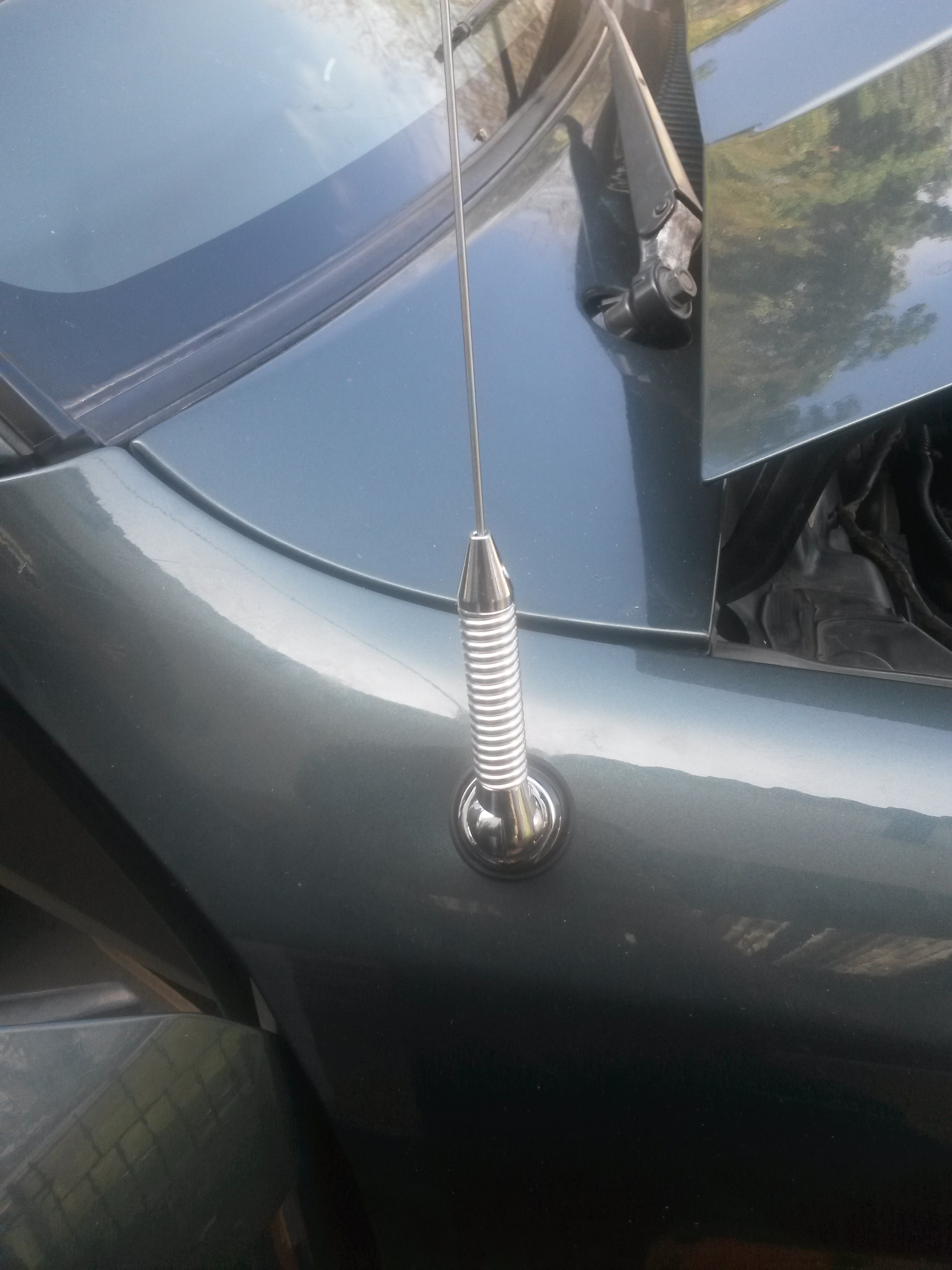

My 29MHz antenna is mounted to the right-hand side fender.

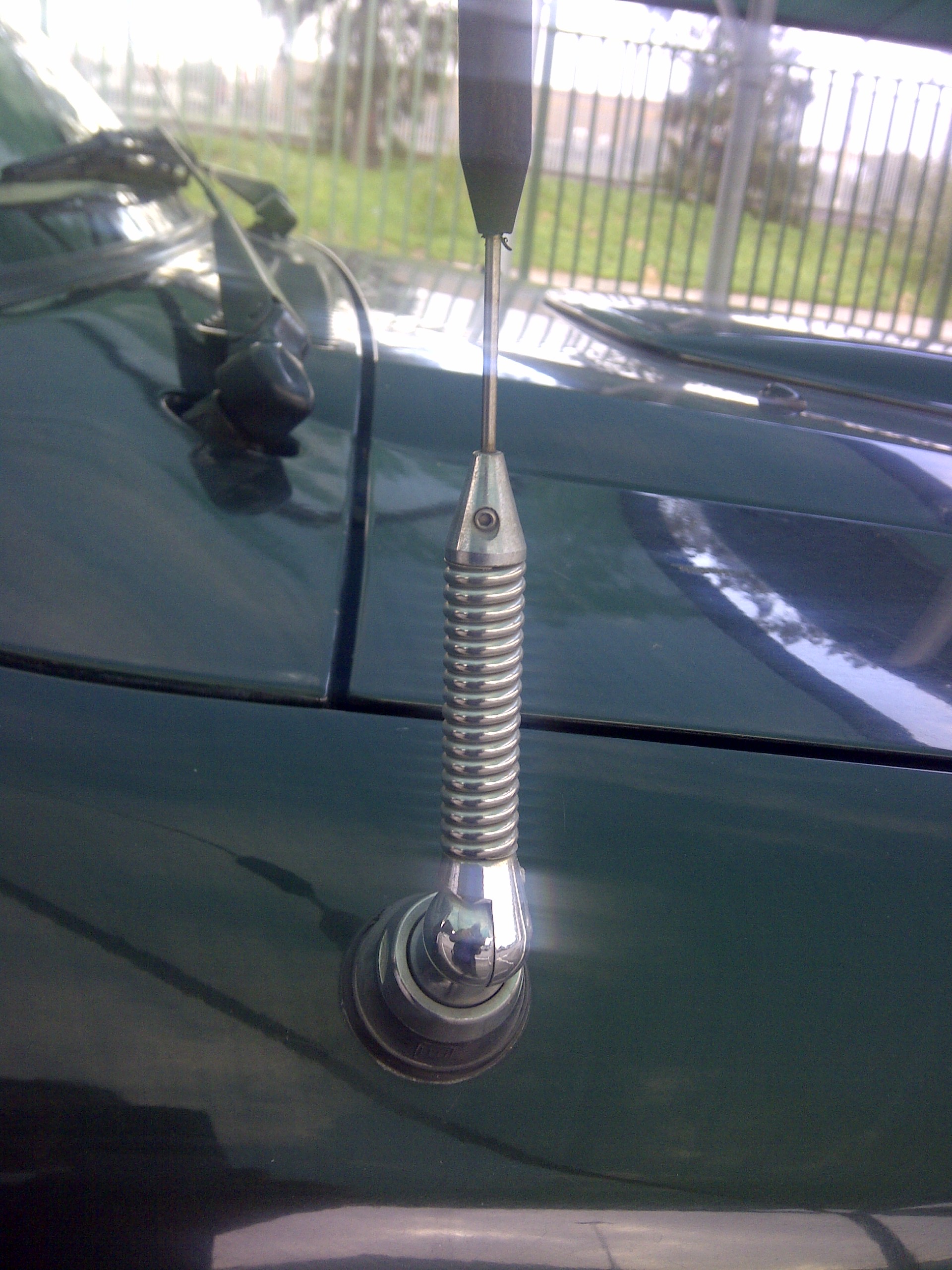

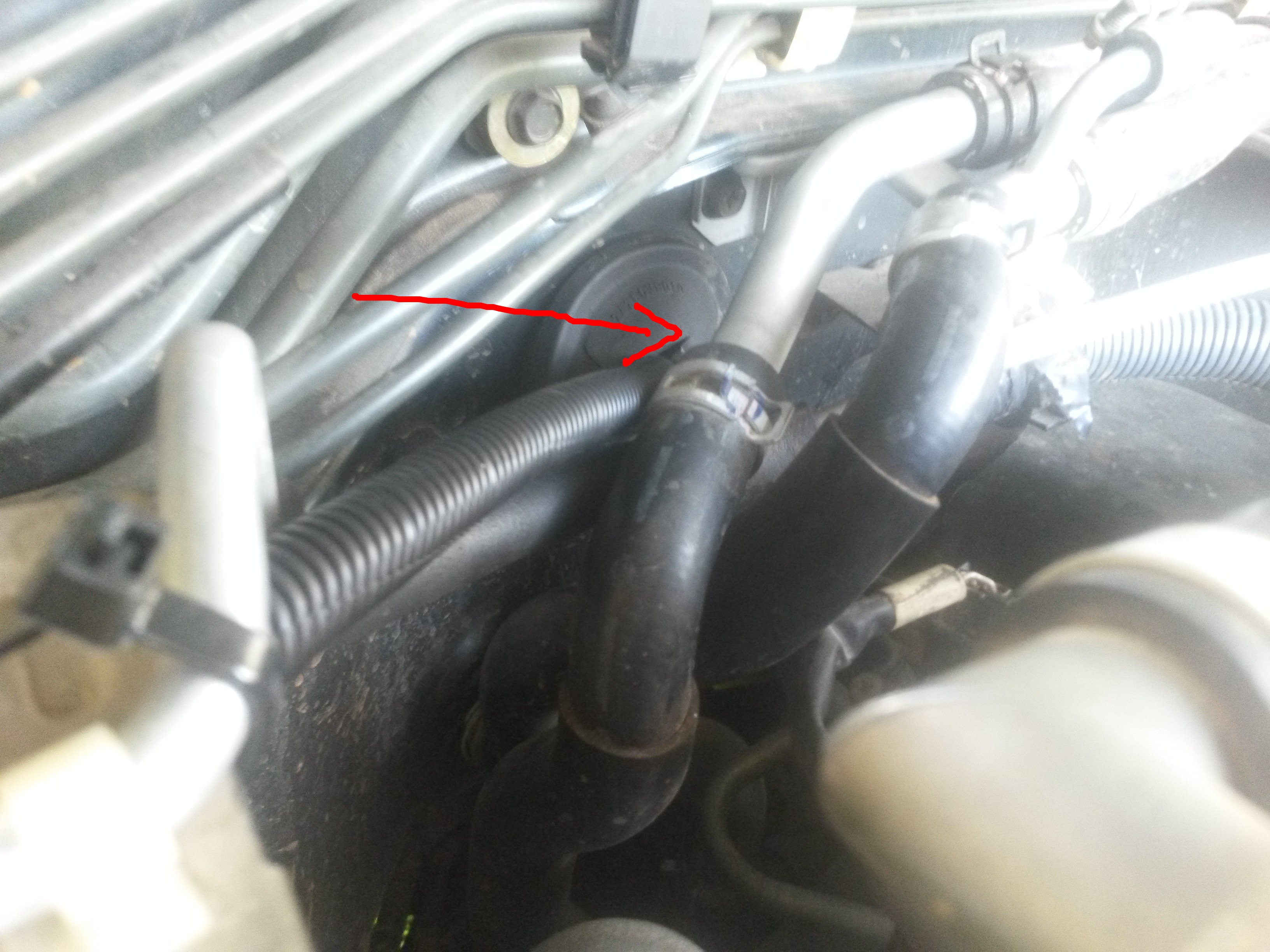

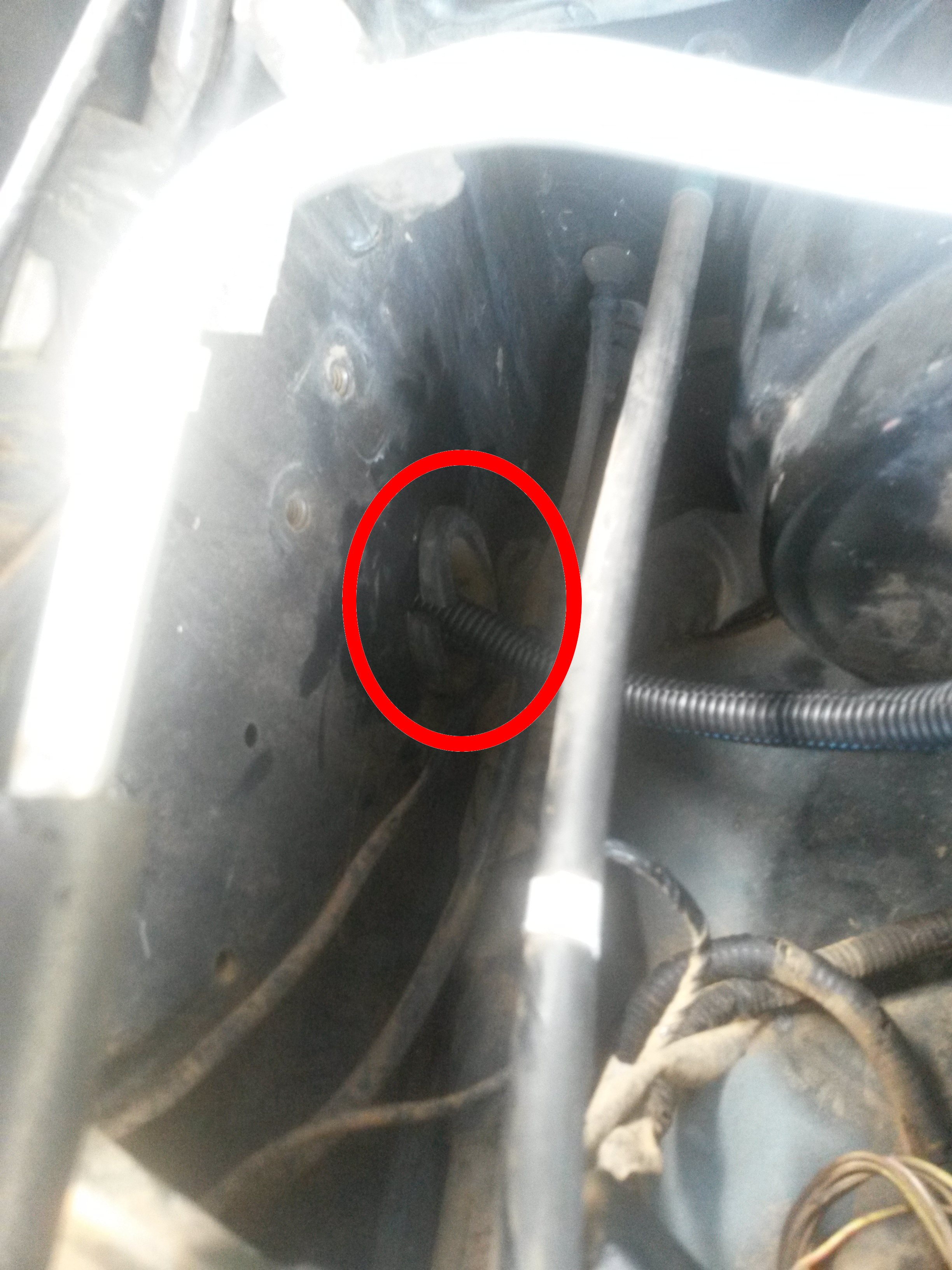

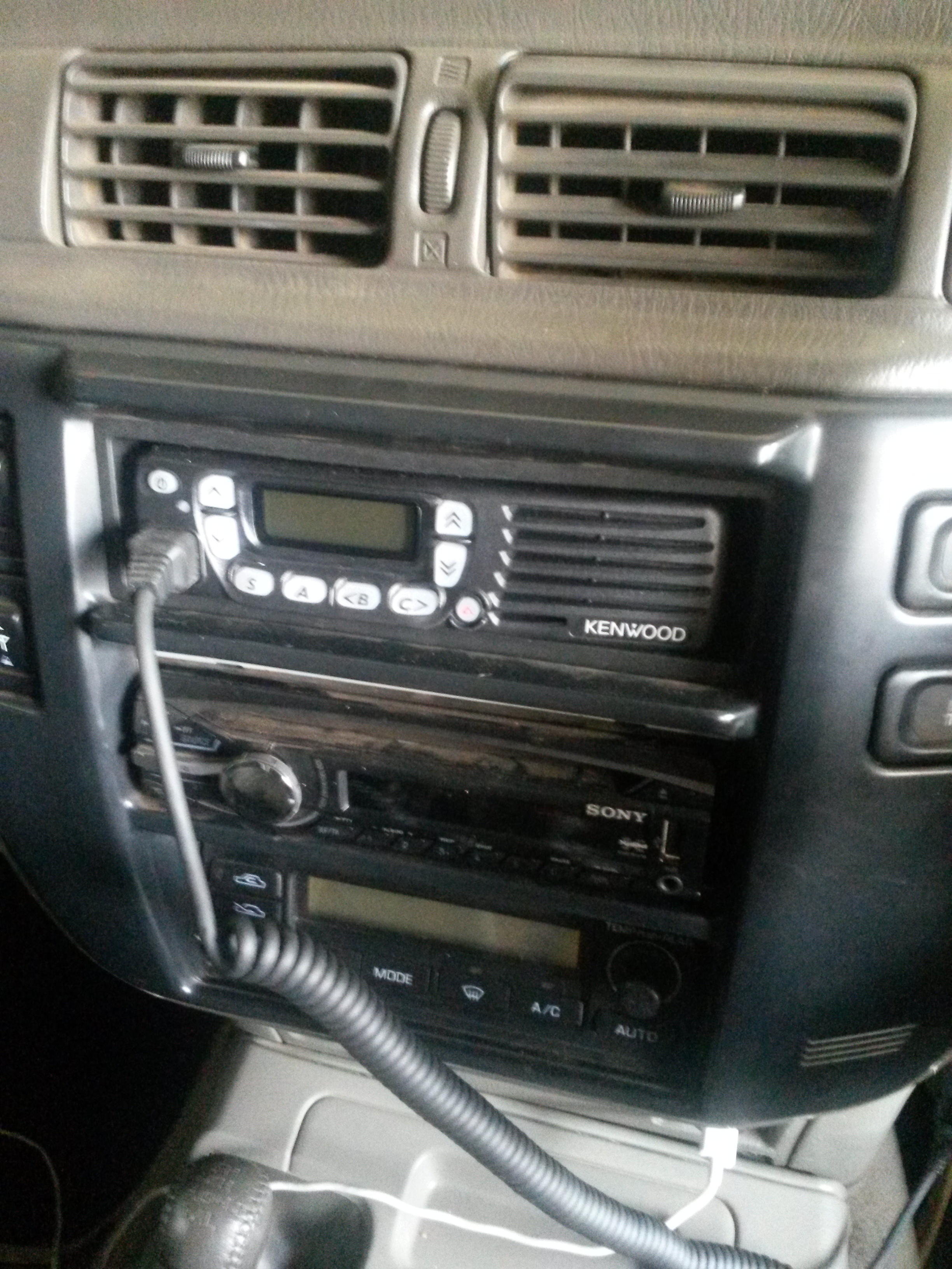

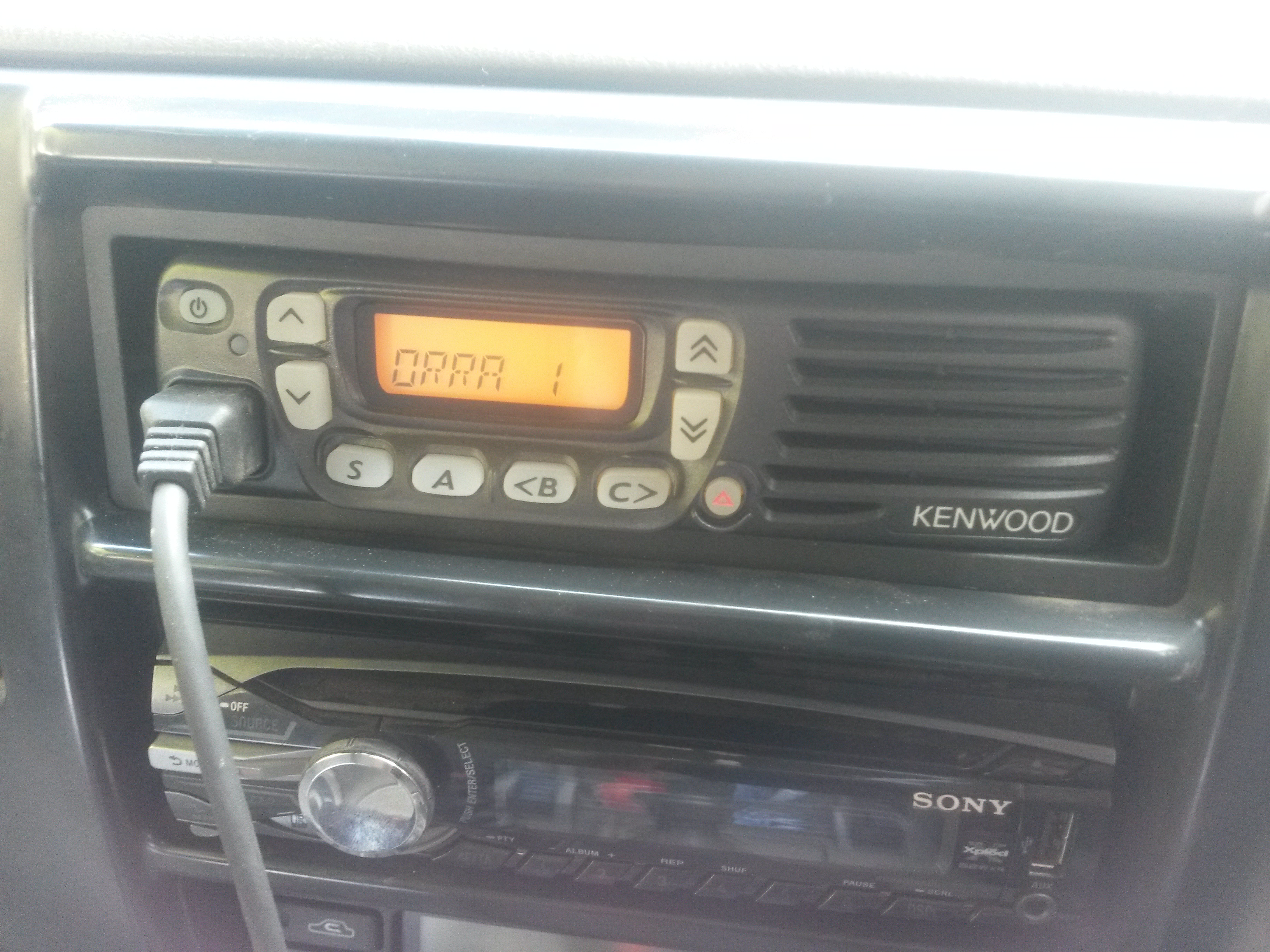

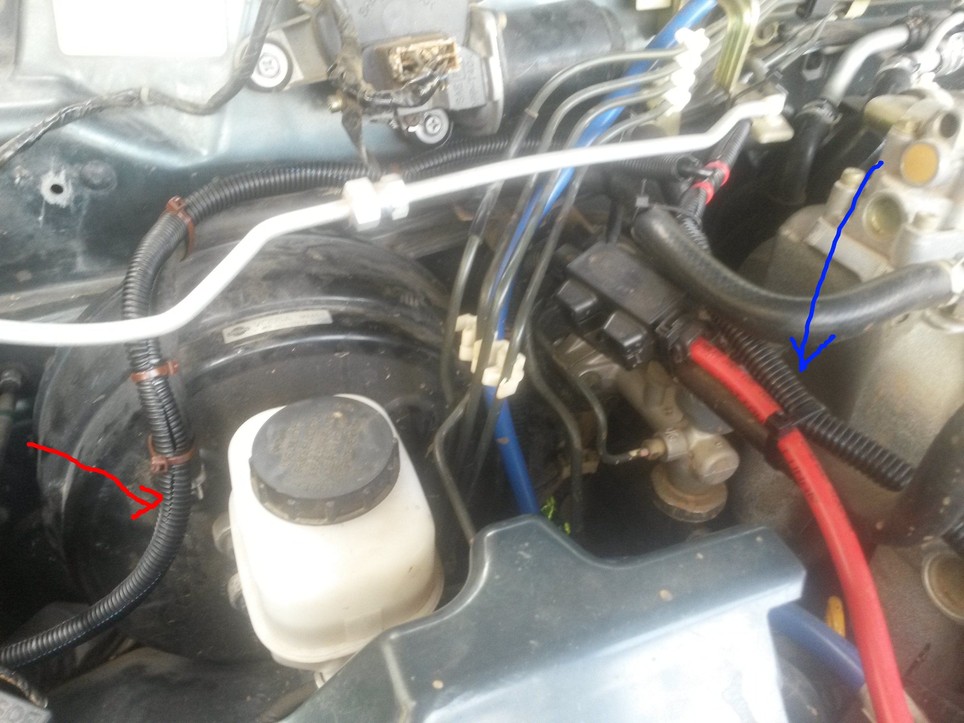

Right - since I got it all sorted, a few photos. I've edited one or two of them to indicate some things, but please excuse my zero-day photoshop skills. I'm terrible with photo editing... :)
1: Antenna was mounted on the right hand fender near to the door where there is at least a slight gap between the cabin and the fender which I could get my hand in to tighten the antenna.
2: Atenna cable was routed through the fender, through a gland where the right-hand indicator cable runs. Sadly, as can be seen, I damaged the gland a bit when routing the cable through it, but I've patched it with silicon and it should be relatively water tight.
3: Antenna (red) and power (blue) were covered in sheathing, and routed through the engine bay.
4: The new radio "harness" was routed through a gland in the center of the firewall which comes out (conveniently) just behind the centre console.
5: Connectors were all connected, and my VHF is now working \:D/
I've not done a range test or anything on the radio yet. However, performance seems to be similar with the Hardbody as I get very good reception on ORRA 8 (no tone) of a security company which is quite a distance away. I'll do a range test at some point to work out exactly how nicely it is all working.
