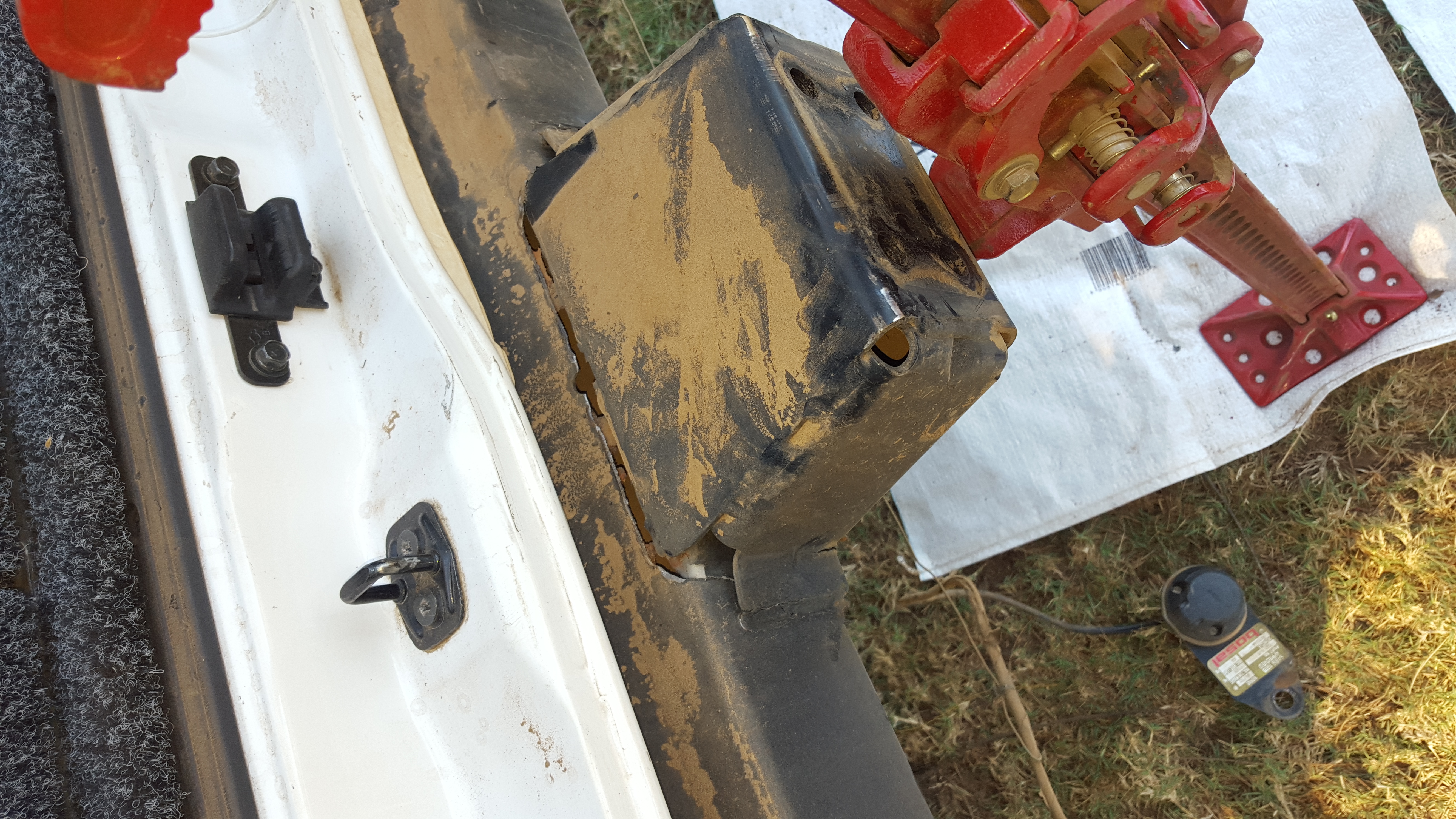

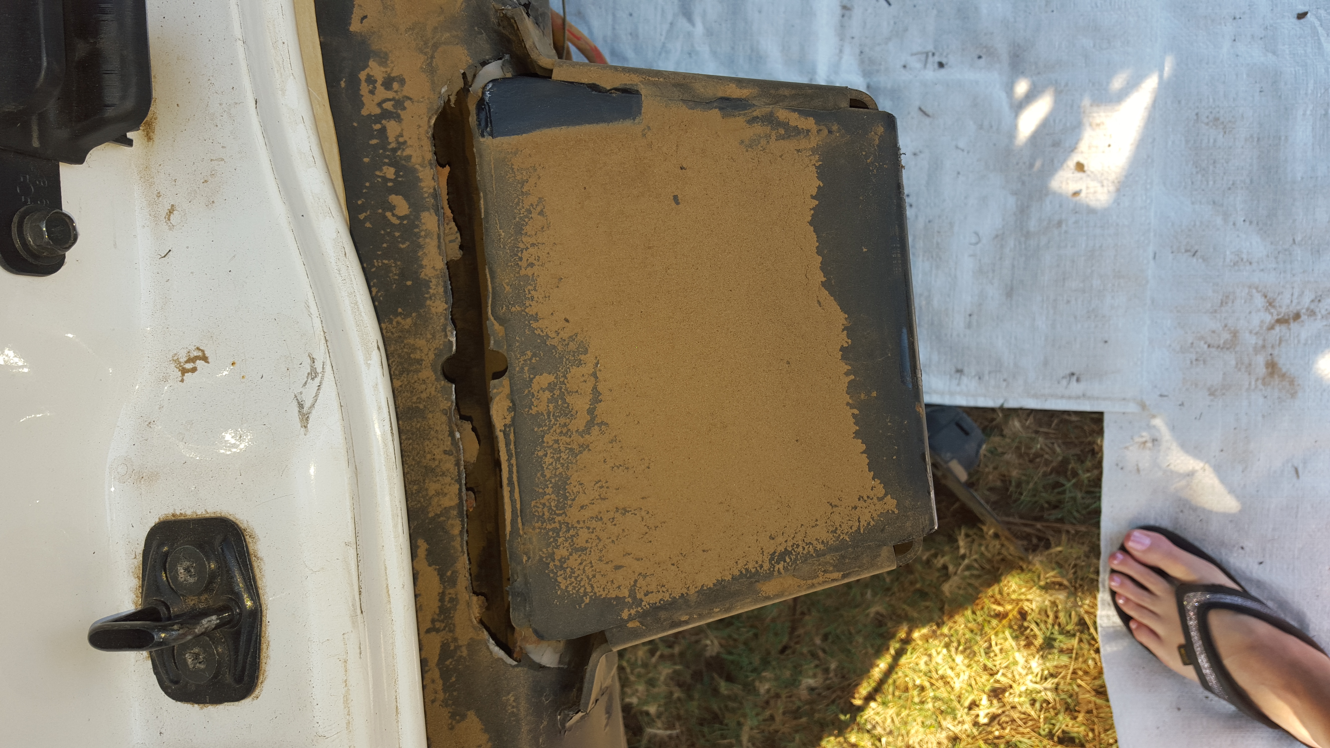

Just a tip, check your tow bracket on your car before leaving home the next time! I had a close call on our recent trip. The actual tow bracket on my Patrol almost broke off completely. I tow a Jurgens Explorer very often and did some serious rough terrain over the last couple of years with it.
My last trip (June) was KNP, Swaziland and into Mozambique via Goba. As we exited the Elephant sanctuary on the way to Ponta Do Oura I got out to take a cool drink out of the fridge. At this stage I noticed the tow hitch was bent severely. I did had a good look and the only plan was to slowly make my way to help - Ponta Do Oura some 30 km away. Fortunately I made it all the way, 3 hours later.

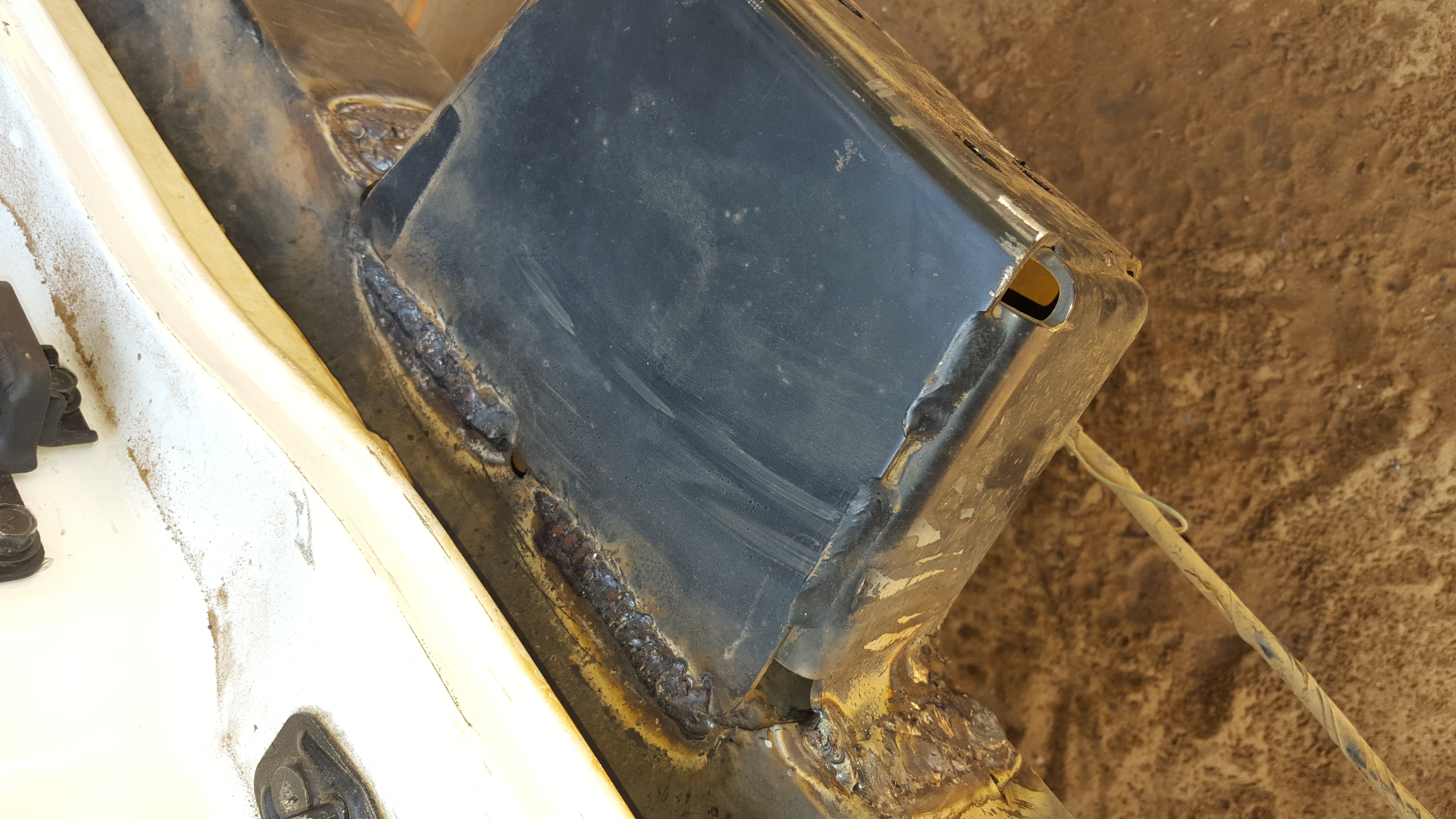

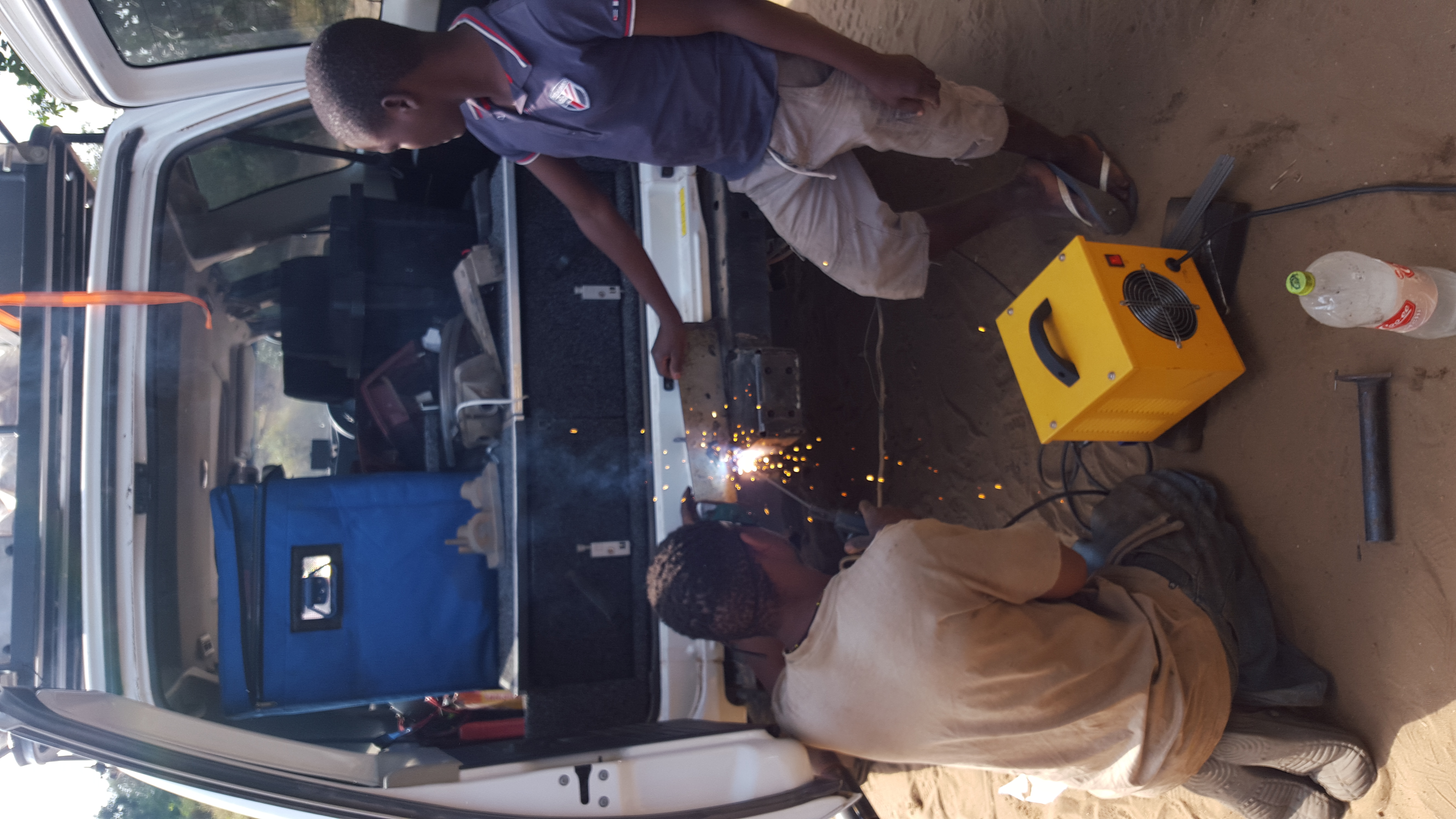

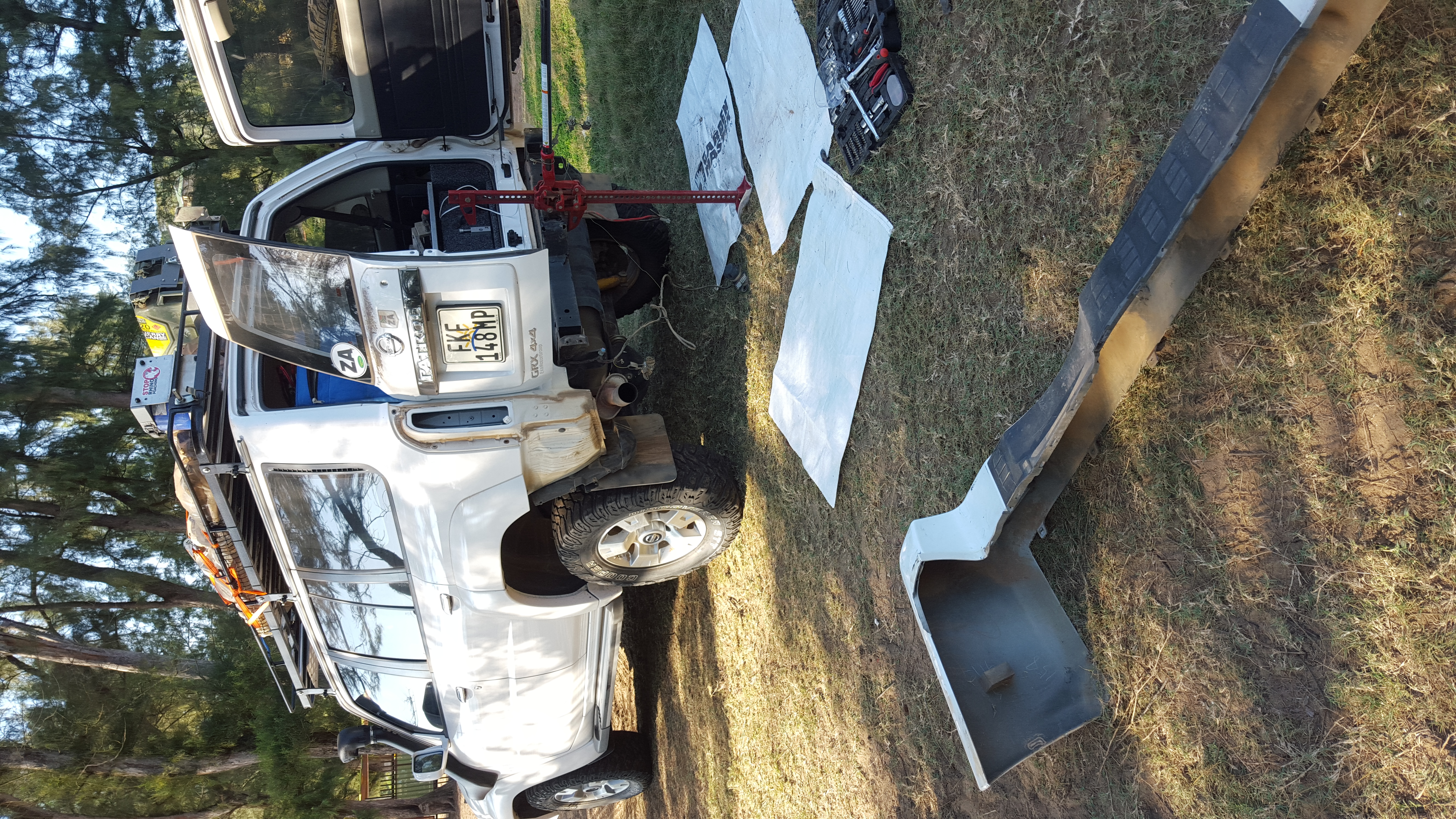

I had to strip the rear bumper off completely at the camping site in Ponta. I used the high lift jack to bend the bracket up again and then reverse the Patrol into a tree to get it spot on in place. The local welder in Ponta next to the market place did the welding (R300). I made it all the way back to Witbank, via Ramsgate and all still good. Next step is to take the bumper off again and get it done properly with CO2 and some proper gussets.

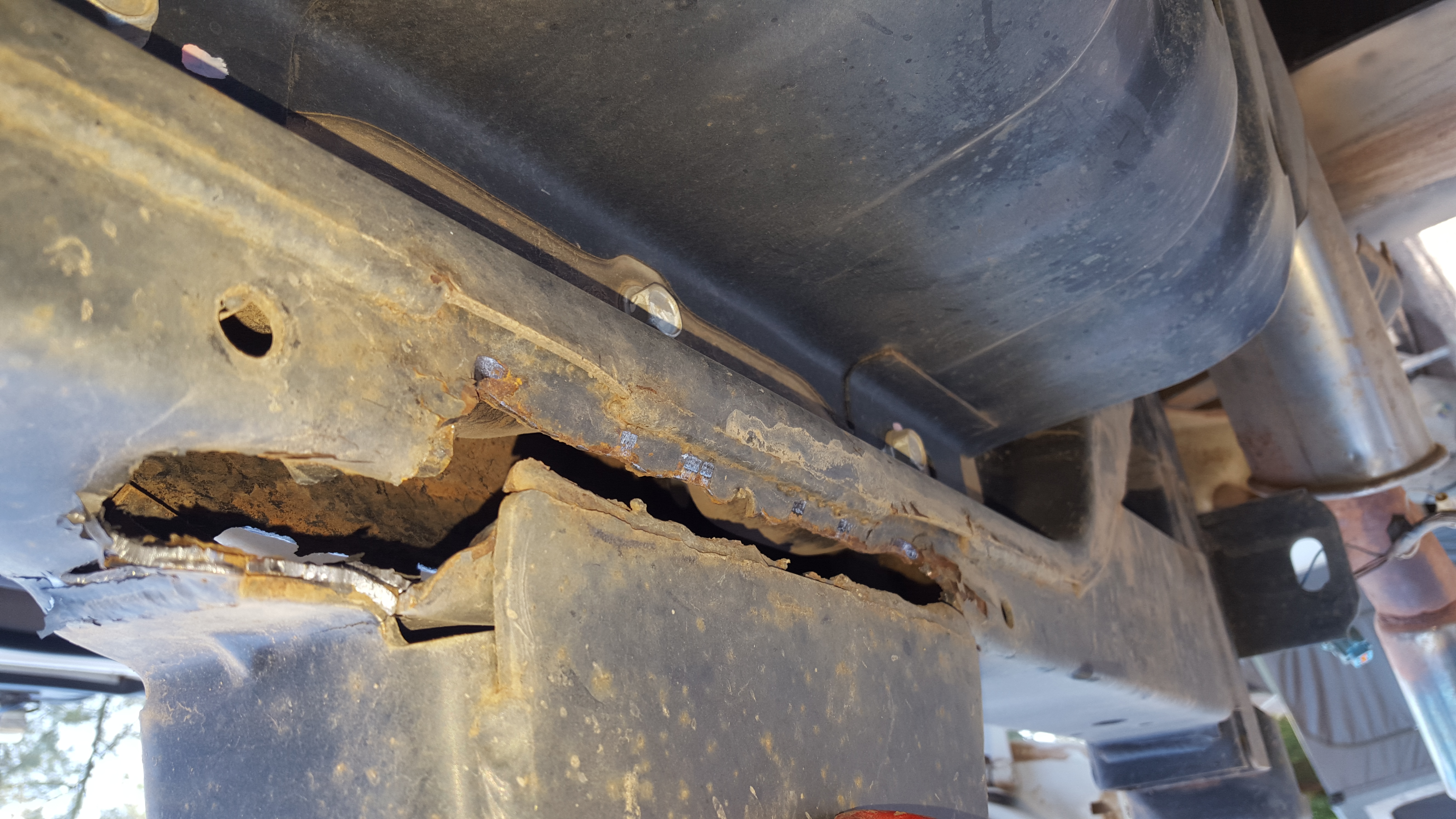

It is quite difficult to see the cracks with the bumper on and only the bottom is visible. It is clear to see on the photos that the crack was formed some time ago. It started at the bottom and all I can think is that this happened when the caravan bottom out on the A-frame and load the tow ball in an inverse / upward direction.
