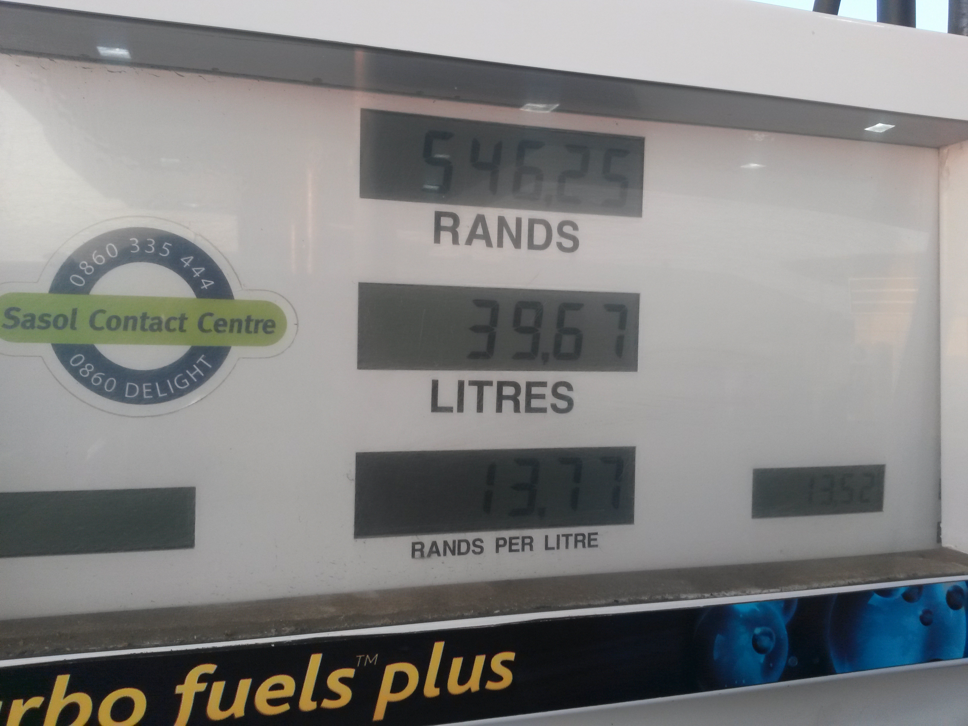

An interesting conversation on consumption and sub-tank capacity appeared on the "Happy Birthday Michael" thread yesterday as a result of my thread hi-jack (sorry). The original thread is here: http://patrol4x4.co.za/viewtopic.php?f=81&t=5582
In any case, as promised, I filled up both tanks today. This time I had them fill the sub-tank first and stood by to confirm capacity. I did not over-fill - basically, I had the attendant let the tank fill until the pump automatically switched off and top it up just a tiny bit more. I put in 39.67L - confirming the manual stating the sub-tank capacity is 40-odd Litres.
In the owner's manual, it would appear as if there are different specifications for the sub-tank. For example, Oz-specs indicate a sub-tank volume of 32L. Not sure if other specification tanks were fitted to ZA-based Patrols. This may result in the discrepancies we seem to have. Alternatively, Alex' comment about sludge and dirt could also be accurate. It would be interesting to know for real what the actual reasons for these discrepancies are.

Great thread Ian
It will be very interesting to see what results come out of this, I will however have a look at my sub tank for the sludge like Alex mentioned.
Just tee keep the stats going I only managed to get 30L into my sub tank and it would be great if someone else with a GL 4.2D can give their numbers.

Michael,Michael wrote:Great thread Ian
I need to fill up today again and will verify these numbers as I did not check the attendant at every filling station in NAM
Please do and post. I guess it is possible that the vehicle may have the oz-spec sub-tank installed (ie: the 32L one). However, please confirm when you fill up...

Reading the threads, it seems as if some people didn't get vehicles with subtanks. This confuses me. I was under the impression that it was standard on all 'trols...
Technically, if you have a 60L water tank being converted to diesel a diesel tank, between the main and the subtank you should have 155L of liquid black smoke...

Some of the Gl's did not come out with the sub-tank. I think it was an optional extra on them. The GRX models have the sub-tank as standard. This is for the 4.5 and should also be on the 4.2D GU.

Re: Sub-Tank Capacity
Marinus,
Thanks for clarifying that for me. I was super confused about the whole thing. Did not realise they were optional extras. I thought they were standard across the board.
