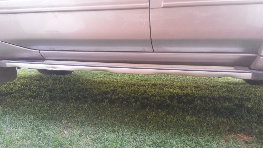

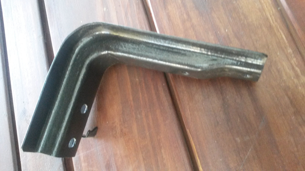

So, as I've mentioned previously, my side-steps seemed to be a little worse for wear - especially post-Bridgestone challenge. Not only were the steps (depicted below) a little beaten up, but the brackets attaching them to the body also looked a little rough when I removed them.
So, after removing them, I started by stripping off the old paint on the brackets, and refinishing them with a few coats of Hammerite. They look almost brand-new now.

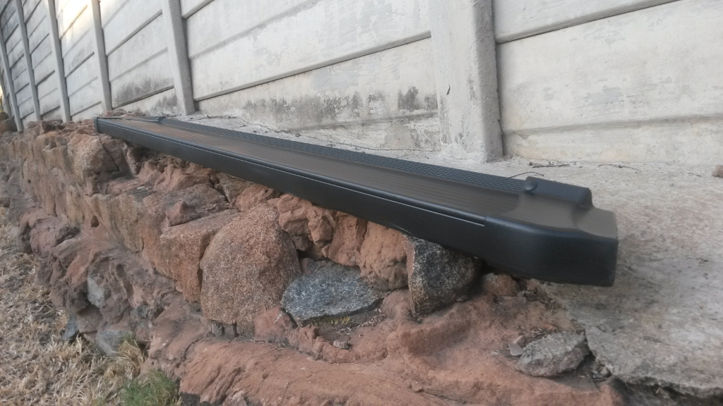

Next step was performing some old-school panel beating and removing the dings from the aluminium and quite a few coats of plastidip.

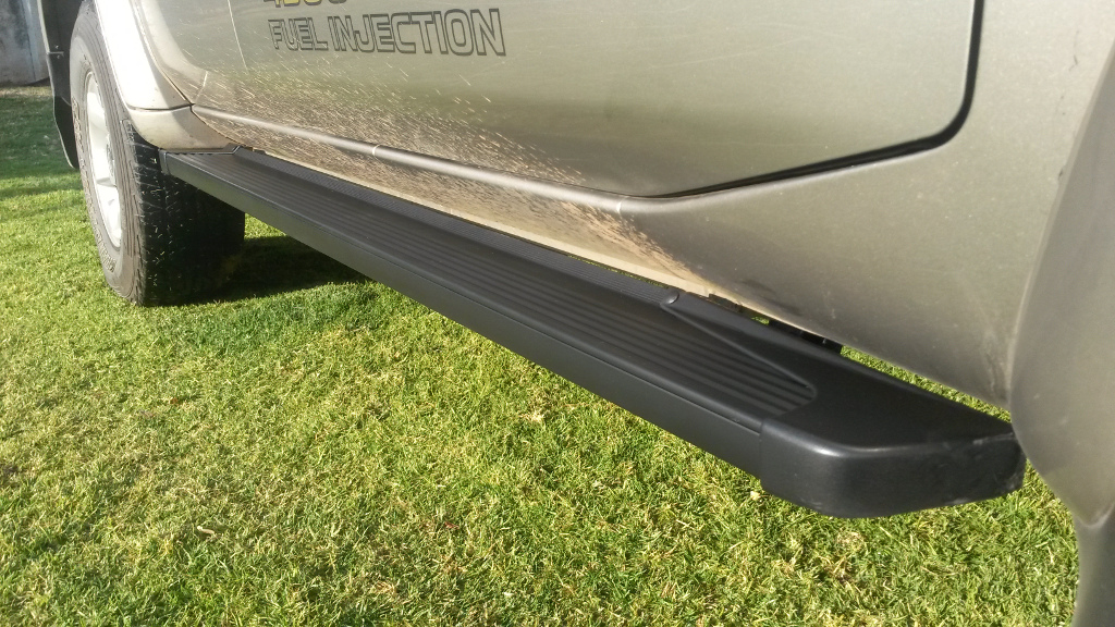

Finally, refitted - they look almost too new for the truck.
I'm unsure as to how well the plasti-dip will wear on the steps, as they normally get trodden on quite a bit by the kids. I am, however, very happy with the end results. Hopefully the dip will last until such time as I upgrade to a set of rocksliders. :)

They're still going reasonably well. Surprisingly well, actually.
I should mention that, with my small kids and my short wife (I never said that - right
There was a bit of deterioration where the plastidip was sprayed over the black insert on the corner of the running boards. I assume the plastidip does not bond as well with plastic as it does with aluminium. What basically happens is that it "peels off" a little on the plastic insert. One does not really notice it, and after a day or two, the peeling bits drop off. After that, one does not notice it at all, as the exposed plastic insert is the same colour as the running boards.
Sadly, I cannot post photographs, as I am working in the Cape this week and the 'trol is at home. Will do so over the weekend.
Would I do it again ? I'm not sure. It was not a lot of effort. I'll be honest and say that "next time" it's necessary, I'll invest in some rock sliders...
