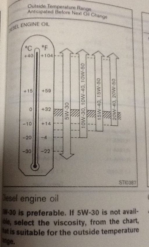

Re: Best Oil - 4.2ti High Mileage
From the manual..(attached pic).
What viscosity is delo 400?

Re: Best Oil - TD4.2Ti High Mileage
Delo 400 is a 15W40
API CI-4 PLUS
