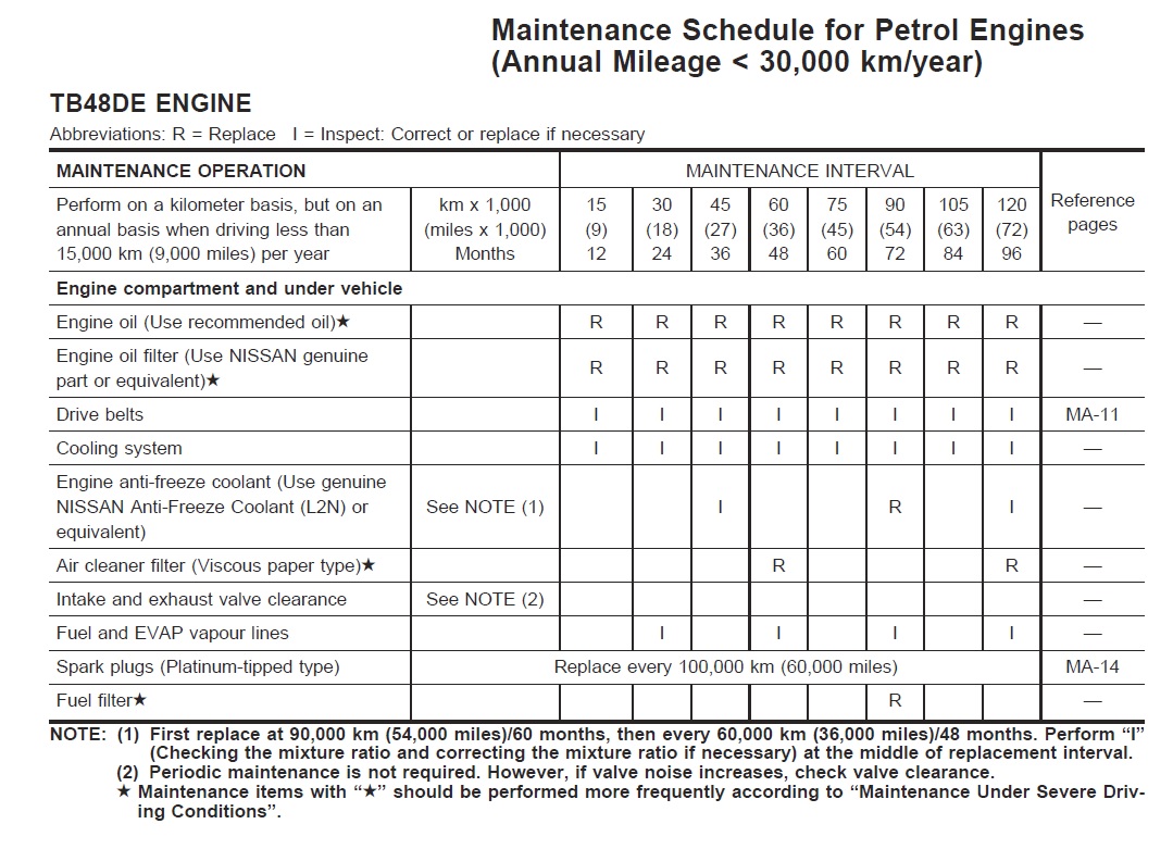

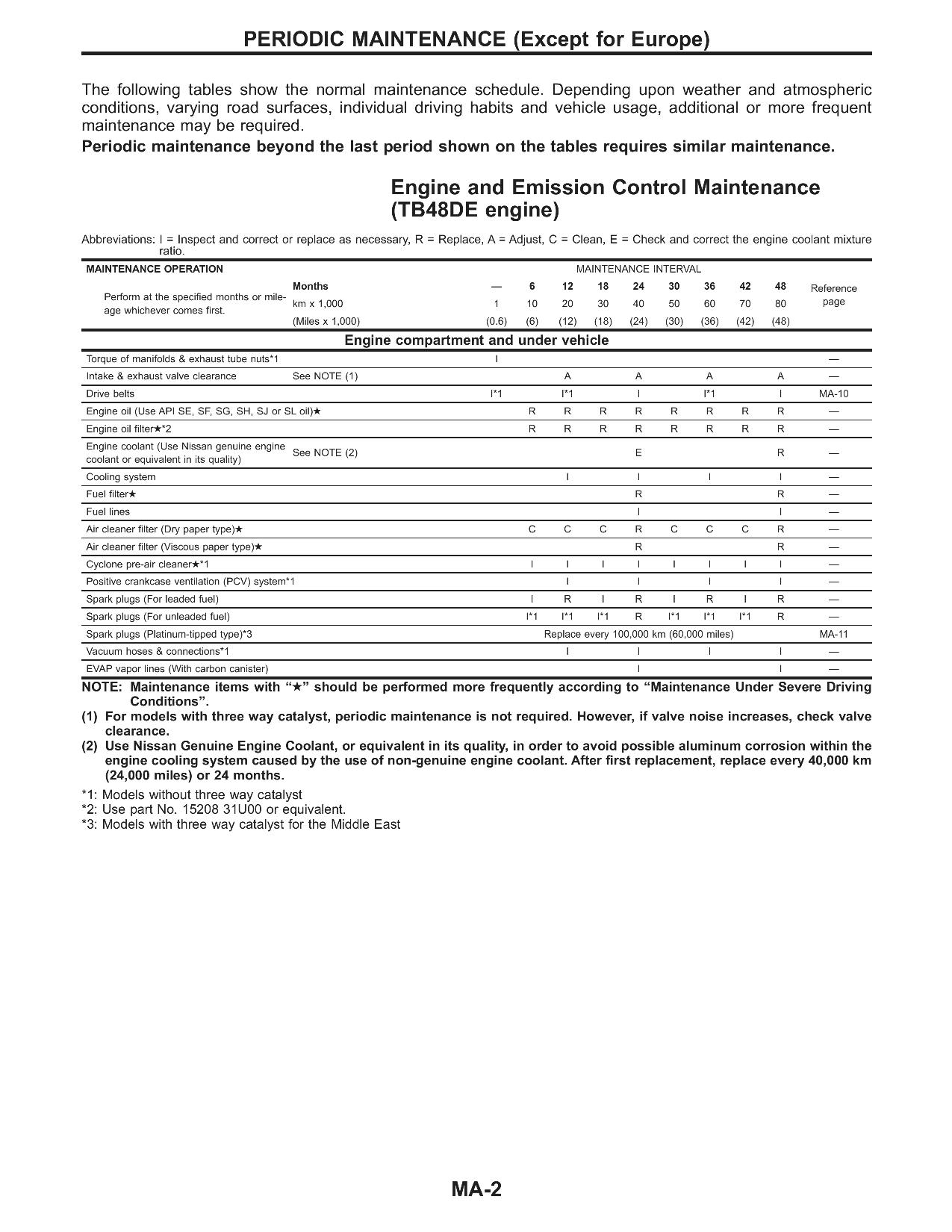

Re: TB48 oil changes
Hi David,
I think you have the maintenance schedule for Europe there. I am looking at supplement VI (2002) and schedule for rest of the world except Europe. The intervals are 10,000kms. Although the service manual does not recommend a particular grade of oil, but the owners manual does say 5w-30 for sure. Although I just noticed your location, Stellenbosch, and perhaps the weather is similar to Europe, but not as a cold. Great place you stay by the way.
Just talked to my friend who is a Patrol specialist here, and he recommends that 20W-50 every 3000kms, 10w-40 5000kms and 5w-40 every 10,000kms .
Yes it's the European & South African schedule! I forgot you are in the land of sand
Personally I think the full synthetic is overkill for a non turbo car and the milage between services can be extended (depending on your driving style).
Best will be to have the oil analyzed after 10k, 12.5k and 15k
