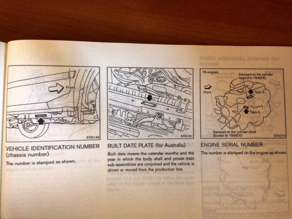

I just checked my patrol and the VIN number is on the chassis as per pic ST10148

Thanks Noel for the information, but alas, mine is in neither of those positions.
