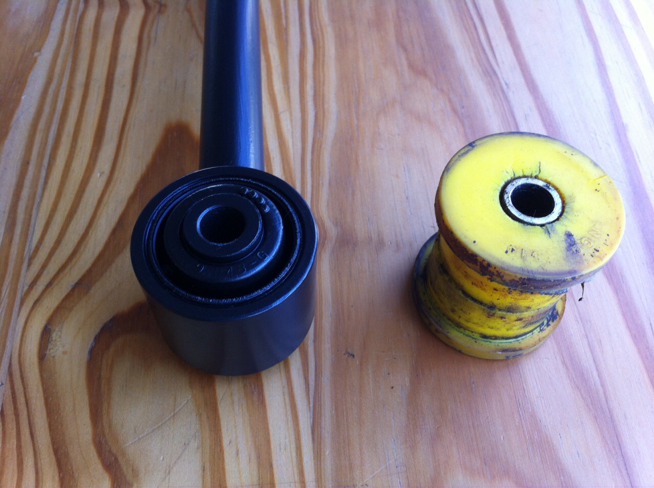

My experience using polyurethane bushes has not been good. I suggest you look at the Australian Patrol forum before purchasing any new bushes!!
The Aussies refer to them as polycrap bushes, need I say more. I have recently fitted original Nissan rubber bushes to the upper and lower rear suspension control arms of my GQ Patrol as the polycrap bushes were all breaking up...the back bottom right bush completely disintegrated and the metal to metal clunk made me aware of the failure. The other seven control arm bushes that I removed were all badly cracked and worn. I will try and upload a photo of the bush that was in the best condition....pity I never took a photo of the worst bush!!
I regret ever having all the suspension bushes changed to polyurethane bushes as now I have to remove them all and fit genuine rubber bushes at a substantial cost.

What did you pay for the genuine bushes if I might ask?Daniel wrote:My experience using polyurethane bushes has not been good. I suggest you look at the Australian Patrol forum before purchasing any new bushes!!
Tx
