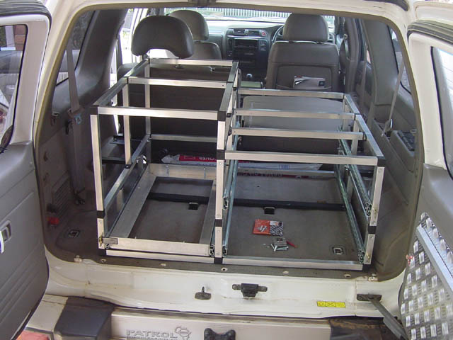

With the "connect-it" system you can make a frame of any size and then have a drawer made to fit.

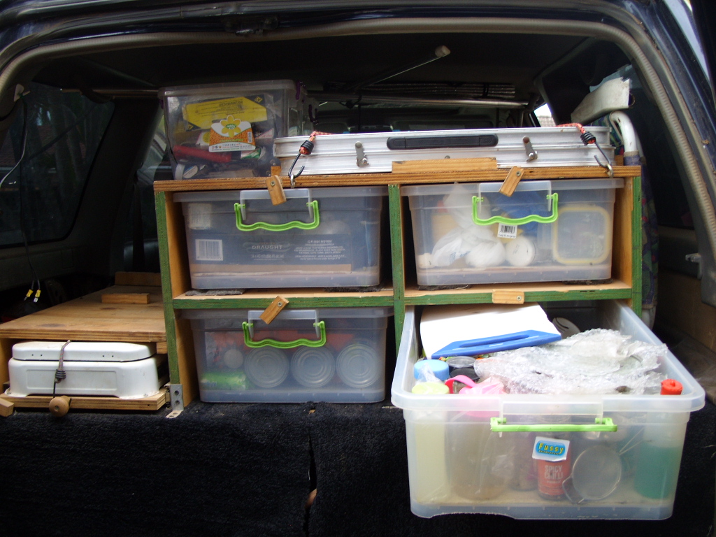

Hi Biggles. I built my own drawer system and am sure the draw would clear the small door if it was put in differently to mine. The draws are on wheels and there is carpeting inside to prevent the wheels wearing away on bad roads. I have had the system for around 3 years and traveled extensively. I bought the plastic draws from a plastic shop in Durban. They came with lids but I have never used the lids as everything stays put. I used a few beer cardboard carriers to act as baffles and keep everything in situ. The plastic draws can also be cut down width wise to make them even narrower. They also come in varying sizes. The rest is just a wooden housing and unbelievably dust proof, all sitting on a platform. When the draw is pulled out, the wooden top keeps it in place, unless of course you pull it very far out. Beneath the platform I have two 60 litre water containers and on the left of these, a ammo box of spares and a big tool box. As you can see, the stove pulls out with ease through the narrow door.
Hope this is of some help.
Regards.
Barry
Regards.
Barry
