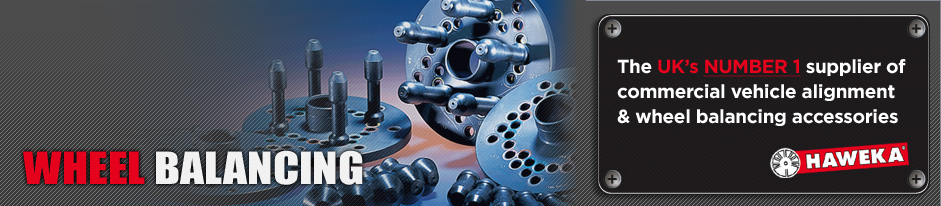

What is the finger adaptor ? I have read thet the shops must use a honeycomb when balancing Patrol rims

See attached pic, I can see the refrence to honeycomb from the plate with all the holes

Nope not the holes type the shape of the cone must me honeycomb shape
