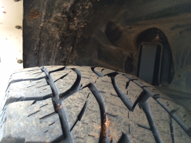

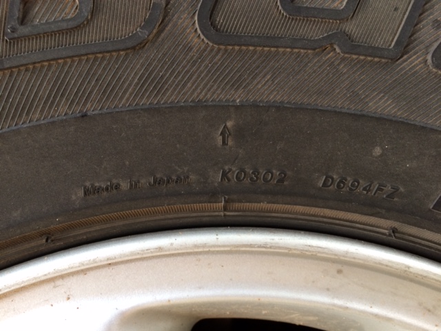

I am a bit unsure about my tyres. They are Duelers 694 (which are not ideal, i know).
Now I wonder as there is not DOT-number if the number I took a picture of tells me the tyre is manufactured in 03/2002?
And what do you think: is the tread still ok, or would you replace it?
If the tyre is from 2002 I'd have to replace it anyhow....

If they are from 2002 they are slowly but surely turning into crude oil again ...lol..deflate to 0.8 bar drive around the block at a modrate speed have a look for cracks in the rubber that will give you the info you need ...to spend 20k or not hope it helps

In the meantime I went to the local tyre dealer and he had a look - the dot number is on the inside of the tyres!
So he could tell me that all four tyres are from 2008. Six years at least don't mean an emergency I'd say. So I think I'll drive them a year or so more.

Most guys say you have about 8 years on a tire but imho it all depends where and how...if your tires are at 30 deg most of the time in the sun gives them a bash . If you are in guateng is much dryer than natal ...wat I am trying to say is deflate have a look for cracks that will give you a good indication on condition

The tread on your pict still looks good for 30 - 40 thousand KM [if i read the picts correctly]

I don't think that is the date code.
That lettering seems to be a permanent mold feature, whereas the date code needs to be replaced often. This is done by using a replaceable insert in the mold, which leaves an oval or oblong "pad". Look for this, and the date could should be in that.

To my understanding:
In Germany you must by law replace the tyre when it is eight years old (This I know for a fact).
In South Africa you must by law replace the tyre when it is five years old. (I stand to be corrected, but this is the way I have it.)
If the tyre dates from 2002 it is in any case way too old and you would be well advised to replace it. In SA tyres are prone to perishing due to UV exposure and other adverse ambient conditions/factors.
