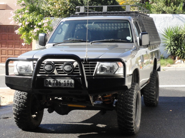

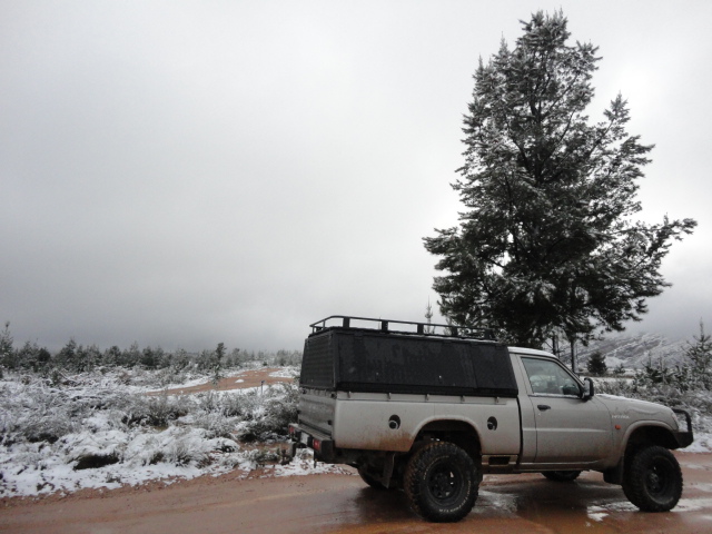

Exactly.Easys wrote:Ok - so these odd few 4.2td's floating around are really a option with re power upgrade while retaining reliability.
Visually the 79 LC often looks better from certain angles, but the patrol can also turn out quite nicely if you so wish.
Mine:
- DSC07443.JPG (140.54 KiB) Viewed 6859 times
- DSC06773.JPG (144.67 KiB) Viewed 6859 times
