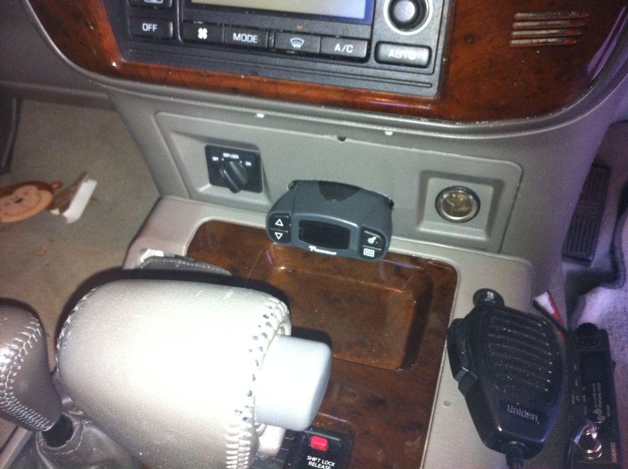

Cedric, sure you would know better than me as you have one of those dead slow diesels, but was that not the location on the GQ not on the GU models
- Been thanked: 473 times
Re: Limited Slip Diff
I found this pic on the net of a GU that has same layout as mine.
Don't know what that thing between the difflock switch and the cigarette lighter is though
