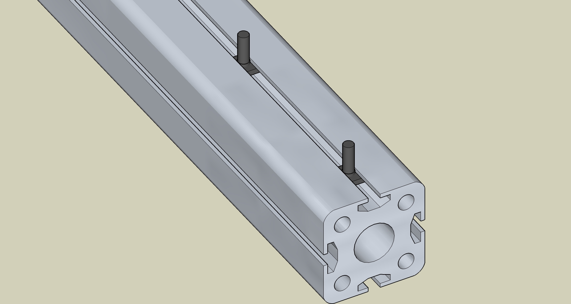

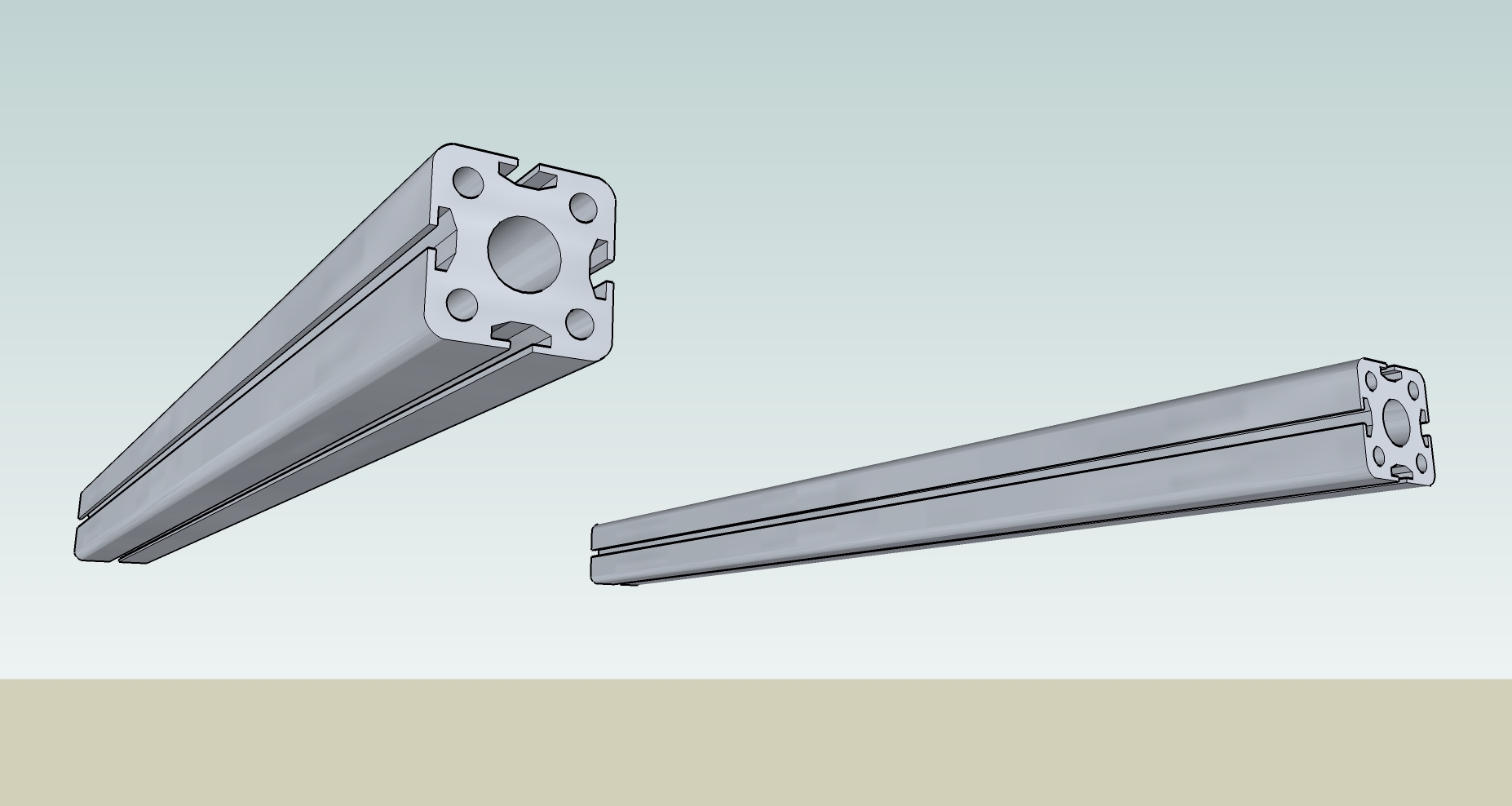

You can get aluminium extrusion like this. I am going to do this to fit my RTT on my roofrack ( one day when I get some damn time ). If you get two of the same length running from front to back, then if the RTT needs to move forwards or backwards its just a matter of loosening the slide bolts that connect the RTT to the channel. The bolt will then slide in the channel ( with a bit of a push I think ). I think this will be the easiest way. unless you want ot buy some fancy shmancy gadget with a big price tag.
50x50 Ali Extrusion.jpg (252.37 KiB) Viewed 3362 times
50x50 Ali Extrusion 2.jpg (284.25 KiB) Viewed 3362 times

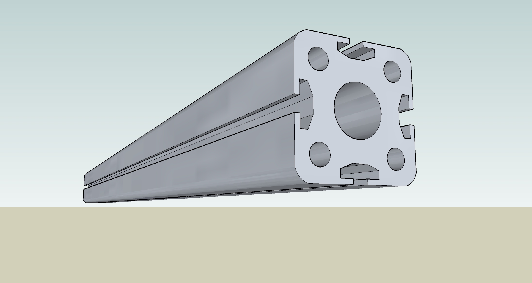

found a pic with the bolts...
50x50 Ali Extrusion 1.jpg (263.65 KiB) Viewed 3360 times

What size bolts can this extrusion take? would think that one cant go smaller than an 8mm bolt on a roofrack to ensure it is properly "tied" down?
Following that, one then needs to open the tent, remove the matress and floor and then loosen the 4 nuts, and then slide the tent where one wants it? Sound like it can work :thumbup:
When are we doing this :oldtimer:
Been thanked: 473 times
Re: Moveable rooftop tent on roofrack
What size nuts you have..... I mean what size bolts you need.... Not too sure, but depending on how your RTT looks on the underside can make it a little easier. Mine has a steel square tubing frame attached to the RTT. This I believe is to mount it to a trailer lid. On this steel framework there is a flat plate with two holes each side where the bolt from the aluminium extrusion fits into. That is what hold the RTT to the extrusion. I seriously doubt that it will fall off. I've had mine fitted with only 4 smaller bolts and done Rust de Winter, Serindipity and a few other challenging places without ANY issues. I'm not an engineer, but with that in mind the only forces on a RTT are wind sheer forces and a minimal amount of flex and that's pretty much it. So unless you have a head on collision where I doubt some serious bolts would even pass the test you should be ok.

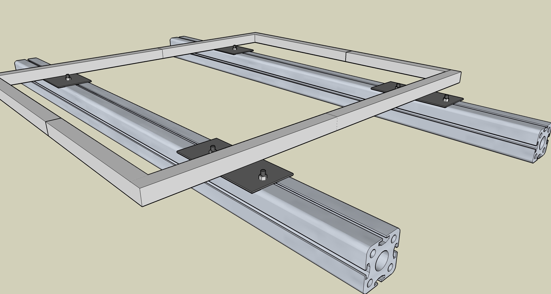

something like this ....
50x50 extrusion roofrack.jpg (419.7 KiB) Viewed 3340 times
What length would you need?
What height would you need?
My roof rack has a railing around it so I need the bottom of my RTT to be flush with the top of the roof rack rail to allow the tent to open fully.
My rail is about 100mm high and the square tubing frame takes up about 45mm so I'd need a 55 - 60mm extrusion on mine.
