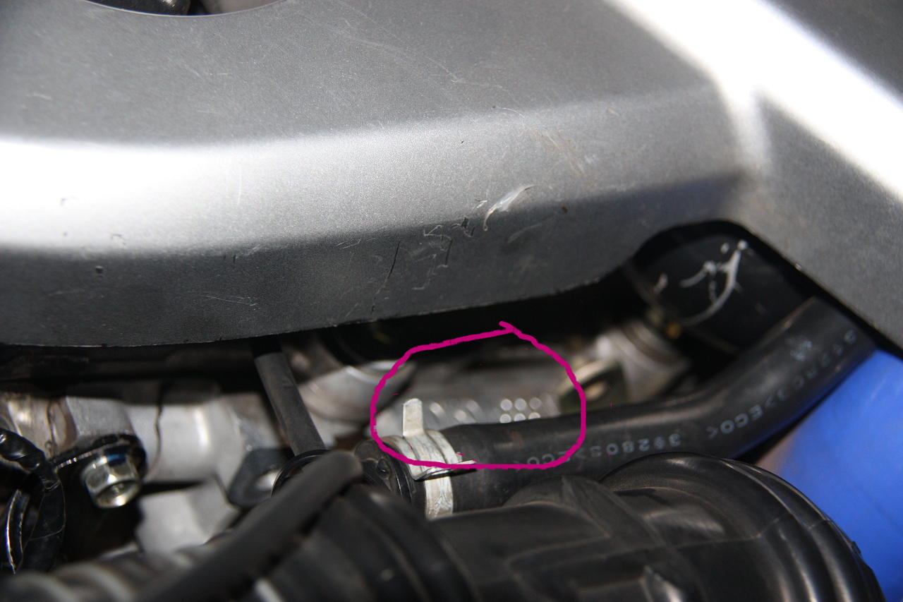

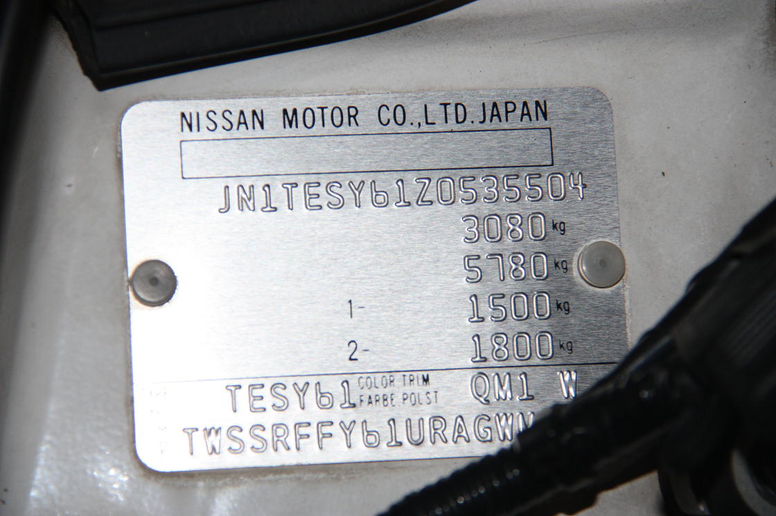

Rob Green put in a brand new cylinder head, I think that's where I can see the number - also, the plate rivited in front of the driver has no chassis no. on it. Hang on, i'm gonna take a pic of the plate and post it in a sec.

Tony take the invoice of the new head and the car papers to them let them stamp it.....

I'm going to RGM tomorrow anyway to do a full service, repair two "oil sweat's"; sort out my sticking clutch and repair/replace of the load sensor that you organised for me. I will arrange all the paperwork as well.
I have taken a pic of the identification plate, and one of the area where the "engine no." is positioned - sorry the number is not focused, but I have put a ring around where it is.

That number that starts "JN1....".Tony wrote:Rob Green put in a brand new cylinder head, I think that's where I can see the number - also, the plate rivited in front of the driver has no chassis no. on it. Hang on, i'm gonna take a pic of the plate and post it in a sec.

The long number on the plate starting with JN1T is the VIN (or chassis) number...

Ok.. if JN1T... is the chassis no. then that clears up that issue, and as Tinus said it is also on a plate on the dashboard on the passenger side just behind the windscreen. Thanks for that Pete.
