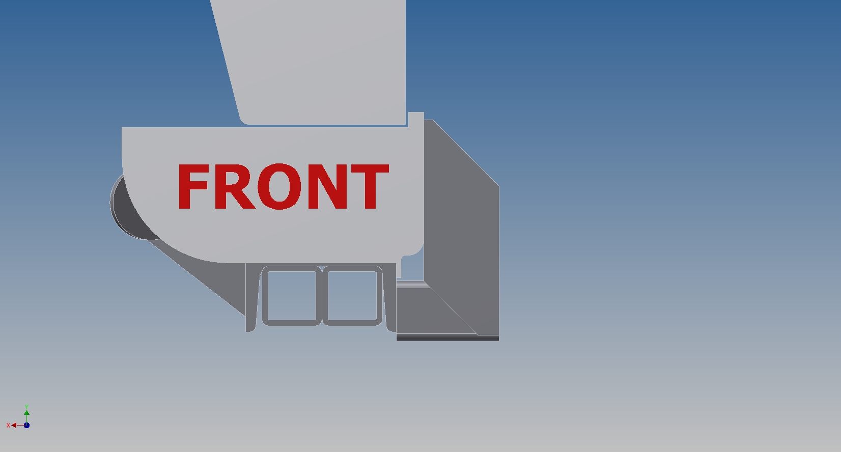

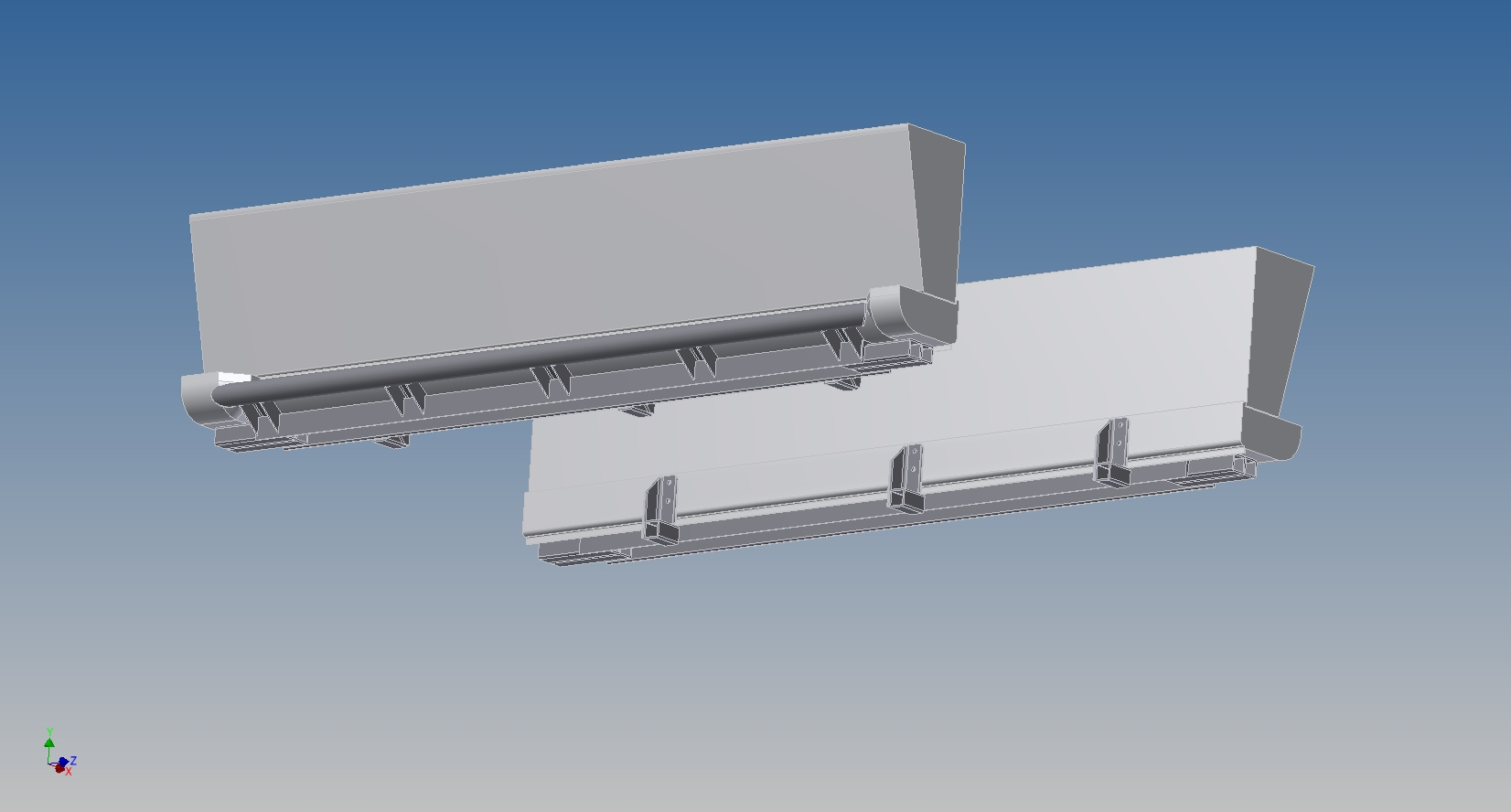

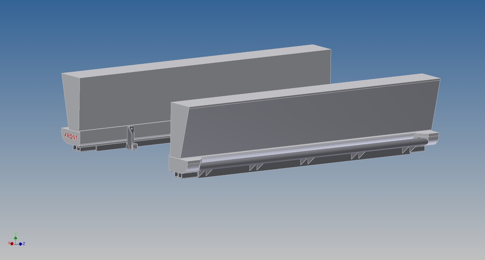

Re: Jack Points
Mark, I use the existing mounting points, but with firmer brackets:
This is the system used by the jeep guys, and I reckon nobody knows rock-crawling like they do...
However, the trick is here:
The rock slider "wedges" into the skirt joint where the inner and outer body panels meet. Thus any load from below gets fed into the body, but over a very wide area (to do this the slider itself must be very strong though), and not into the mounting bolts.This is the system used by the jeep guys, and I reckon nobody knows rock-crawling like they do...
