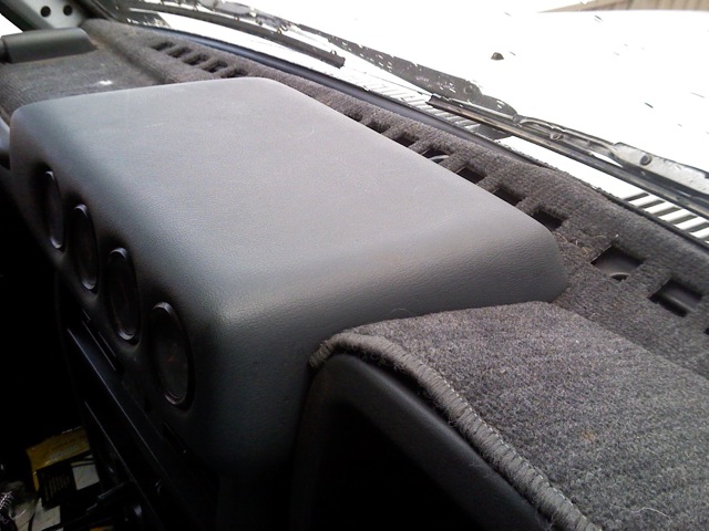

What this space.
I am busy making a box on top of the center console so I can move my radio up and fit the mad man gauge in as well.
gauges 003.jpg (21.05 KiB) Viewed 5436 times

Yip, that's where the GQ's have the advantage.... the dash is square so the console look good!!
Looking forward to seeing that my friend and the door panels !!

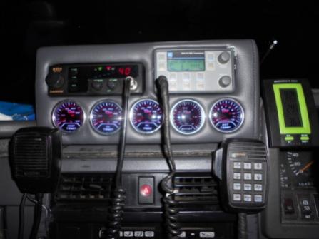

I know that car install places do pods all the time. I am looking to relocate the madman and oil pressure guage. They are currently mounted in the cubby above the radio.
If I can organise an a pillar pod would anyone be interested? They will first make a mound and the do Fiberglass impressions. If it has a flat section you could cut out the desired size holes.
