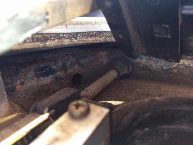

Re: sunroof on 4.8
I do have the same problem: after moderate rain water drops are leaking out of the switch/ light assembly in the ceiling.
When looking at the sunroof a bit more thoroughly I saw that it's frame is quite corroded on the front left edge. Do I guess correctly that I would have to remove the whole inside roof cover to get to that part?
I am about to order a new seal for the sunroof (130€, not good). Do you think, that should help?
