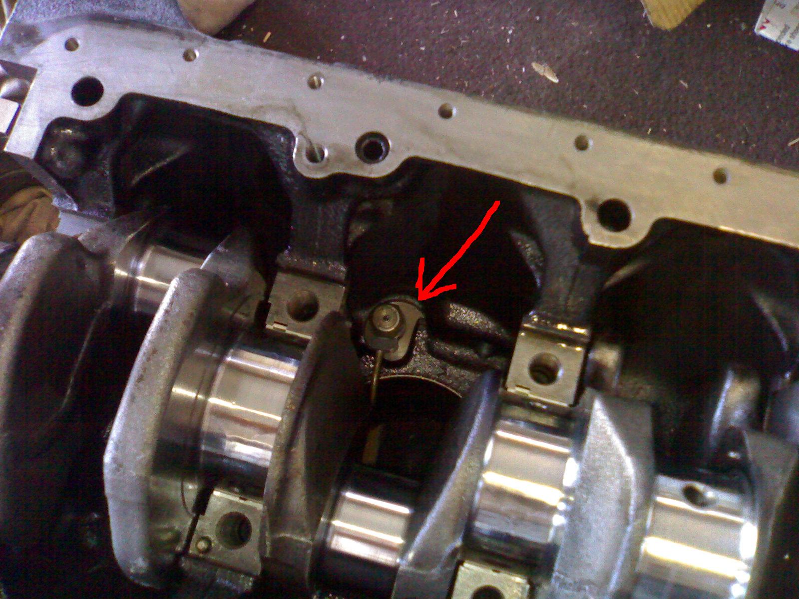

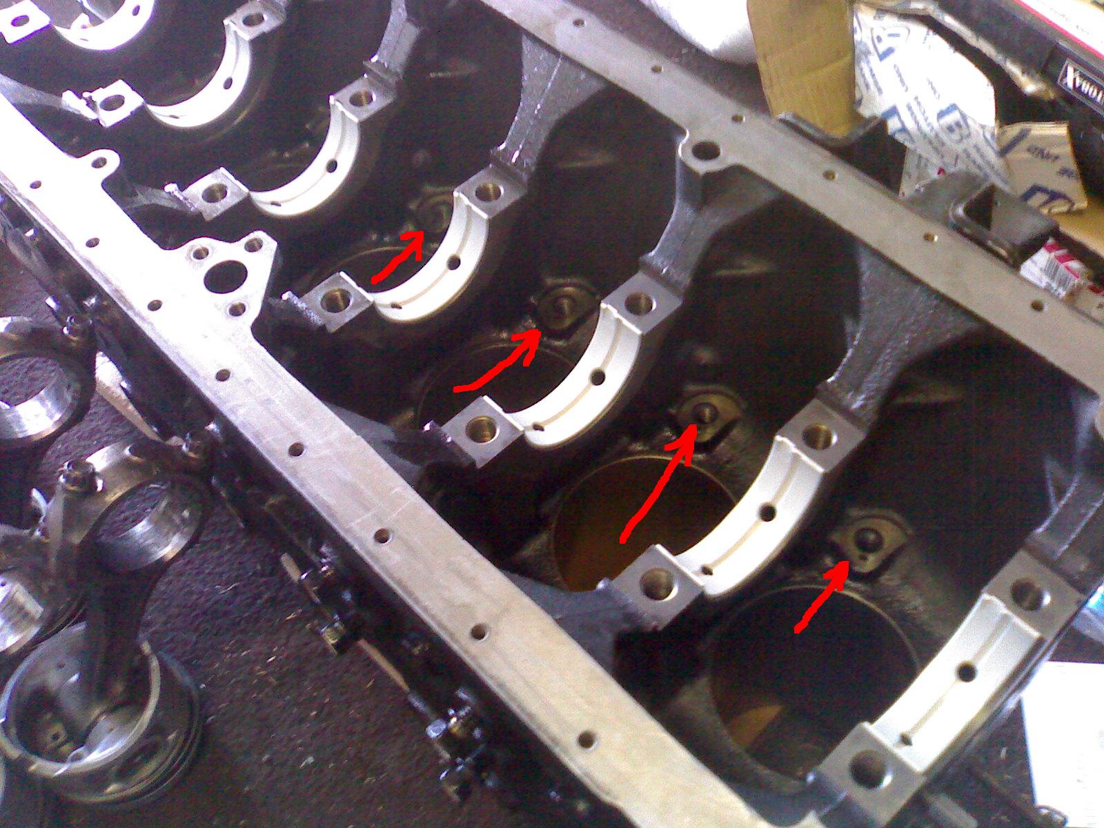

This might be incorrect, cause when I redid my motor ( 1999 TD42) I remember nearly forgetting to refit the squirter nozzles on the underside of the block to shoot oil on the underside of the pistons.
With the nozzle in place
Without the nozzle fitted

Yip.... as the ace of spades....
.... I'm pretty sure its the original block too. But hey, I may be wrong.... the registration papers don't say anything, and I've spoken to all the previous owners and they didn't mention anything.
